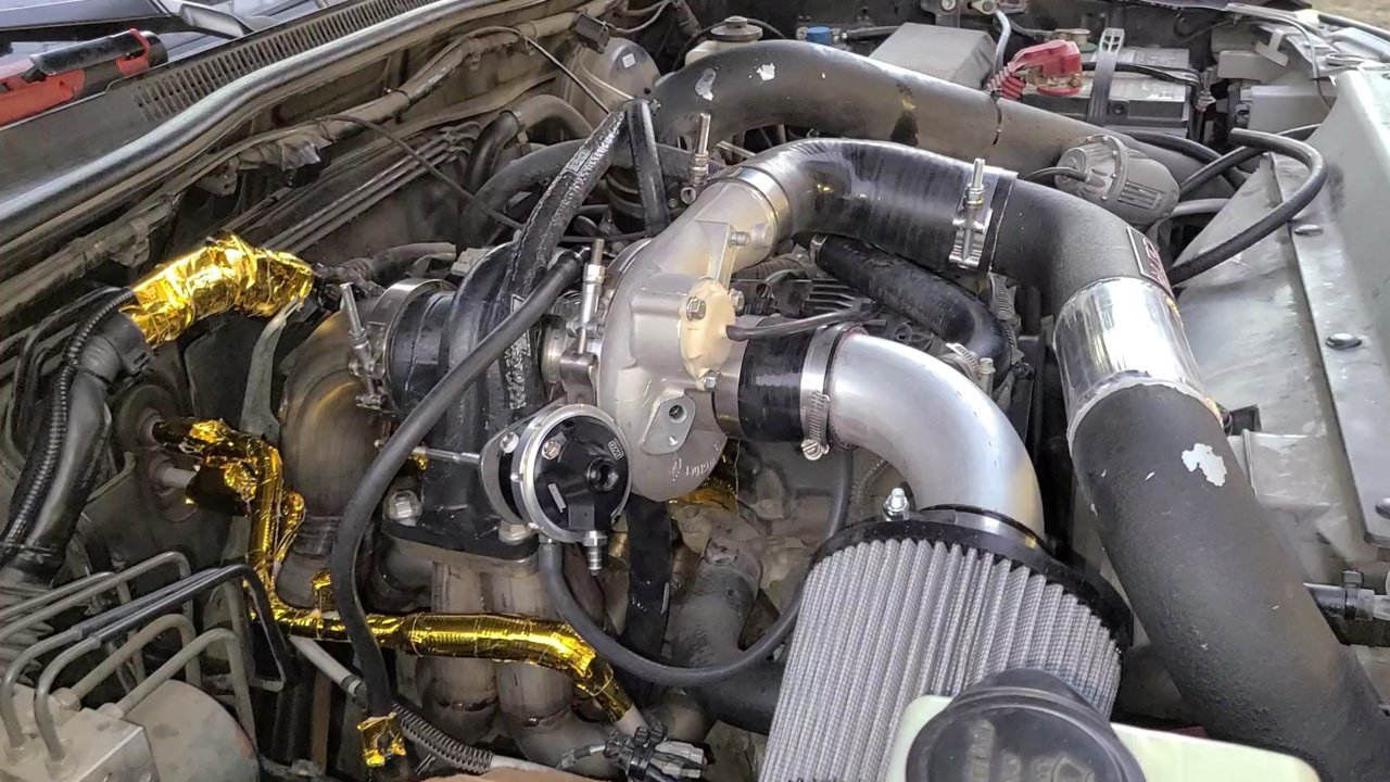

    In this photo, we had the vacuum routed to the incorrect port on the wastegate. It has since been changed to the front or top port.

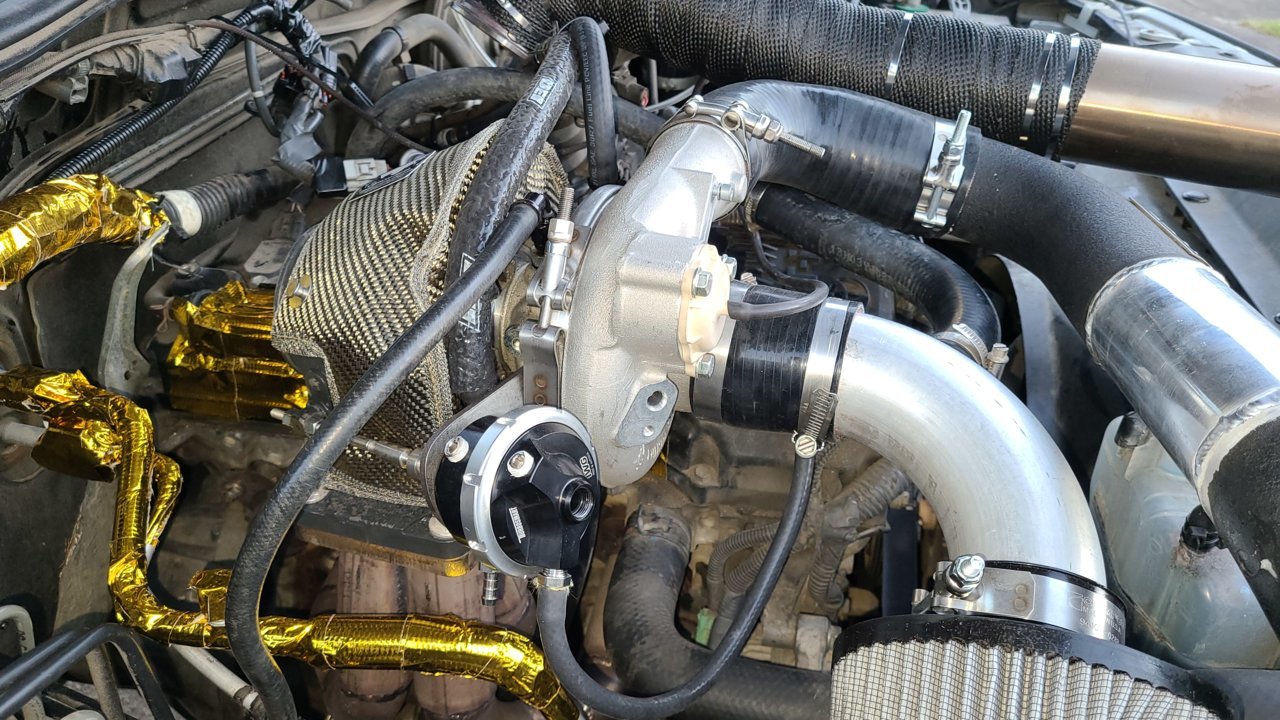

    Here is the correct routing. We added a turbo blanket, as well as wrapped the down-pipe with at least half overlap of 2" wide wrap. You can see part of it resting next to the intake coupling.
    These worm gear clamps weren't holding well. They were replaced with T-bolt clamps. The remaining few may be changed in the future.

    The turbine house came ceramic coating. Normally that stuff works very well. For some unknown reason this was already flaking off after a few test runs. The owner is going to contact them about that.

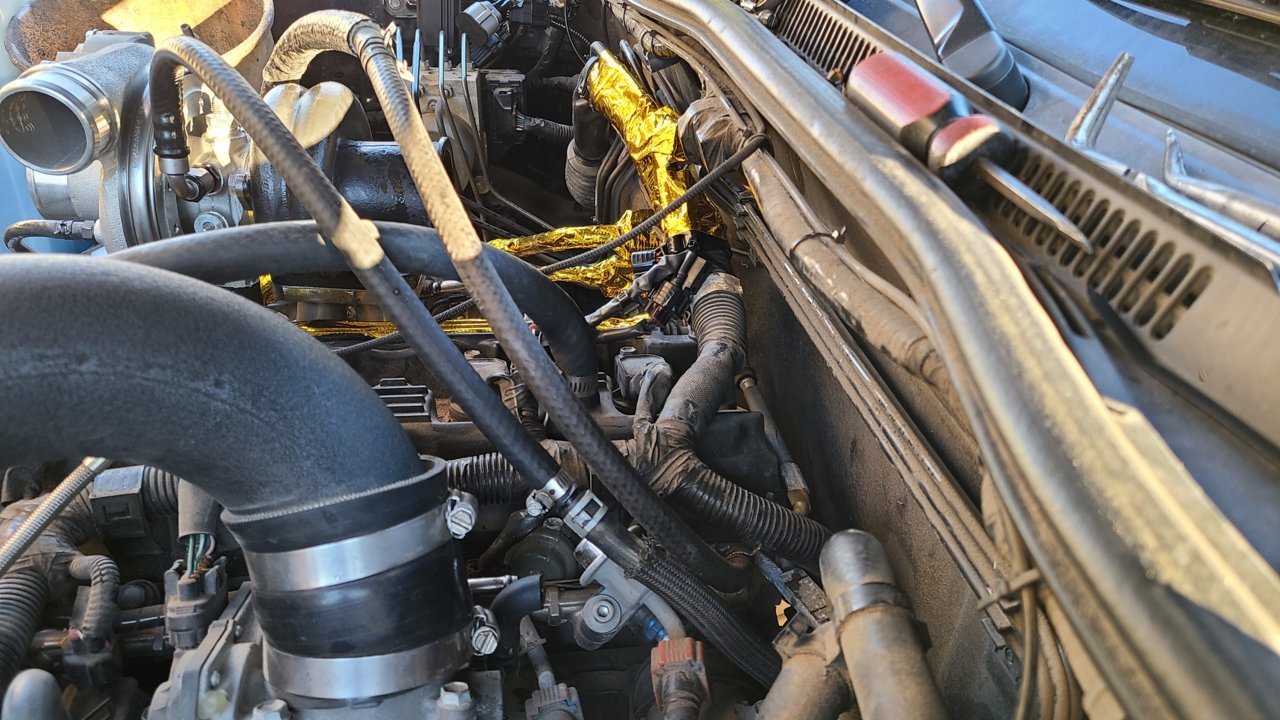

    I found that using heat sleeve on the water lines was crucial, after popping up 2 of them. I also got rid of the rubber coolant lines for some stainless braided ones, for even better heat resistance over the turbine housing.
    I do have my downpipe wrapped in DEI heat wrap, which also made a considerable difference in underhood temps. You can see the coolant lines going into the heat sleeve in this pic:
