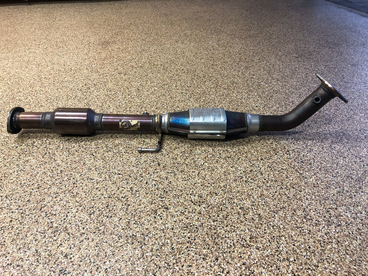

    I reached out to AFE about their 2.7 cat_pipe ( part #47-46002) and they said it's made with 2-1/2" piping (compared to stock being 2-1/4" I think) which should give better flow and add a couple hp. @taco_tallua has one in the fs section (picture from his thread).

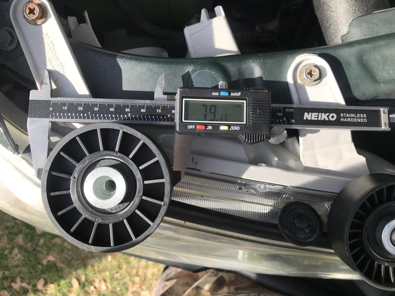

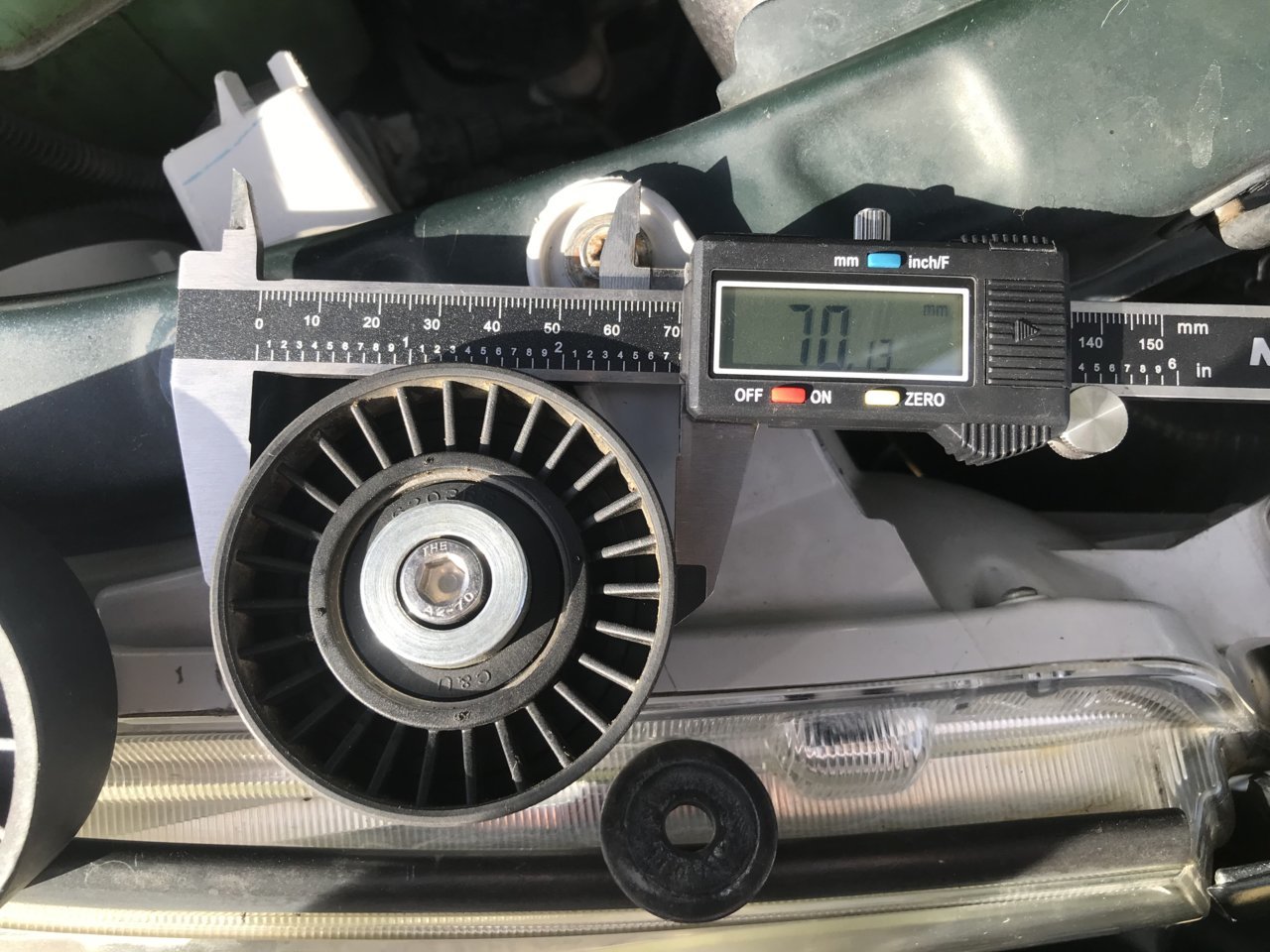

    Stage 1 vs stage 2 idler for the URD sc kit. Figured out for the belt routing to line up best, the passenger side s/c idler shouldn't have a washer behind it and the driver side one should (two came with the kit)

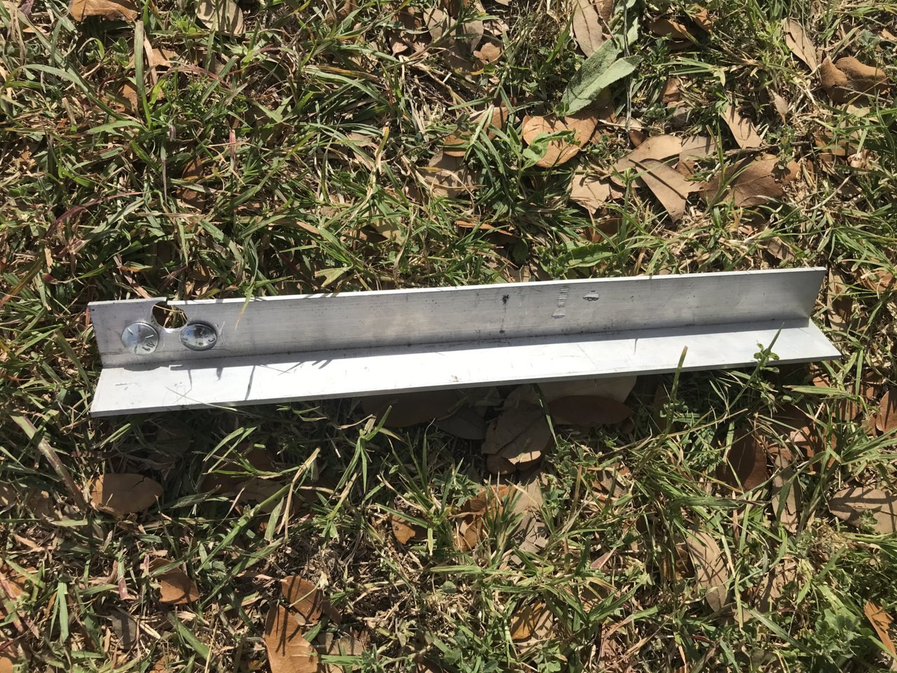

    destroyed the pulley removal tool i made trying to remove the old pulley. Guess aluminum wasnt the right material for the job. Tried using a strap wrench but the pulley keeps wanting to spin backwards. Someone cranked down this pulley bolt. Gonna have to locate a steel pulley removal tool
