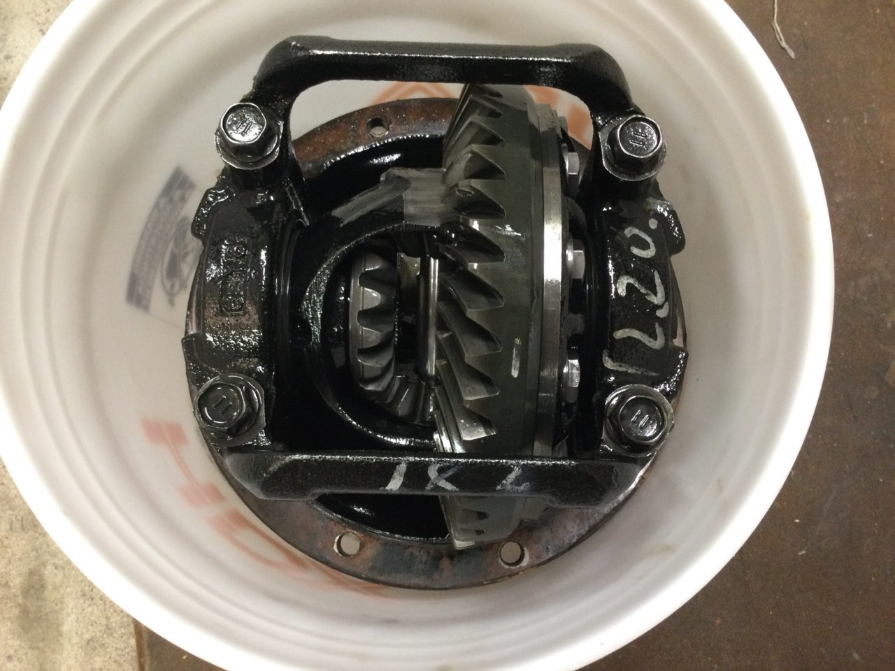

    Hayrider
    Hayrider Over the hill & going down fast...
    Jun 29, 2018
    #257836
    844
    Hey You…
    Convection Oven AZ
    15 DCSB & X-cab SOLD for more than new‼️ Now 05 & 07
    Reg Cabs, 5 lug, 5 spd, Magnuson & LS Swap, StopTech’s, Yada Yada Yada…
    All 05-15 Tacoma’s
    The 5 lug 4.0 XR manual 6 spd has 3.15 from the factory.
    The 5 lug 2.7 manual 5 spd has 3.31. “. “. “. (These two carriers/3rd members can not be re-geared)
    The 5 lug 2.7 auto has a 3.58
    The 6 lug 4.0 everything has a 3.73
    The 6 lug 2.7 everything has a 4.10
    Don’t know why the 5 lug 2.7 manual & auto have different gears and the 6 lugs 2.7 don’t? You would think they would?
    Here’s a photo of the the 8.4 (actually 8. 2.5”) This came in SOME 1st Gen Tacoma’s, 1st Gen Tundra & Sequoia, T-100 and all 2nd Gen Tacoma’s.
    Edit I have a 3.58 w/ 101k & 3.73 w/ 118k (I was told) for sale.
