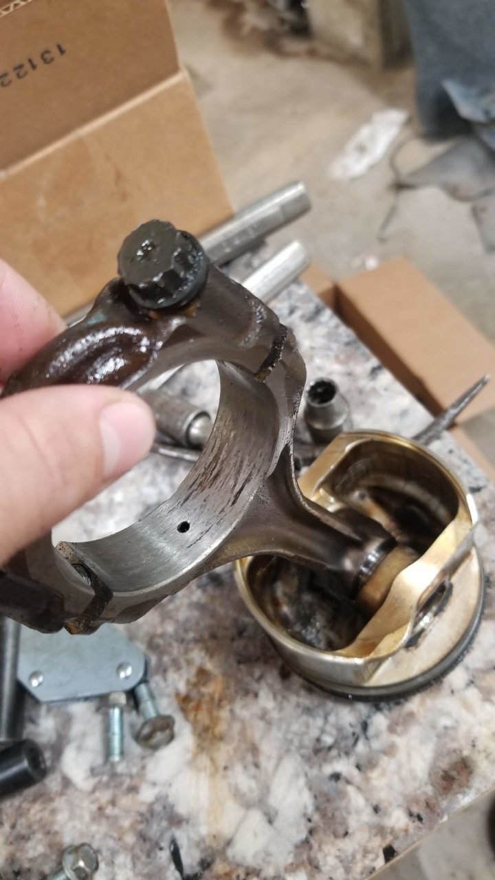

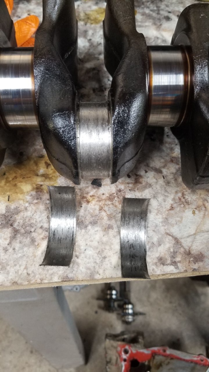

    I picked up a 2tr for dirt cheap for a turbo build. Tore it down and found out it spun a rod pretty bad to the point that I'm not sure the crank is salvageable/worth saving. Does the 3rz use the same crankshaft? I believe the bottom end is nearly identical between the 2tr and 3rz so I am wondering if a 3rz crank is the same.

    Really now?! Which rod, and have any pictures?
    You have to weigh the cost buying a new crank, or finding a shop that can repair it, and finding oversized bearings. Mahle makes oversized bearing though.

    Not really sure how. Guy I bought it from was just using the truck for the frame. Best guess is it was run out of oil because the cam journals had decent scoring on them as well (I already had a cylinder head decked that I was going to use). I think it was the third rod. One bearing was nearly completely underneath the other when I pulled it out. I'm currently talking with a few machine shops about my options. I already pulled the trigger on rods and pistons so I was really hoping I wouldn't need anything else.

    Hard to get a comprehensive assessment without looking at the rest of the engine, but your most likely right. That plus a lack of thorough maintenance.

    Yeah most likely. I think its too damaged to just grind down, so it sounds like the cost to have it welded up and ground versus buying a new crank is going to be pretty close.
