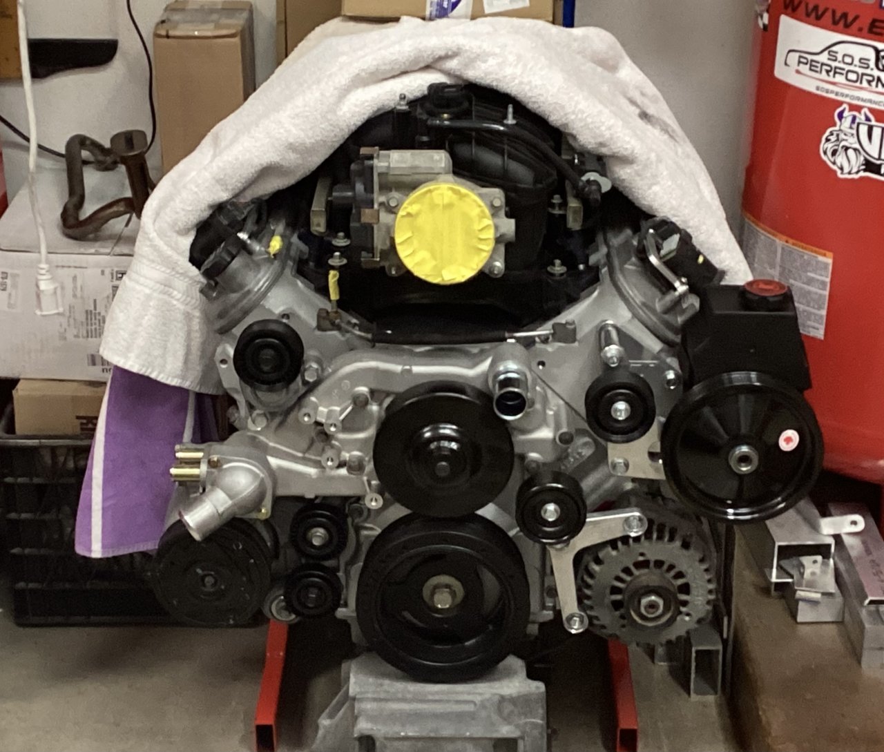

    Damn,
    Hoping someday soon I will have a complete 2nd gen up for sale soon with approx 35k miles. Just having a hard time finding someone who can or has the time to do the heart transplant to this…
    2006 5.3 aluminum L33 w/ updates & upgrades, O6 TBSS manifold, (supposedly the best OEM flowing cathedral port manifold) new 02 Camaro PS pump to relocate the Silverado 06 160 amp alternator and a 04 Vette AC compressor and harmonic balancer to move the accessories back 1.65” closer to the block for more room to mount a couple of small high volume (4000+ cfm) electric fans in a shroud to pull air through a drop in Mishimoto radiator. God i hope it’s enough to keep her cool…
