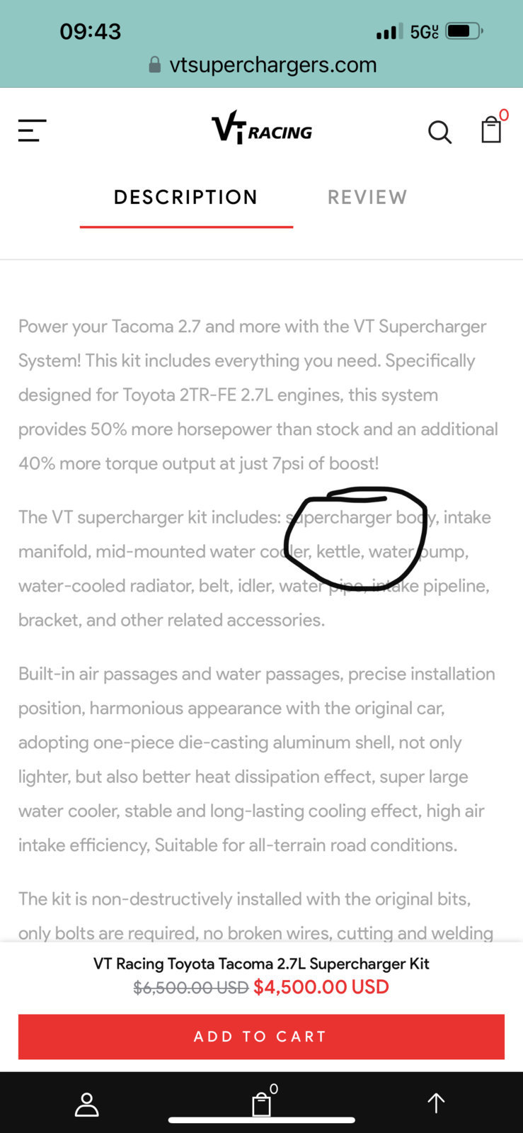

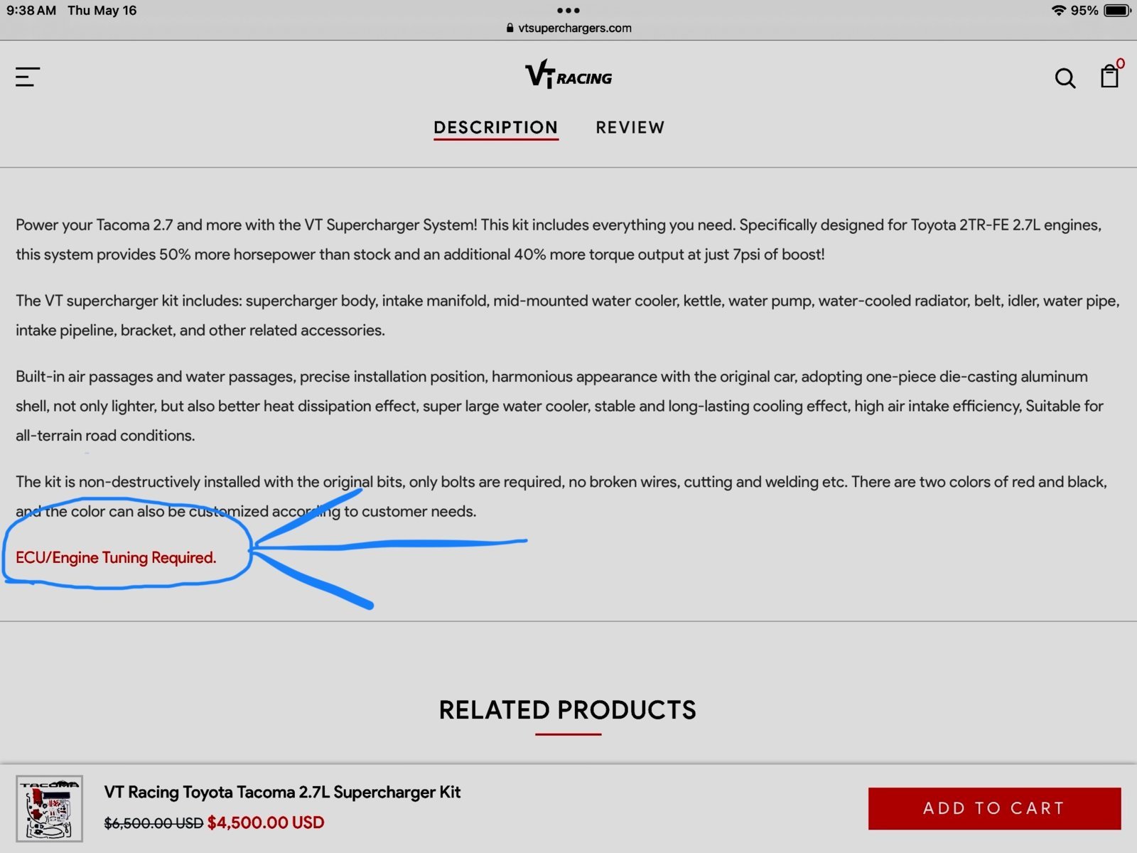

    looks like a nice kit, but it’d be a much easier sell if it included a tune to get you started

    On here it says it comes with tuning. It looks like a piggy back or something. Not sure if it would even work on a tacoma I dont know what kind of ecu toyota uses in other countries.

    Hmm that’s quite interesting. I would be super interested in hearing feedback from folks have installed this. I bet the torque is nice, these trucks are hurting for more tqs

    From the link you posted, it looks like this will work on the later 2016+ dual vvti 2TRs as well

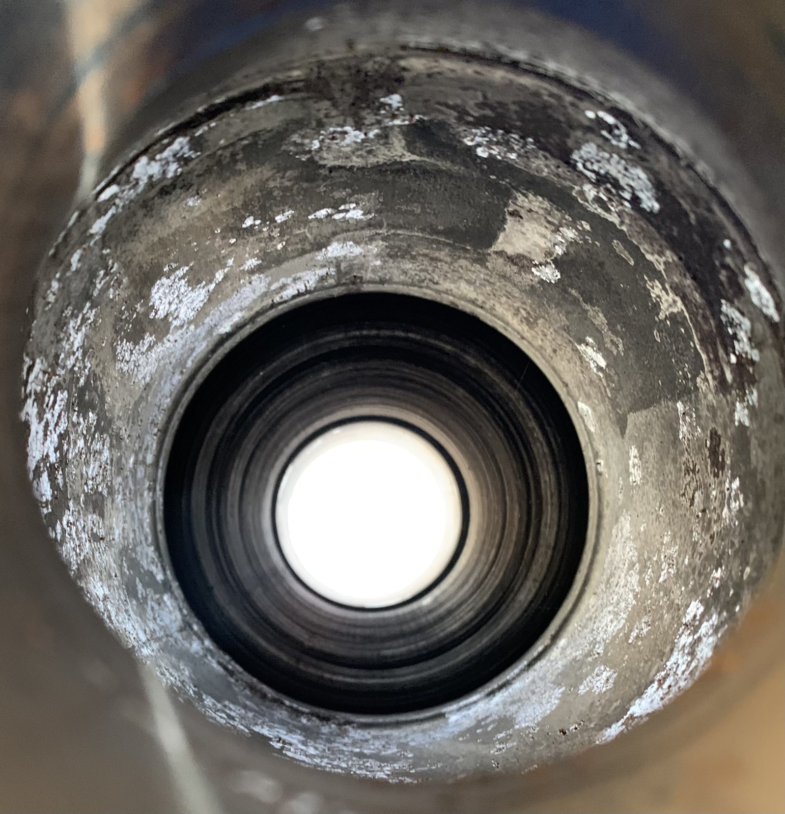

    Below is a picture of a OEM primary cat with 28 to 29k original miles after running a Magnuson Supercharger that was NOT tuned correctly. The system was then turned with Heltech.

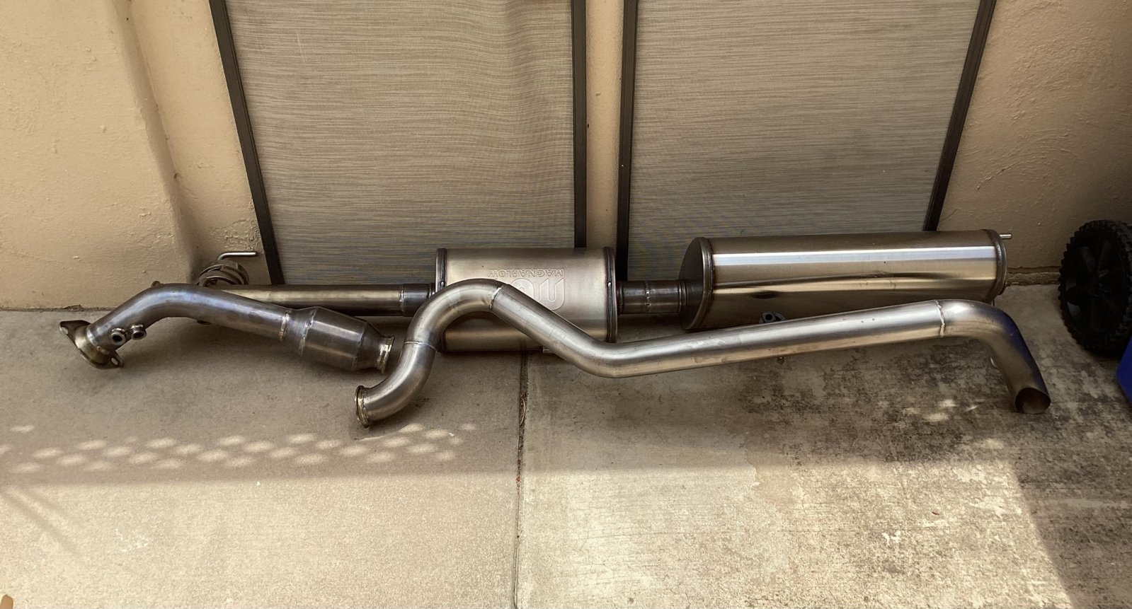

    Then I had a custom 2.5” 304 SS TiG butt welded. Using an expensive highflow cat that was purchased from PPE in Tempe AZ. Then into a 5x8x14 Magnaflow then directly into another 5x11x22 Magnaflow up and over the rear diff with a hidden turn down. The bottom picture is the exhaust system removed for the LS Swap.
    The exhaust system sounds perfect with just an LCE header on an otherwise stock 2TR. With the Magnuson it definitely needed a bigger front muffler / resonator‼️ If I added another supercharger I do a 5x8x18 or another 5x11x22 muffler. I’m running two 5x11x22 Magnaflow mufflers in a series (one in front of the other) on my LS swap!
