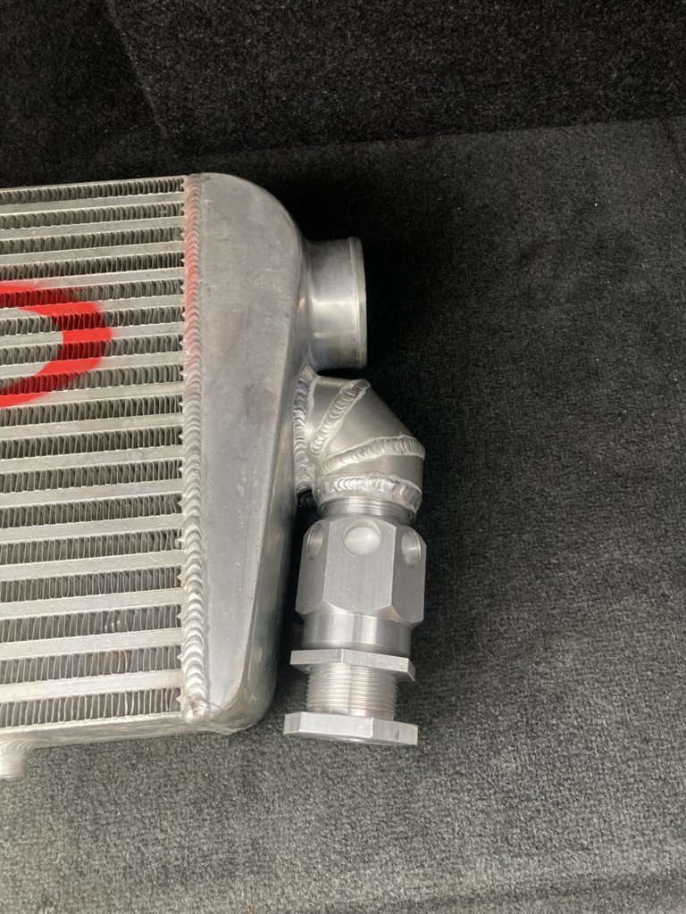

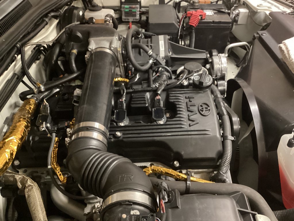

    heres some updates since the last stuff i posted years ago.
    928 motorsports manual boost limiter. Very simplistic item to eliminate any boost creep or even cap the supercharger, which is what i used it for. Ran a higher boost pulley and limited(vented) everything above 9psi to keep these rods in the block unlike the other ones.

    Mental note. The smaller valve by 928 motorsports would of been a better and easier valve to adjust. This one is wicked overkill and requires a massive wrench to adjust and lock down. But with this valve its pretty easy to get roots style boost and capping at 3-4psi if someone was looking for minimal forced intake.
    https://928motorsports.com/product/compact-boost-limiter-valve/

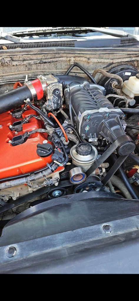

    I was talking to a guy who has the VT racing SC installed. He said that one comes with a piggyback. He claims he didnt have to get it tuned and has been running it for about 20k without any issues so far. Claims the kit is quality. He sent videos and pics. Seems legit. Just makes me a little nervous due to the country of origin being China. He said that they help but some stuff gets lost in translation. Wondering if i should go that route or wait for this to be sorted.

    Heres a pic guy sent. He sent several videos as well.

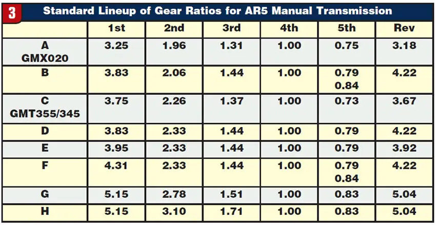

    @BassAckwards @Levalexi I agree, I think a close ratio trans is definitely a performance upgrade, An LS with too big of gaps (NV5500 -chevy) and high rpm cams still sucks when towing. Peak Performance is all dialed in the details.
    These are the ratios im coming up with for possible cross compatible trans combos.
    Id assume the almost guaranteed option is the R156F retaining the main and counter shaft with AX15/155F 2nd, AX15 5th for the best combo and spread. AX15 1st if it can be made to swap without machining. But hey we all know a machinist.. And if were at it lets go RA60F froma 2016 3.5 2gr :) low rpm cruise with 5.29s and 35s... yes please. No know info on that though. Only that its an R-series and possibly and option for internals, however the lengths of all 3 RA60/155/156 appear to measure identical lengths indicating high internal compatibility
    Gear R156F - RA60F - R154 - R155F - AX15 ------ R156F(Ax15 1st/2nd/5th)
    1st
    4.17 ------ 4.31 ---- 3.25 --- 4.31 ---- 3.83 ------- 3.83 (4.17- 155f)
    2nd 2.19 ----- 2.33 ---- 1.95 --- 2.33 ---- 2.33 ------- 2.33
    3rd 1.49 ----- 1.44 ---- 1.34 --- 1.44 ---- 1.44 ------- 1.49
    4th 1.19 ----- 1.00 ---- 1.00 ---1.00 ---- 1.00 -------- 1.19
    5th 1.00 ----- 0.83 ---- 0.75 --- 0.83 ---- 0.79 ------- 1.00
    6th 0.84 ----- 0.69 ---- N/A ---- N/A ----- N/A ------- 0.79
    Rvr 4.00 ----- 4.22 ---- 3.02 --- 4.22 ---- 4.22 ------- 4.00

    https://sites.google.com/view/vortec4200wiki/manual-trans-overview/gm-ma5-aisin-ar5
    The AR5 is the same transmission too. I'm not sure where the gear ratios come from in the 2nd picture. But the 1st picture is shows where they're from. This might be of some use to you.
    There are a ton of people who run those in drift cars, and there's a bunch of forum information as well. They're supposedly pretty stout. Issues with 3rd gear synchros in a lot of reports. Some people have crossed parts from other transmissions and made them work.
    Definitely a rabbit hole worth following possibly.
