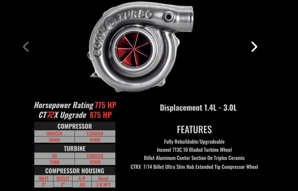

    Well have some more experience to share with 2TR turbo sizing with my adventure, Ordered a comp CT3RX-5862 .82AR dual V-band mount today. I was going to go smaller but they assured me this would spool way quicker with my setup than expected especially with the CTRX wheel upgrade and ball bearings option. worse case we can assist the spool with the meth injection on the CNC manifold with the appropriate provisions for individual runner injection. The rep was leaning into a 6262 until i specified my exact usage which requires both top&bottom end with quick spool, he assured me i could make 500hp with almost instant bottom end boost with the 5858 but the efficiency would suffer along with reliability due to heat retention even with a larger .82 AR, so 5862 it is. SAFE IS FUN. Id rather rip than be watching EGT the whole time. Let the Haltech be the appropriate safety net is my thoughts Screenshot 2025-02-06 at 4.24.20 PM.png

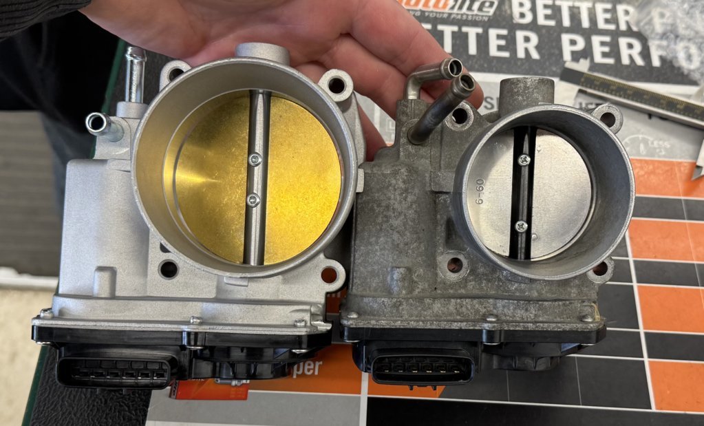

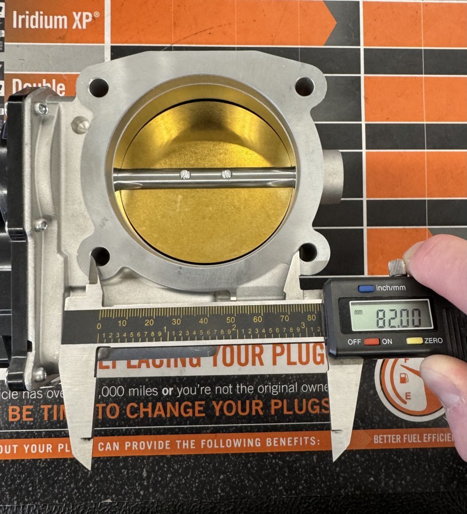

    While we are at it im finding all kinds of conflicting information on throttle body sizing.. Im leaning toward a OEM Toyota 70mm from a camry or a 75mm from a 5.3LS. Any input on appropriate sizing? i know some 2jz and RB stuff isnt even that big. Thus the confusion. I want to make sure to ship the second throttle body adapter with my intake to avoid more ridiculous shipping from malaysia later.

    Full-time AWD & BorgWarner EFR 6258
    70mm from 10-24 4runner or 76mm from the 5.7L tundra would be plug and play with your TB harness. Just need the proper adapter for your manifold

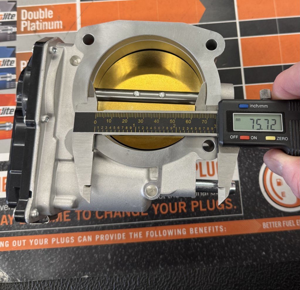

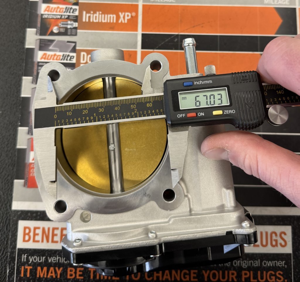

    Tundra Throttle body pics just for reference
    2007+ Tundra 5.7L
    75mm flapbore
    76mm mounting bore
    Bolt pattern - 82mm x 67mm
    Plug and play with appropriate manifold
    Just sent the specs to CNC innovations to send it out with the order. $61 additional per extra plate.
    this way we can get some real world “what the hell difference will it make” verification. 60mm to 76mm should yield a noticeable change in response and feel to see if its worth a damn on/off the dyno.

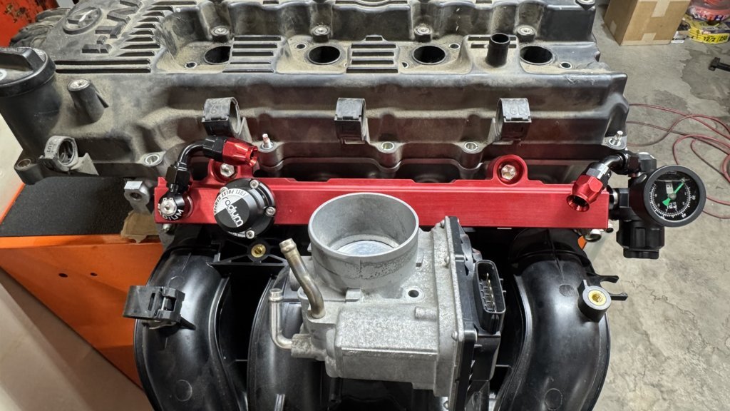

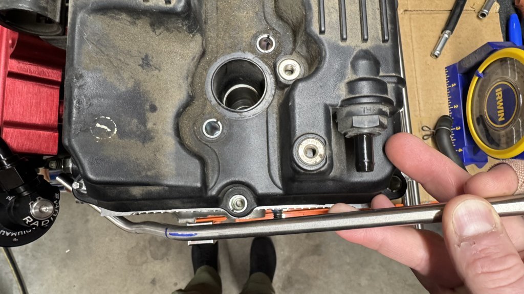

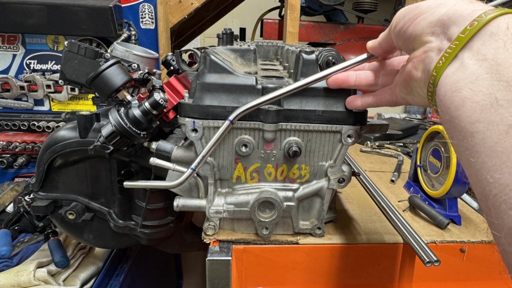

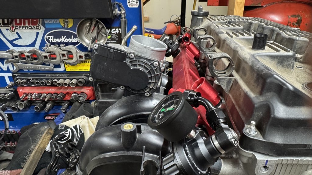

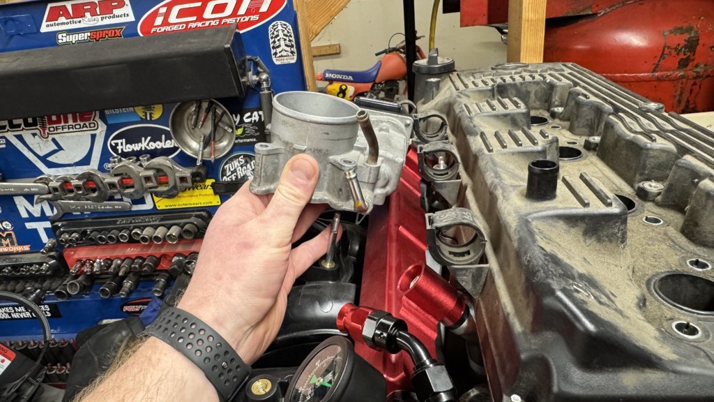

    Lots of prep to get ready for 1300cc injectors or staged injection pending how it feels at low rpms off road. This round will only be with 380cc Five0motorsports injectors(may be stage 1 in the CNCinnovations runners later) on the Rotrex to see how an unaltered OEM map likes the increased flow. I have found that without tuning my base WOT map is fixed at 4.7% positive trim which cant be perfectly countered with a 5th injector. This should fix that. Hopefully it will allow people who dont want to mess with Orange Virus tuning to be able to plug an play a close map. If 380cc isnt the magic ticket i assume 315cc might and both are offered by Five0
    This will be valuable to anyone looking to use the larger fuel rail while still on a stock intake manifold setup, I wont be later but for now this will be good info for those that want to stay stock but want fancy bling like we all do. The stock location of the 60mm throttle body does indeed interfere with the very nice fuel rail(05Taco4x4) unless... you have a manifold spacer. I do not, so im going to clock the throttle body 180 degrees which may not be advisable as a permanent fix due to the way it will affect tip in flow and the way the stock manifold creates the intake vortex. but this is indeed temporary for my setup at least. Itll require pulling the sheathing off the factory harness and pulling the throttle body wires out of the harness to the back side of the throttle housing and re-securing the wires in the harness(no cutting) effectively lengthening the wires enough to plug in at the new location.
    The stock PCV and throttle body coolant hard lines also do not fit as the connections of the fuel rail will intersect grossly. Not a big deal though if you know its coming. Ive mocked up some stainless lines to reroute the PCV hardline to the stock manifold avoiding the fuel pressure regulator as the stock plastic manifold uses a non sealable port that requires the PCV line to plug it. The coolant lines for the throttle body can be easily rerouted using high quality 5/16" coolant overflow hose from a local hardware store.
    Moments like this is why i remember having a hard time throwing away the original head from the grenaded engine. Epic to have a exact mockup for fitment without leaning over into the engine bay

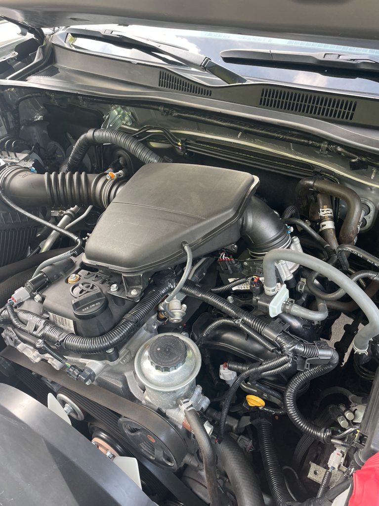

    Install is finished. Had it checked out by a Toyota mechanic who knows superchargers, said no codes and everything seems to be running. Haven't pushed it too hard yet but makes driving a bit more fun at Denver elevation.
    Thanks to @BassAckwards for some help and URD and for making a great product.
