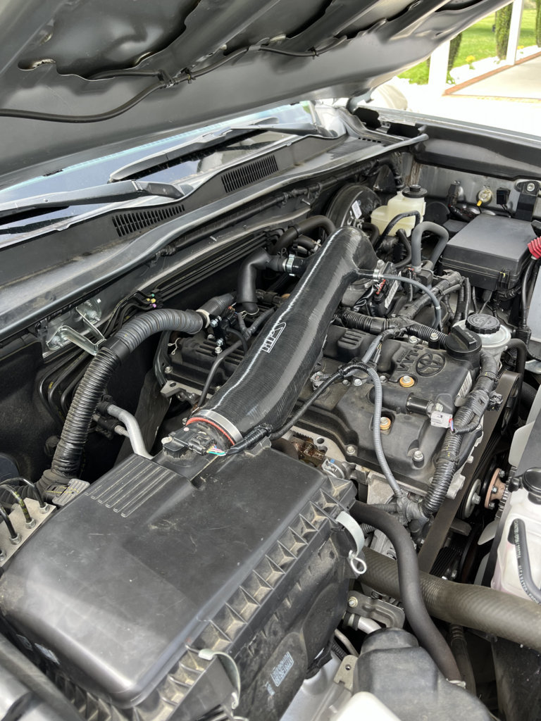

    Added a hps intake pipe, think it pairs well with my other mods, header, intake manifold spacer, charcoal filter delete, fender elbow delete. Has a nice but not obnoxious intake noise, feels like a few hp got let out of the stable and mpg is up a tick up as a bonus.

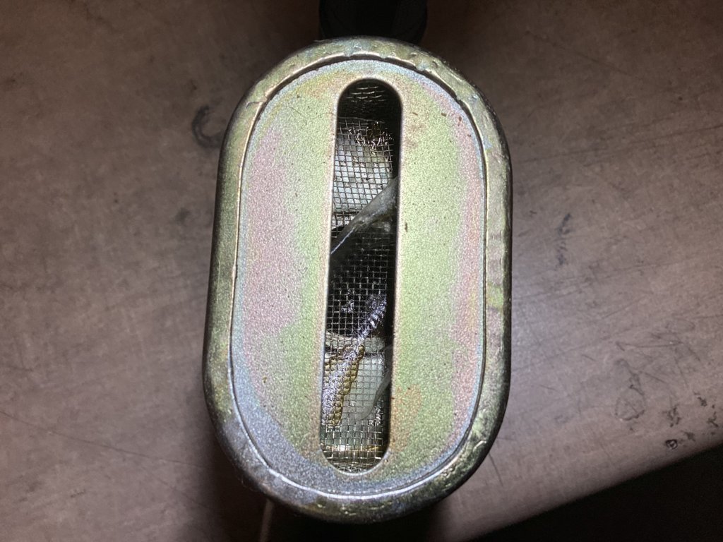

    I don’t know if the 3rd Gen. has a cotton air filter. But if they do, this is what I have been doing for years.
    Get two factory air filters, then every time I change the oil I change the air filter. I then take a large spray bottle fill it about a third full of liquid laundry soap and the rest water. Spray and soak the air filter with the mix let it set for a while then take a garden hose and rinse out the filter from the opposite direction of the airflow. I hang the filter on a wire coat hanger to let it dry. When it’s dry back in the box to save for the next oil change.

    I was very surprised it added a nice stockish improved tone which i was hesitant. I did not want to hear a loud intake everyday and lets face it you need to work these engines to get going so a loud intake would get old quick. Since i have a tooter style manifold spacer i had to install the pipe with the box uncliped and yank it over and latch it. Going to get a spacer and a few extra clamps, my hope was with a little driving under tension with the heat of the engine bay it would slightly stretch to its longer shape. I currently have a afe filter but was thinking of going back to just factory filter nice tip

    Yes! Definitely go back to the original / stock air filter as they are far superior for filtration!

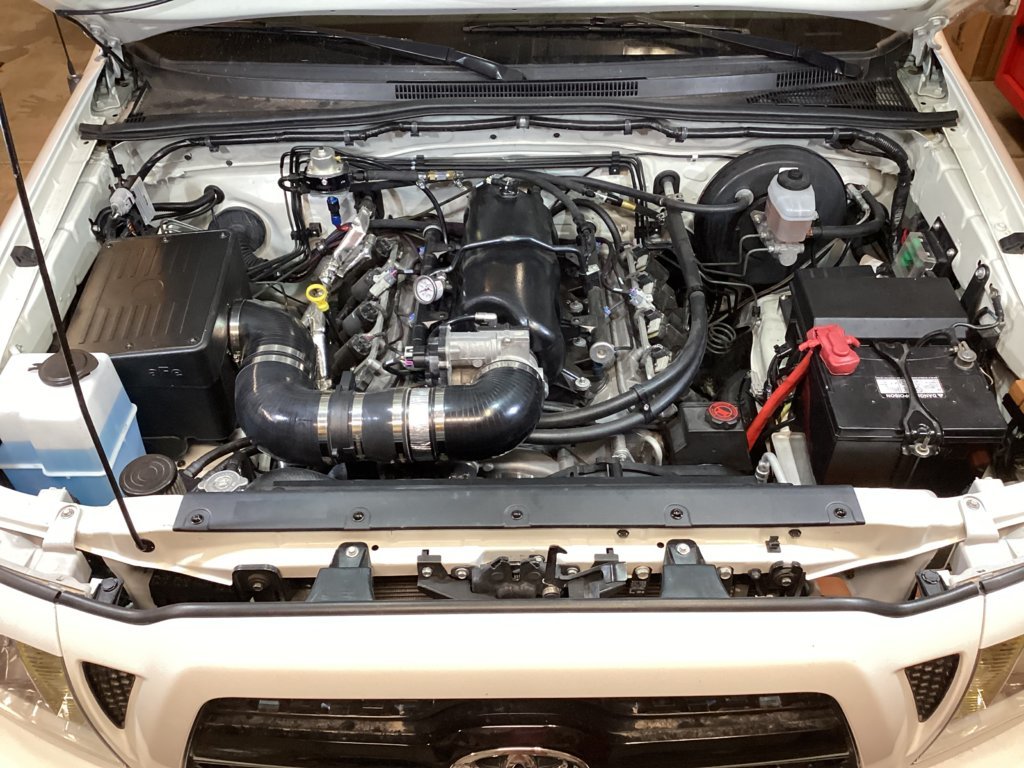

    On my 05 with the Magnuson supercharger I have a mandrel bent 304 TiG welded custom made system with a high flow cat a 5x8x14 (I should have used a 18”) and another 5x11x22 Magnaflow with a 2.5” hidden turn down at the far right corner of the bed. It was perfect until the supercharger, now I have drone.
    And Yes I’m the Guinea pig for the newest Magnuson supercharger kit for a 2TR-FE.
    Apparently Magnuson redesigned their supercharger to be more efficient and of course raised the price.
    Boomslang sent the wrong harness for the Heltech elite 1500. So very little works on the track but the SpeedO brakes, stereo, alarm, lights and AC. The factory ECU is completely bypassed! Grrr…

    I was asked what gas is in the tank? I told LCE “I topped off the tank in Phoenix this morning on the drive over”.
    But here’s a secret it’s 87. Why, because I already have an LS swapped play toy and this 05 is my daily driver so I could care less about the power!! Premium here in the Phoenix area is a minimum of .60 to .99 cents more per gallon @ most stations are just over .75 cents per gallon. Plus the Snow water meth system was and is not working!!
    Last time this system put out 222WHP on 91 and at approx. 9 lbs of boost.
    I installed the snow water meth system but I pretty sure I have two wires crossed because the system is not working. I also didn’t have time to install the door panels, the 3.58 gear w/ the TrueTrec for the 28.8” rubber or suspension as in front coil overs and some 2” rear lowering blocks. Yes I’m gone the opposite direction of 99% of the members here, my 4x4 days are behind me…
    My wife finally retired and hopefully we might be moving to Prescott, AZ. or Bentonville, AR. so we can get out of this convection oven heat and I can enjoy riding my MTB’s again.

    As suspected I had two wires crossed for a boost gauge on the Snow 2.5 system that operates the Snow water meth system. After making sure the Nozzle was spraying mixture I pulled the plug and installed the nozzle. Then adjusted the gauge to start spraying @ 1 psi and full volume at 8 psi. I went for a little test drive. I didn’t see more than 5 lbs of boost. Now know I absolutely was not happy whatsoever with this system and actually hated it. I asked LCE GM to please find someone else as my Daily Driver was just fine for my needs. But they insisted they wanted me as I would report issues, ideas and concerns but I also would give them the positive things I liked.
    Now I have ABSOLUTELY NO IDEA IF THIS IS PLACEBO or real butt Dyno working. But the power is now there‼️ Again I don’t know how injecting a little water and meth would make this much difference but I swear it does. But again it could be 99% placebo w/ 1% actual HP. All I know is now I’m pretty happy with the system. It sometimes still stumbles just after the gear shift when shifting like an old man.
    I’m still waiting for the new Boomslang harness so my dash gauges & cruise works. I drive with my fingers every time I can.
