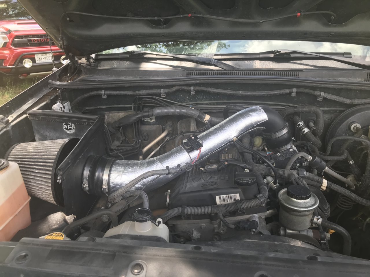

    I'm looking to run the setup you had originally with 4.88, LCE headers, and drop in AFE filter, only I will have 31.6" tires on a 3rd gen auto. In your opinion, if I was to go with this setup and add the URD SC to make a well rounded truck, versatile and capable of efficiency and power. Do you think I'm on the right track?I realize you decided to go a little more extreme, but in your opinion do you think I will be happy with my truck that way as a daily driver, coming from your experience with it being similar at one time?

    I think you'll be very happy with that setup, even without the SC. 4.88s really make a big difference on these 4 bangers! I will say the URD sc helps a lot for daily driving. The blower really wakes up above 3k rpms but even below that, i noticed a big improvement in drivability
