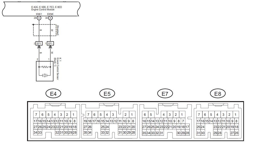

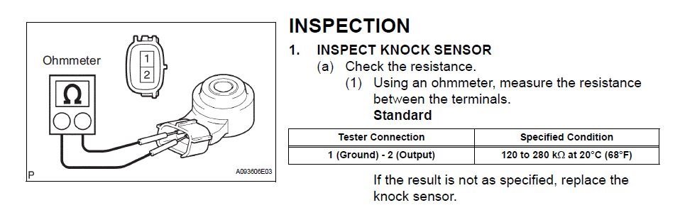

    If your ECM pinout looks like this, then take the resistance across pins E4-29 & E4-30 and there won't be a need to remove that dang intake.
    This is for 2005-09, maybe is same for 2009? If not, get that manual and same idea applies.
