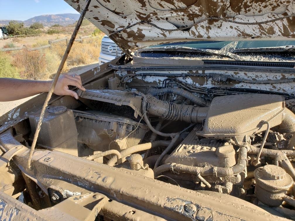

    Nah, I change my oil with the factory weighted synthetic oil every 5K miles and yes, I've rev this motor out pretty hard on my way to vegas on the 15 plenty of times...shit went down when I removed by fender liners to accommodate the tires and went into a mud pit much deeper than I anticipated.... the stock snorkel system became a massive straw and took in the mud all the way past my throttle body.
    Needless to say, I must have blown my valve seals or burnt my valves with debris on top of frying my bearings - since I only have 130ish psi compression in the cylinders and it now ticks. I haven't done a leak down but at this point... don't really care about that...
    Here's what happened at the mud pit....

    Ru Roh! Looks like you fucked it good.

    Looking at the picture you are lucky that it is even running at all.

    Ever heard of motor hydrolock?

    Yeah, I call it being lucky!!! When I went through, I had the CEL and the motor was stumbling, barely keeping idle. Once I opened the hood, it was like...WTF... took care of the CEL by cleaning the MAFS with water and a pick to get all the pebbles out and got it towed. Once at my shop, flushed the oil 4 times - in doing so, found silt contaminated in the oil. In between the oil changes, I was experiencing the low oil pressure light upon the engine stumbling.
    Fast forward to now... changed the plugs, 2 more oil changes now, new air filter, cleaned the MAFS with the PROPER cleaner - and BAM, excellent idle and still runs! Yeah, the truck doesn't pull anymore from 3500 RPM but the 35s and the armored bumpers don't help either. I was planning on driving this until the engine creates a window...

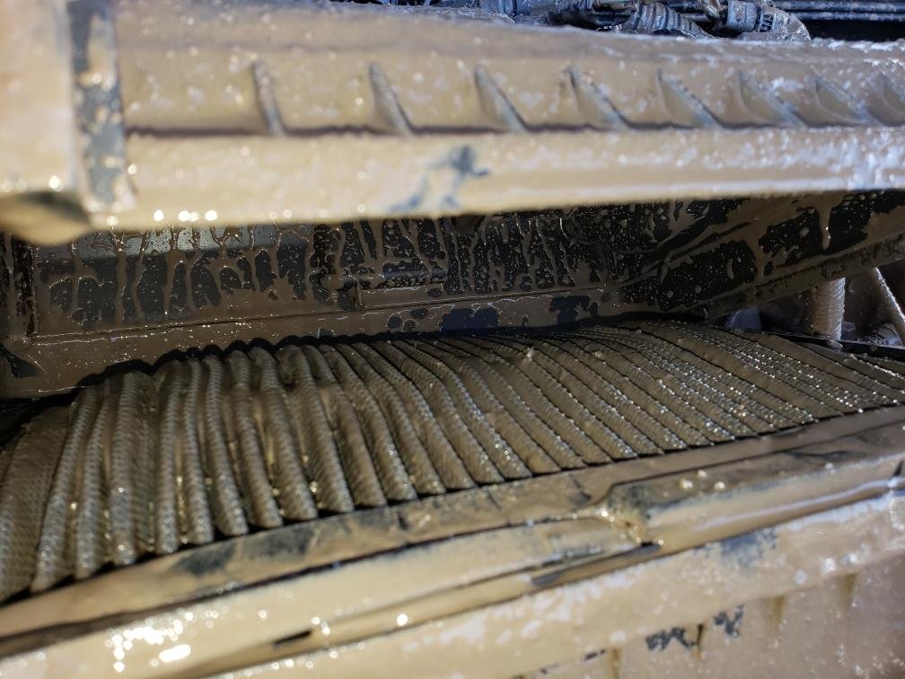

    A better shot - just shows how tough the 2TR-FE is all about!!!!!!!!
