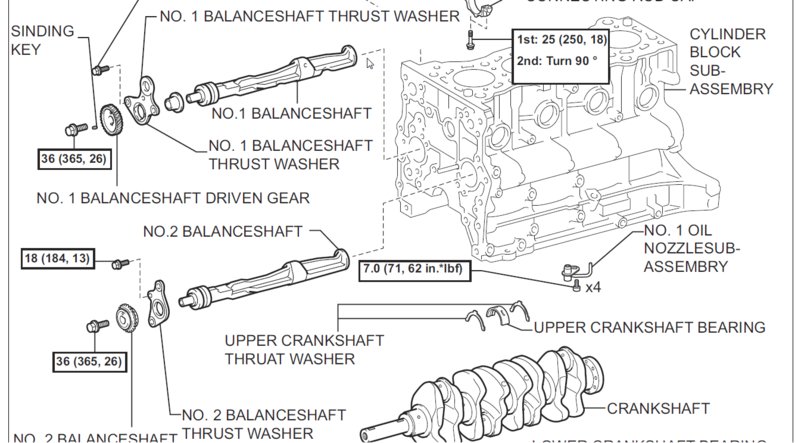

    So I'm going to pull the motor this Saturday. Looks like some bluing on the balancing shaft. I'm thinking that's what's seized. Fingers crossed that can all be fixed without having to do a complete rebuild. :fingerscrossed:

    Thanks. Just looking it looks like there is some bluing in the balancing shaft so that could be what's seized. Like I said pulling it out Saturday and going to start tearing it apart to find the problem. ​

    You probably seized a bearing on the crank shaft if that what you are referring to as "balancing shaft"
    I did that on my car, most likely will require a new crank shaft, and replacement of the rods, if you seized the bearings, the rods got hot and probably egged. They machine crank shafts to the engine, its hit or miss if you will have engine problems in the future if you go with replacing that. The replacement shaft isnt worn into that engine, itll be worn into some other engine you took it out of. Problem free future fix, new engine. Post pics of that you say got discolored and we can help mas.

    Balancing shaft is something different. It is not the crank shaft.
    https://en.wikipedia.org/wiki/Balance_shaft

    2AZ has balancing shafts as well. Notorious for spinning their bearings. However. Just worked on a 2RZ engine making a strange noise. Spun the bearings in one of the counter balance shafts. Did not seize the engine.
    Cranks in these engines aren't machined specifically to the block. Cam bearing caps are with their head.
    Various bearing sizes can be purchased to achieve the proper clearances between crank journals and main caps, as well as rod to rod journals.
