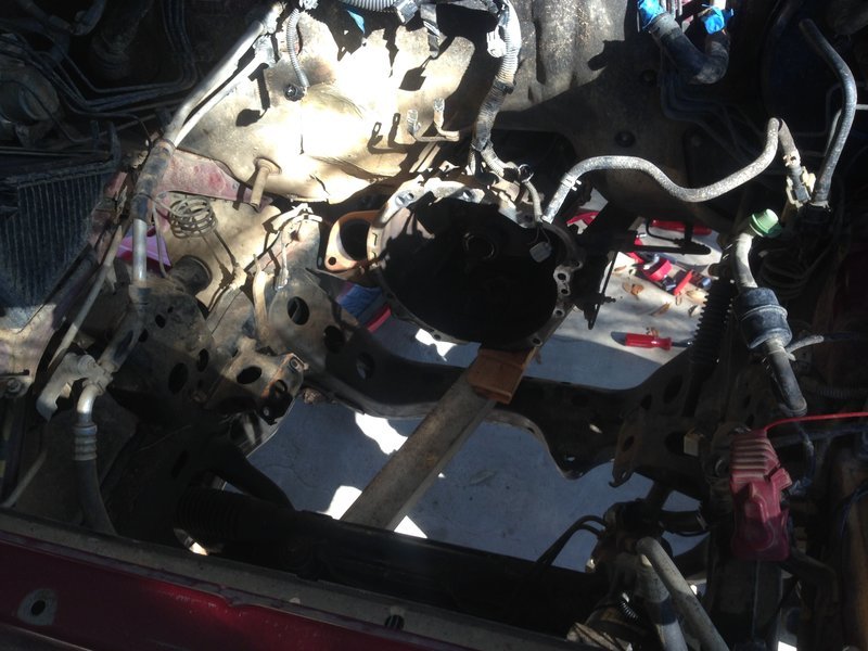

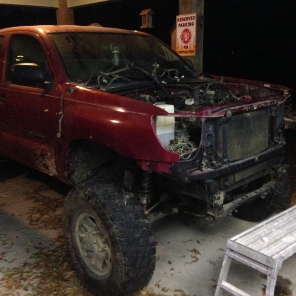

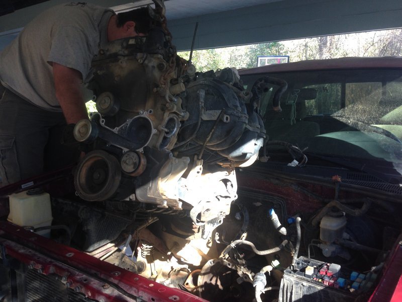

    image.jpgReady for progress to begin.

  11. Feb 27, 2016 at 6:57 AM
    #51
    Jimmyh
    Jimmyh Well-Known Member
    May 16, 2012
    #78991
    14,292
    SC
    2012 Prerunner SR5
    Marked for Pics.

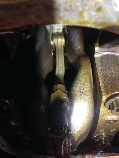

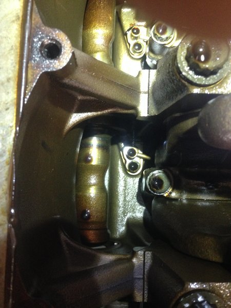

    Looking at s bent rod and potentially seized balancing shaft

    Bent is potentially better than breaking. Might have more salvageable an engine than expected.

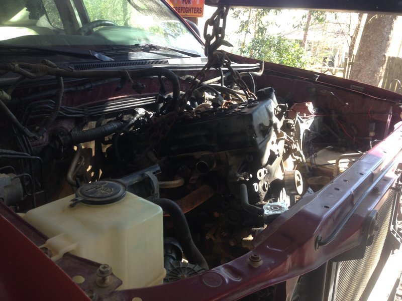

    You'll need to pull the head. :thumbsup:

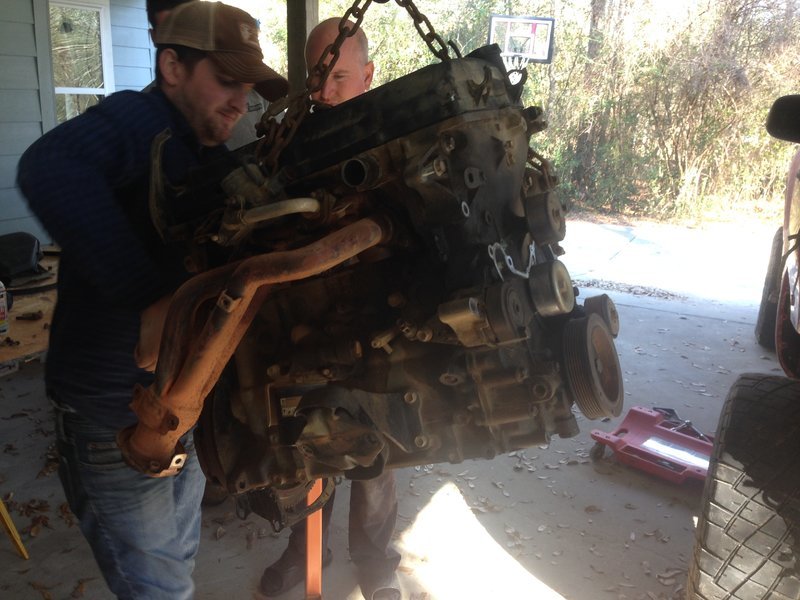

    Now that is progress.
