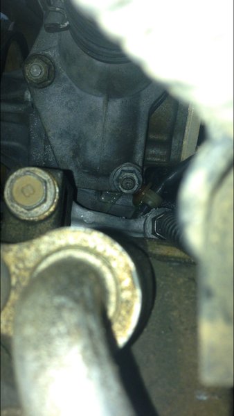

    Post a picture or video of where it is leaking please.

    Good info about the relay. I'm not very inclinded on the electrical stuff. I will have to look on that. Used a brand new gasket that came with the rebuild kit. With try to post a picture/video in a second

    Video won't upload. Here is before I added coolant and then after. You can kind of see it coming out by that bottom right nut

    Pinched gasket perhaps?

    Over torqued it? Still don't know why it won't fire unless the timing is off.
