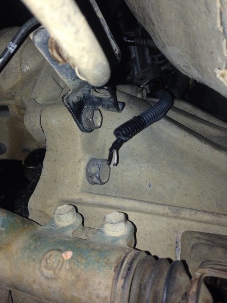

    From what I can tell it is behind the intake so it's no big deal to pull the intake off and check it. The reason I didn't consider it being the issue was I figured it threw that code on initial start up when it was fighting to start. Once it popped again I realized that's what the issue is. I believe a bad reading from the knock sensor sends the ECU into "safe mode"

    image.jpg Found this gem

    Man. You have a lot of gremlins. Were you guys rushing during the engine pull?
    Are those wires for the knock sensor, or something else? Either way, that is definitely a gem. Lol.

    They are for the knock sensor. Crazy thing is I looked at the sensor and the wires looked secure. And in fact I know the plug was unplugged. However when I pulled on the wire I can with no resistance. No clue how that happened but I'm just glad to find it.

    Looks like they pulled out of the plug. Shouldn't be too difficult a fix. I bet it will be running like new once you have that fixed.
