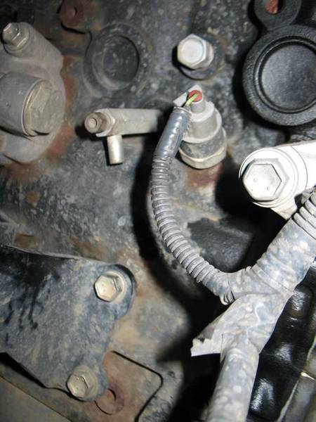

    Hi Folks,
    This is my first post but I've been using this site as a great resource of info for the past year since I bought my Taco. Thanks everyone for all the guidance so far.
    I've done a bunch of searching but can't seem to find a straight answer on this one. I'm at almost 100k Miles and I want to do a coolant flush.
    Can some one please confirm exactly where the coolant drain plug is on the engine? Is it the large bolt right in the middle of this photo? The diagram in the OEM Repair Manual doesn't seem to make sense.
    Many thanks in advance for the help!
    Cheers,
    Z

    NO that is not the coolant drain on the engine block.
    To drain the coolant from the block and radiator like the fsm says, you will need to open the drain on the radiator and the one on the block. The one on the radiator is on the driver's side and is pretty easy to find. The engine block drain is on the passenger side of the engine block just below the exhaust headers. It is a different color than the engine block and is L shaped. Just loosen the bolt on the end of it to let the coolant out. See picture below. Both drains have a spout for you to attach a piece of tubing to so that you can direct the coolant into a jug or bucket.

    Thanks a ton for that photo. Just what I was looking for. I did not notice anything like that on the motor yesterday but will check again tomorrow. Seems pretty obvious. Dunno how I missed that!
    Thanks again!

    No problem. It took a little while for me to find it too. The fsm makes it look like the drain is on the driver's side. It wasn't until I read something about it's location on a first gen that I began looking on the passenger's side of the engine. BTW, in the above picture just to the left of the drain is a large bolt head. If I remember correctly that is part of the oil filter mounting assembly. In other words the oil filter is slightly below and to the rear of the truck from the coolant drain.
