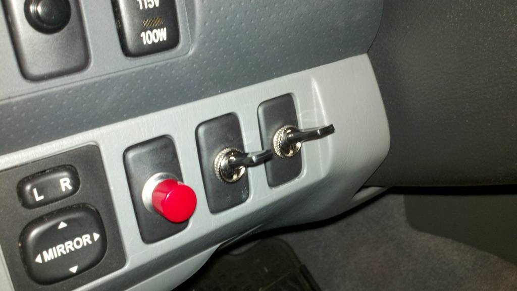

    good job OP! do you have pics of where you mounted the switches?

    I can take a photo when I get home and post it.

    Ok don't laugh at the switches. I'm going to end up changing them for some carling switches down the road. The two rocker switches are what controls the 2lo operation. I flipped mine over so normal operation is up and 2lo is down.

    Is that the history eraser button?! :laugh: Makes me think of this:

    Yeah that button is hideous. It was all that I had and I was trying to save some $. It will be replaced soon for sure.
