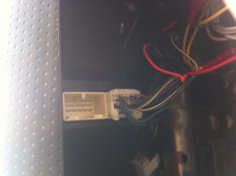

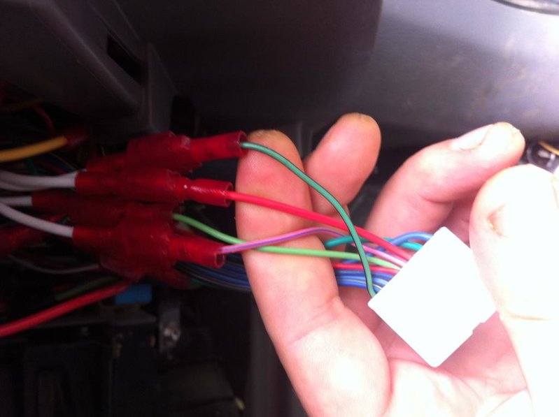

    Everything on the op stays the same the only difference is the wires are located in the plug closer to the cab on the 4wd ecu. Works the same way flip switch turn to four low without front locked. Make sure you cut the smaller green wire it's also a light green compared to the othe I'll try and take some pics tomorrow.

    Hear is a few quick pics of the important things. Haha. Sry my phone cam is not real good.

    Having a lil trouble with uploading pics from my phone
