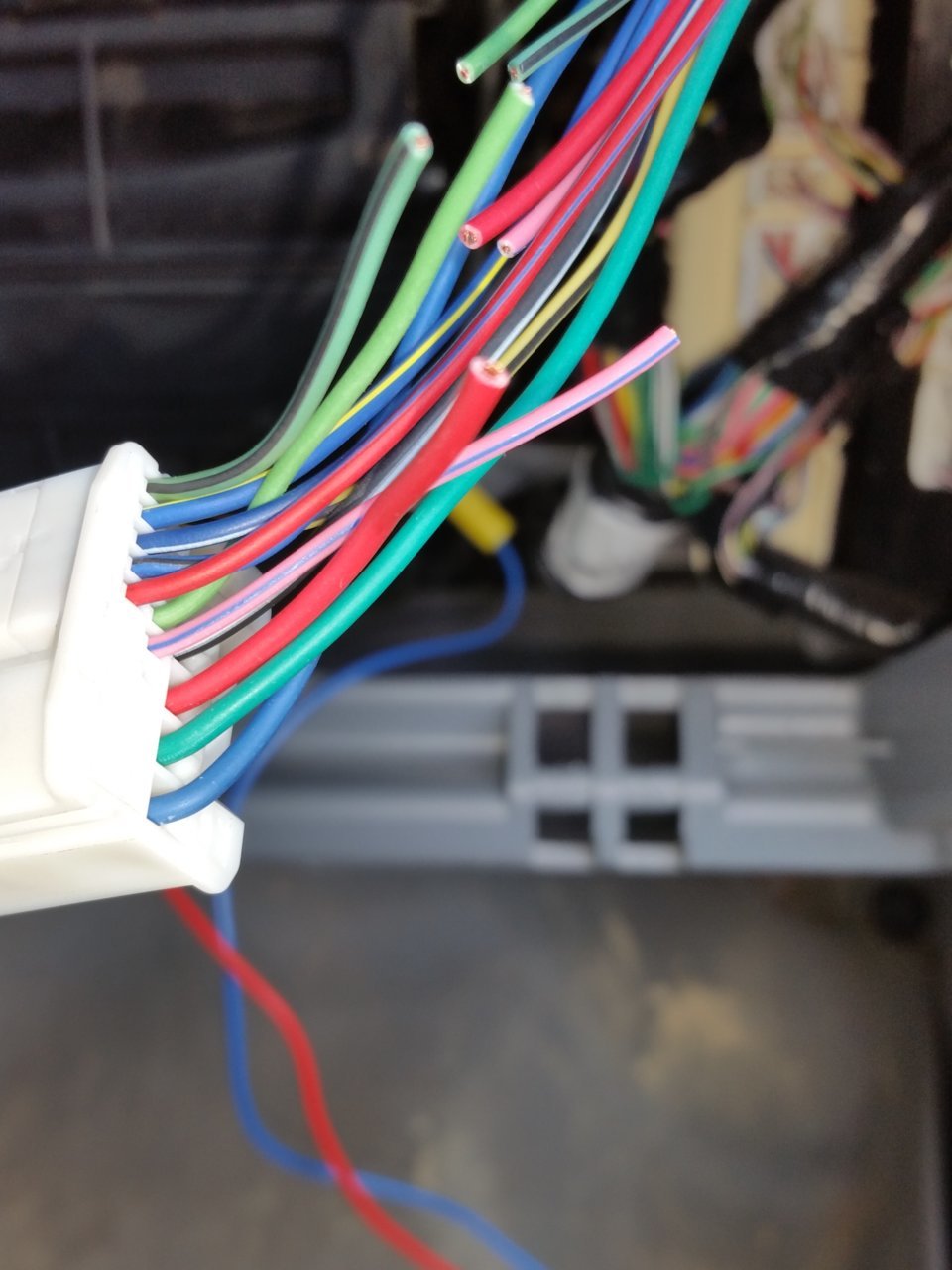

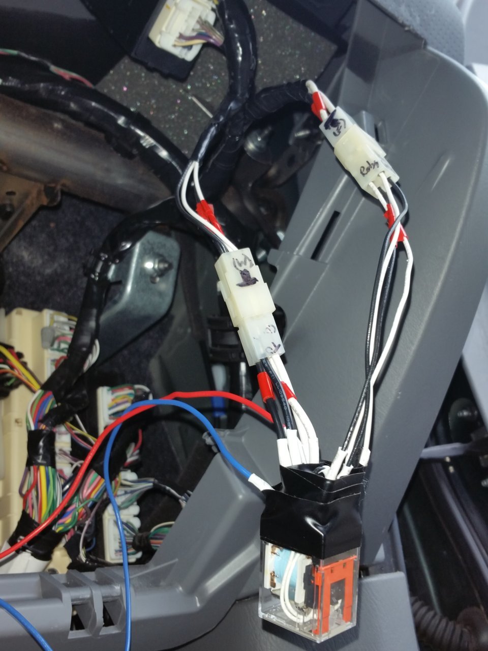

    I finally did this 2 Lo DIY mod, thanks to the Covid19 stay at home order and (thus) having some extra time on my hands. It works great. I used a 4PDT relay and 2 pair of 4 place molex style connectors so I can pull the relay out and restore the wiring if the need ever arises. Thanks to the OP for the schematic.20200416_145407.jpg 20200416_180052.jpg

    I know it's been a while, but hoping to do this mod soon. Do you happen to remember what gauge wire you used for this mod? Thanks for a great write up.

    @07tacoswb I am looking at doing this mod.
    Where did you find a DPDT relay? The only relays I can find are single pole.

    I used an Omron MY4 DC12; which is a 4PDT relay with a 12vdc coil. IMO, using one relay cleans up the installation slightly. You can purchase these relays (online) from Digi-Key Electronics.

    I was looking at Digi-Key earlier today and was quite surprised at the number of 4PDT relays there are.

    @Mongoose trying to get materials together for this mod, was wondering if you could tell me what gauge wire I'll need. Thanks
