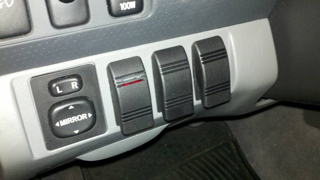

    Well finally got my new switches and man they look a whole lot better than before.

    Great write up. I like the looks of the new switches you have now. They blend in, first ones kinda jumped out at you. Excellent job.

    Thanks. The two toggles were cheap and the red button was laying around the house. I was mainly wanting to make sure everything worked. Since it did I bought better switches.

    So you need 3 individual switches to do this? And have to throw all 3 to be in 2Lo?

    No only two. one is for my lights in the bed. the other two is for the 2lo mod. up and everything is normal. down and you will have 2lo when you engauge 4lo

    You would be better off with a double pole, double throw switch. That allows you to control two independant circuits with one switch. You'll need those extra switch positions one day. I assume the two switches you have now are only controlling one circuit each/single pole, single throw.

    no they are dpdt's. there are 4 total wires from the wiring harness once cut then its 8 wires + 2 ground hookups. so you need two switches. its all in that diagram.

    If you ever need the space you could always go to a single switch controlling a relay bank. That would obviously increase the space and cost but would make for a cleaner end user look. To be honest though, I think it looks pretty great as it is. Nice work.

    Well I took your advise and I have made new diagram for using a SPST and 2 DPDT relays. I'm going to buy the relays and get everything installed and make sure everything is working and I'll post the new diagram.

    So I had a few people suggesting relays so I changed up my install to two DPDT relays and a SPST switch and everything is working fine. Here's the new diagram:

    Excellent! Another mod I will be doing this spring. Subscribed! So you have only one switch now? any pictures of the actual wiring itself?

    Yep one switch. I don't have any pics right now. But I can take some tonight when I get home.
