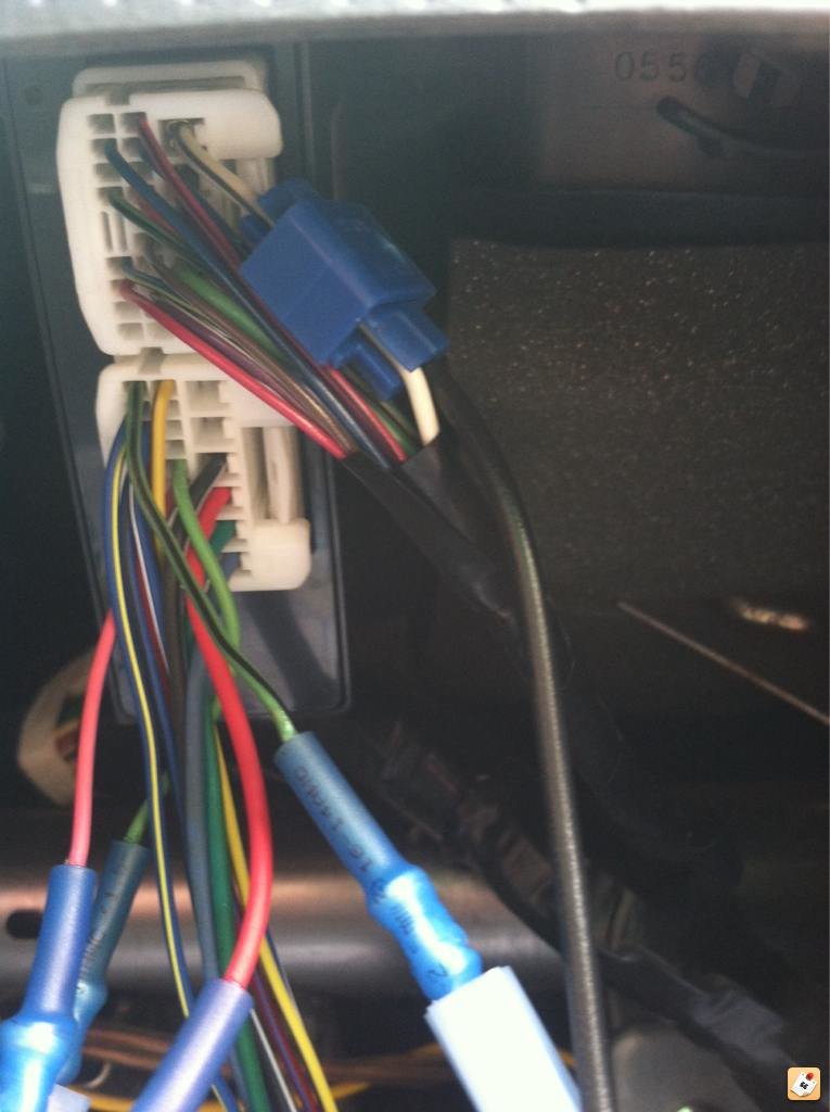

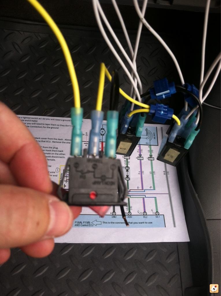

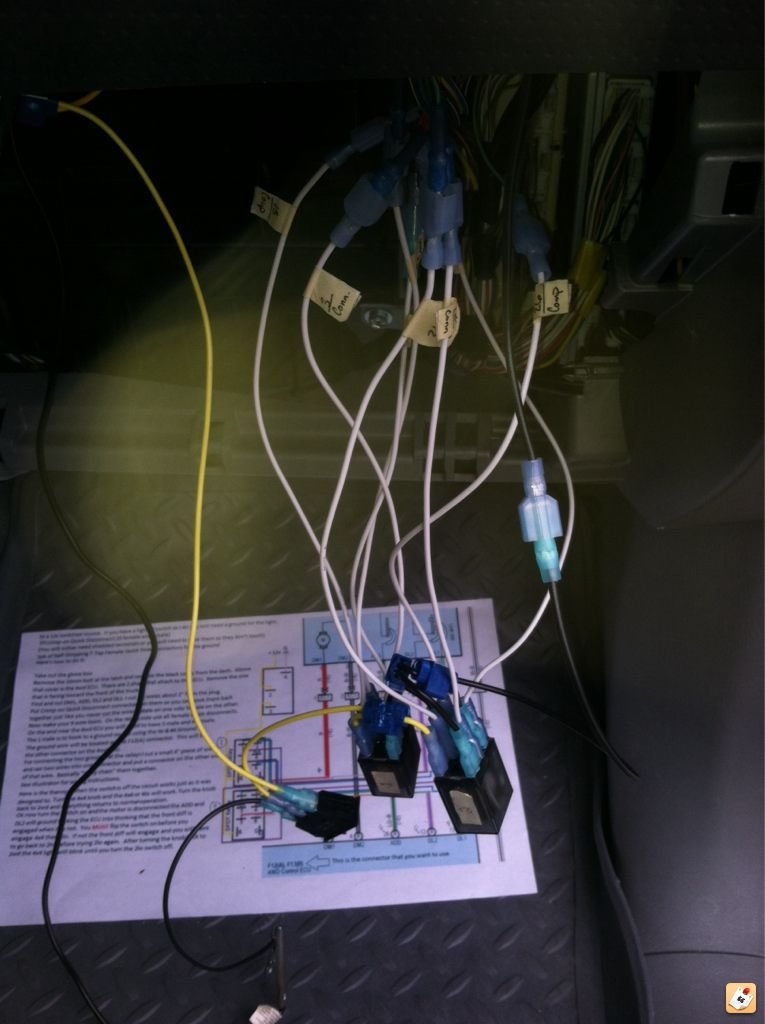

    My set-up is now working, thanks to Alan's help. He has been invaluable in the process. Huge kudos to him.
    Also, a big thanks to Brady for looking things over as well and offering suggestions. I absolutely appreciate the time both of you spent on this.
    Here's a few pictures for those who asked. The wiring is slightly off in these, but you wouldn't be able to tell bc it's only off by a few terminals on the relays. The general idea is exactly the same and I'm showing these just so the reader will have an idea of what the completed mod looks like. Also note that this is before the wiring is cleaned up with zip ties and before I run a Carling switch over to the left side of the steering column.
    Everything installed:
    The separate ground wire from the other plug in the 4WD ECM:
    The switch that I have wired in temporarily.
    If anyone has any questions, please let me know. I'll be happy to try to pass along any knowledge that was passed along to me.

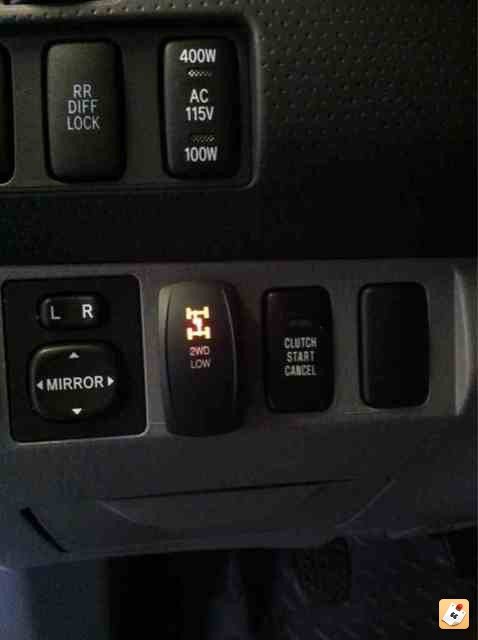

    All done and working properly. MANY thanks to everyone who helped me with this. It's not the most difficult job in the world, but it sure is a lot harder than doing the same mod on a Dana 18 transfer case...yhany6yv_632fdf2fbb37154e4342a387139295418c5556fd.jpg

    So, where did you get that switch? Inquiring minds need to know....

    The switch came from www.otrattw.com. The script on it was not something they already had. But when I called to order, I told them what I was doing and they were very happy to make one for me.
    And it was still pretty cheap too. Something like $17, I think.
