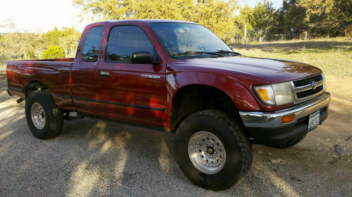

    so I have a stock height 2wd 97 and its getting harder to find tires in the 215/70r14 size evry time i need them and was wondering if some of the American Racing AR62 Outlaw II would fit? theyre 15x7 with a 50mm offset. i just want something nice-ish and also benefit from a wider variety of tires.

    Yes they will fit as long as the lug pattern and center bore are correct. You can easily run a 235 75 r15 with them.
    Here is someones thread with them.
    https://www.tacomaworld.com/threads/97-5lug-build.195038/
