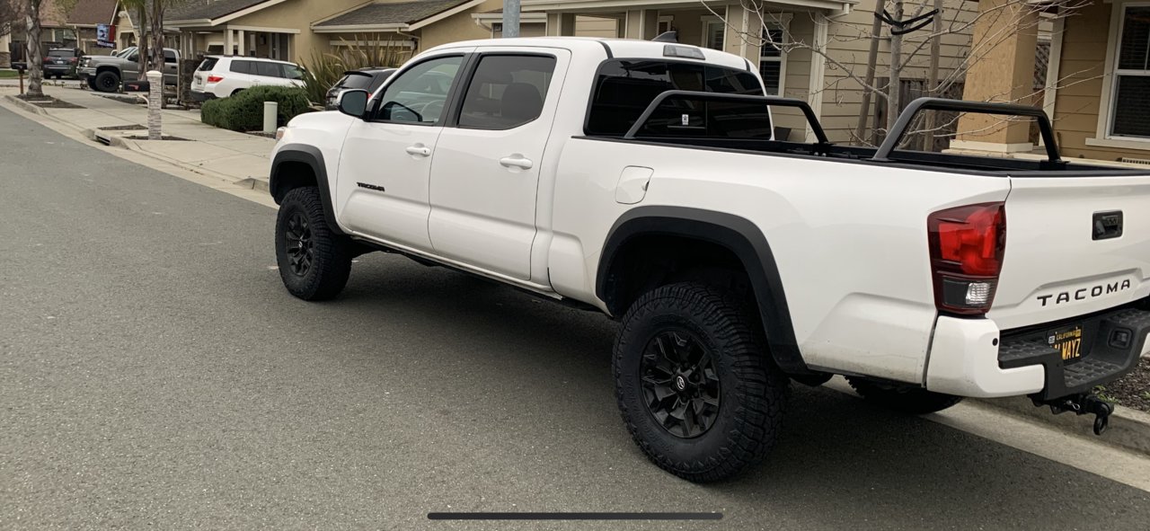

    D68CD928-EB26-419A-B552-0623C2F09952.jpg Imo you will be fine with both. I have a 2.5” 1.5” spacer lift , did the ecg’s bushings and did a lot of research. My bro is a mechanic so hooked me up. Surpreme Suspensions lift. Alignment in spec. Couldn’t be happier. 16k on lift. No problems. Light trails and camping for me. Good luck. Here she is 265/75/16 Yokohama X-AT

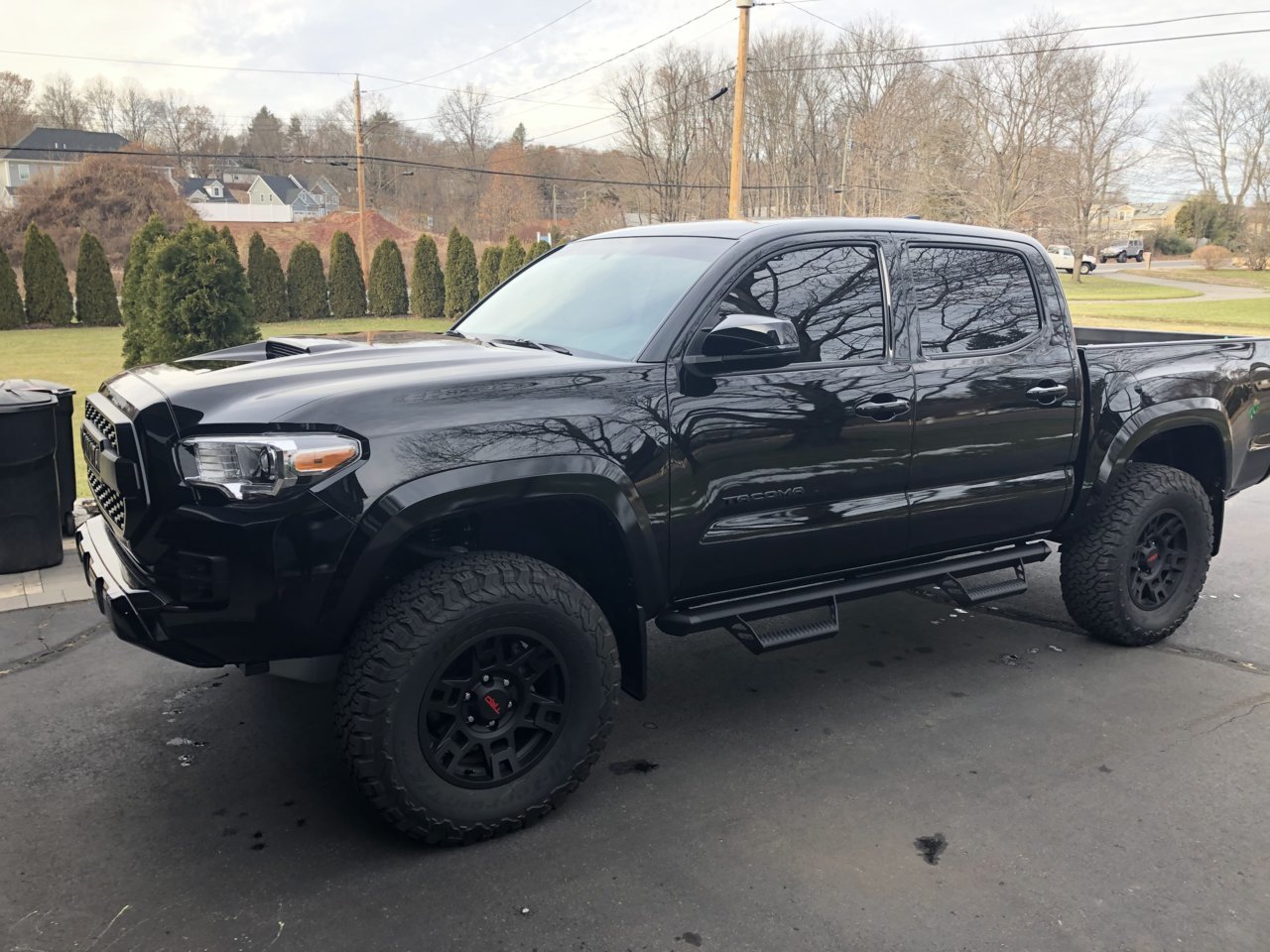

    I did a 3/2 blocks and spacer lift for the pavement princess here; no rubbing no cutting , etc...very image0.jpg happy with the setup. I also did a rough country speedo recalibrator

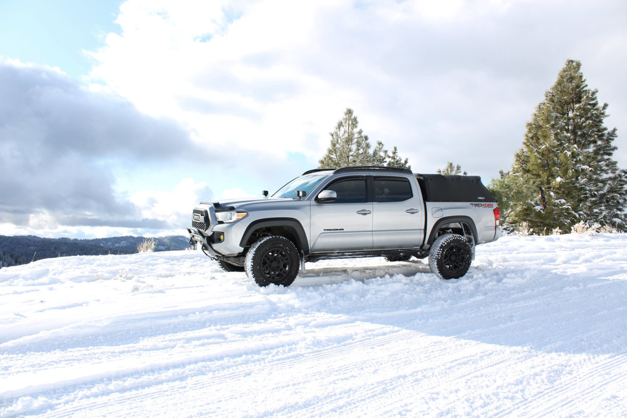

    The Bilstein 5100, 6112, or Eibach Pro Kit would be your best option at 2” of lift. Anything above that is dumb unless you do long travel. This is 1.5” of lift in the front. I do the same off-roading (and a bit more) than what you described. Plus it rides VERY cush
