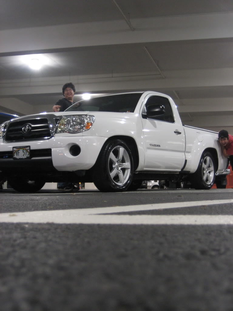

    djm 3/3.75

    How did ya get the 3.75 in the rear? Notch it?
    Looks GREAT!!!!!
    What size tire and wheels?

    he has 2" beer can blocks and 4x4 leaf pack with a flipped overload leaf. From what I have seen, it is not notched, but I am not sure when the picture I saw of the rear was taken. I'm gonna be doing the same thing soon, but my front will consist of the J&J 1.25" spindle spacer and the Sittin Sic 1.75" drop coils.

    but yeah...in the back im running 2" beer can aluminum blocks with my 4X4 leafs and the stock mini overload in the unhappy position. NO NOTCH! RUNUMHARD! hahaha...nah it dosen't ride too bad...even with my shot to hell rear shocks (gonna change em out after recon and my paycheck lol). and i do have a bit of driveshaft vibe so i gotta go and get me some tapered 2"ers....thats why i went with the aluminum ones cause i wanted to see if i needed the tapered ones or not.
    so yeah its a DJM little more than 3" front and 3.75" rear
    and doing alignment by eye is horrible. i never want to try and do that again. and the eccentric bolt and nut are bastard bolts.
    and their RX8 rims with Goodyear Comfortred 225/60/18s
