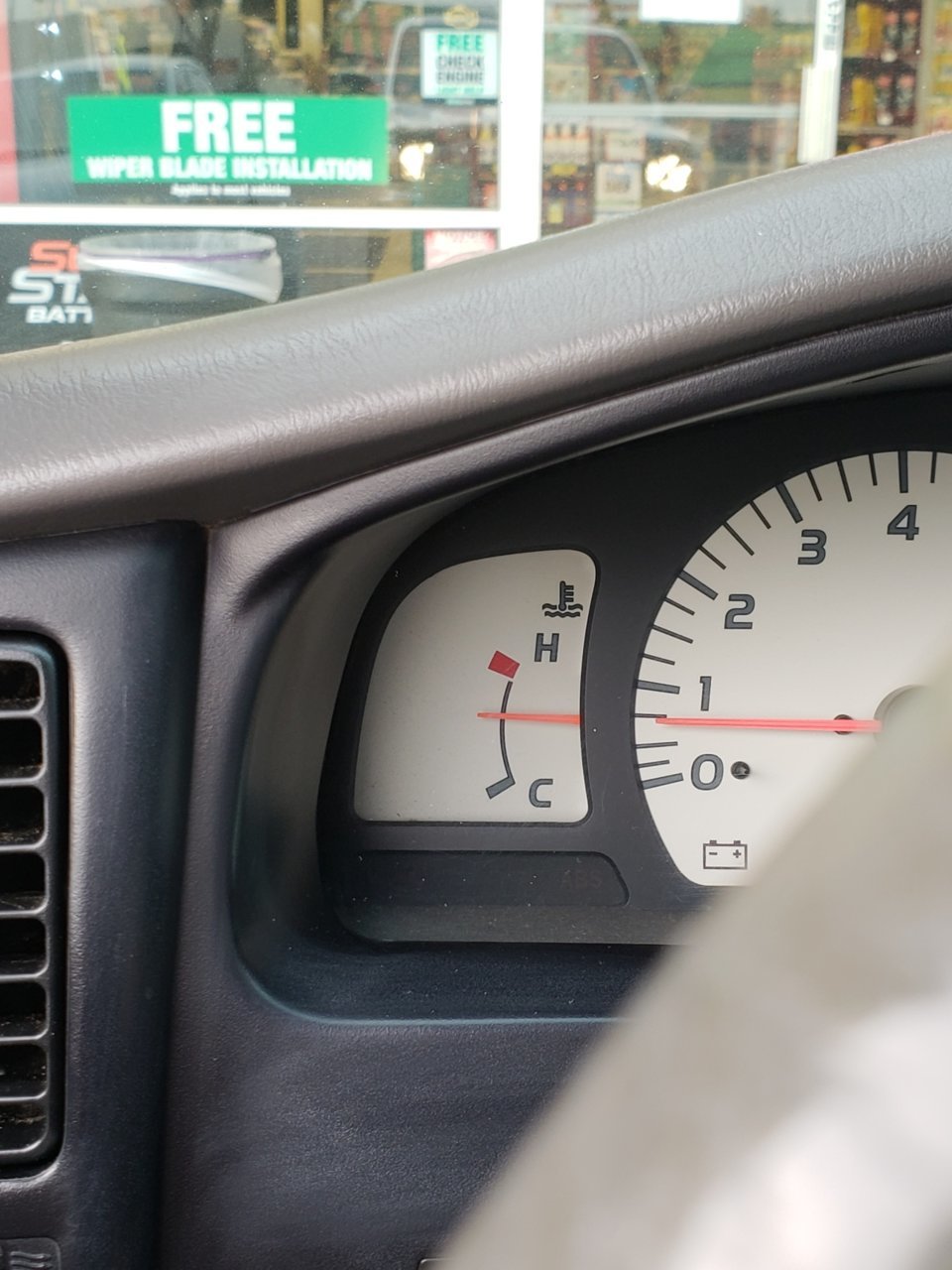

    Recently purchased a 2002 3.4 v6.
    I'm concerned the oil temp gauge needle is just a little above the halfway mark. Wondering if this is normal. I'm not completely sure when the last oil change was, so I'm thinking of doing that anyway.
    Edit: sorry idk why image is sideways it wont let me fix it

    I think that's your water temp, but that is right where mine rides at. Like @Jay-coma said it's always good to update all maintenance for your own peace of mind. How many miles do you have on it?

    You can't gauge the oil temp by the stock dummy cluster. Get yourself a ScanGauge! It will tell you exactly what you need to know down to the decibel, along with water, and A/T oil temp if you have one. It easily plugs into your OBDII port and can be mounted anywhere in the truck wherever you can see it.
    1997tacomav6 and N81292[OP] like this.

    And for the record, my temp gauge needle has always gone to that exact position in the near 5 years I've owned this rig. Not a single problem thusfar!

    2002 with about 220K miles. Not terribly high
    Yeah I like the idea of a scan gauge especially for these older models.
    I'm just wondering because I had a 2001 in the past, and that same needle never went over half.

    This is common, they're all a bit different I think. More important to make sure the cooling system is working properly and not leaking. The waterpump and seals are a common weeping point after X amount of miles and should always be replaced when the timing belt is done for peace of mind. Even comes with the T/B kit from Toyota! :)

    Only time the stock gauge will ever move of it's normal position is if there's a problem with the system, and by then, it's usually too late and you're already overheating or lost all coolant.

    So I guess mine is normal? Maybe I'm a little paranoid

    My 91 and 95.5 never got above half, my 2000 always sat right in the middle and my 04 sits where yours is. None of em ever gave me problems or over heated. I think it's just the different style of guage clusters.

    That's your coolant temp, some say theirs sits a tad higher than the middle but mine has never gone over dead center. Either way, you can't really trust that gauge. You can be well into overheating territory before it'll budge towards red. Best way to confirm your coolant temp is to run a Scangauge or other kind of scanning tool and get an accurate reading. 190° is normal operating temp for these trucks. Some see regular temps closer to 200 which is fine. Mine goes between 186 - 205° depending on outside temps and what I'm doing with the truck. Once you pass 215° is when you should be worried.
    That gauge will never tell you what your accurate temp is and you can be over 215° and it wont show any danger, even though the danger is real. Get a scanner tool to know for sure

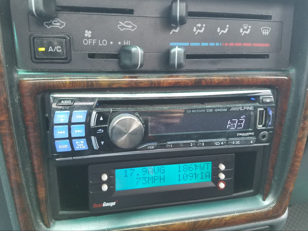

  15. Feb 14, 2019 at 4:04 AM
    1997tacomav6
    1997tacomav6 V6 5sp,RegCab,TVS1320 Supercharger,Haltech, 800k
    Oct 5, 2013
    #113940
    10,386
    John
    Denver
    97 reg cab, v6 5sp 300hp supercharged, Methonal Injection, 800,001 plus miles, Original Owner
    V6 5sp,RegCab,TVS1320 Supercharger, 56mm pulley, methanol injected Haltech ECU, AC Tvs1320 supercharger,(MUST DO) every 125,000- 150,000 needs rebuild Projector headlights HID 5 speed manual Amsoil for all drive train Smaller 56mm custom pulley, (MUST DO) 2004 DESNO fuel injectors, zero ping ping, 2004 side door mirrors Dick Cepek Rims, Michelin tires LTX, ATM Pathfinders Dynopro ATM ( that last 100,000 miles) Now running Dynopro ATM mud and snow tires KN cold air intake Cat back dual exhaust with ss exhaust tip, Raised exhaust tail pipe to 2" below body line Optima*dry cell battery,red top Alpine sirius radio, 200 watt amp, focal is165 split door pod speakers Focal door speakers Subwoffer behind seat Viper alarm, Electric Locks Dark tinted windows, bucket seats corbeau lg1 Tacoma Rubber floor mats TRD fender extenders, Bilstien shocks, King shocks JBA UCA trailer iv hitch, electric brake control, Drilled slotted brakes, High carbon steel (MUST DO) EBS green stuff 7000 series pads(MUST DO) TRD engine oil cap TRD stick shift, Marlin crawl shift kit. Rear sliding window 2002 4Runner functional hood scoop cut into Tacoma hood, 4Runner dual overhead map light Gentex Auto dim + Compass + Temp, garage,rearview mirror Snow Methonal kit stage 2 Custom 3 core aluminum radiator Linex bed liner Haltech stand alone ECU, Intake supercharger gauge. Stainless steel brake lines, Custom leather wrapped steering wheel, Haltech stand-alone ECU,
    The dash guage you have doesn’t tell you the exact temperature. My dash guage actually never reads as high as you show for me.
    A scanguage will fit perfectly in the pocket below the radio.
    You squeeze it into place and it’s holds perfectly.
    Will take 5 minutes to install
    You drill a hole in the back pocket, plastic is brittle so use high speed drill and drill slowly.
    Run wires to OBD through the hole.
    Center the guage
    and your done
    Now you have all types of info at a glance
    SO simple for 150.00
    This photo was when it was over 100 degrees outside at 73 mph.
    Engine was at 186 degrees with AC on

    As others have said, the temp gauge on the dash is what is called an idiot gauge. It will only move past that position if the engine gets beyond a certain critical temp.
    Then people hook up a scan gauge and freak out when they see the temp moving around. That's perfectly normal, and to be expected under different load conditions.
    But your needle seems perfectly normal. Mine has always been in about that same position, maybe a bit lower, but it's hard to tell from the perspective of the pic.
    As long at it doesn't keep climbing and you aren't getting warning lights, I do't think you have anything to worry about.
