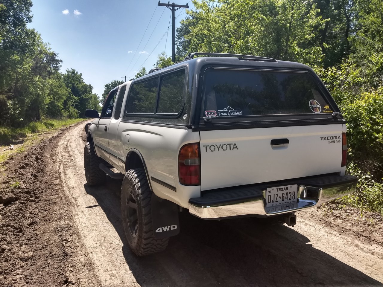

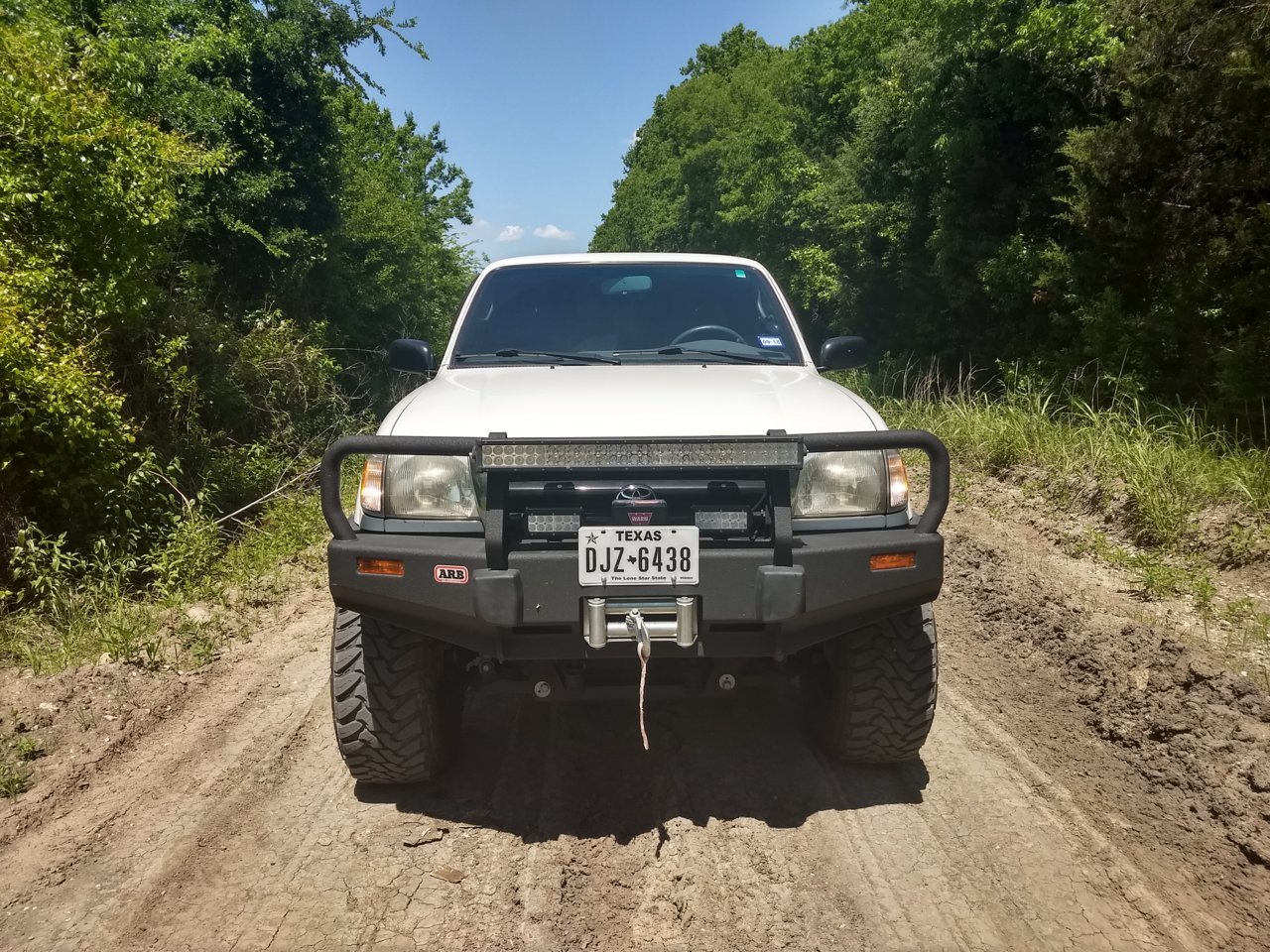

    @vasinvictor is right on the money. Truck has just a touch under 75k.
