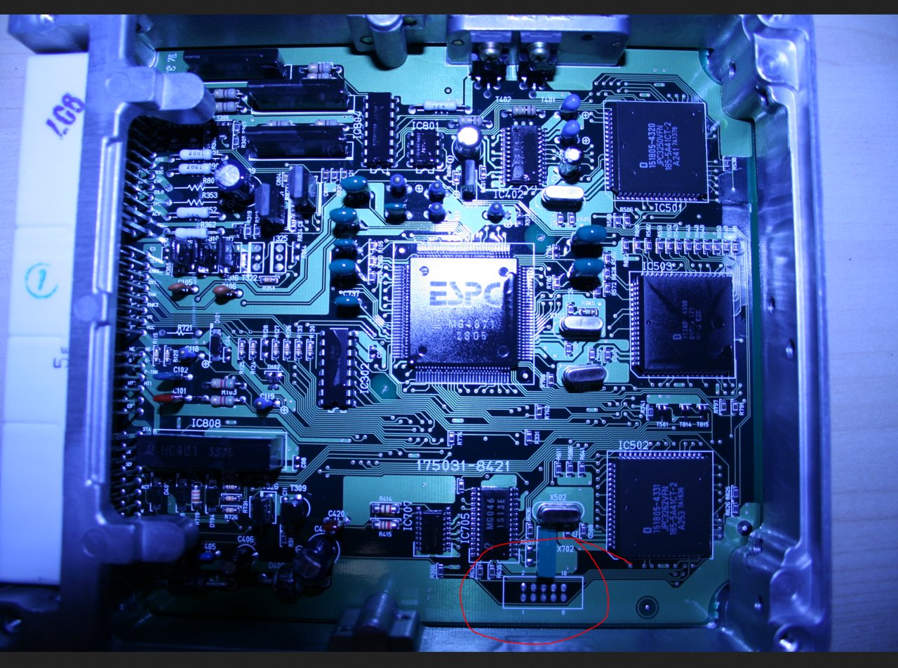

    Which is quite shocking considering how popular these forums and engines are. There's got to be a hardware hacker somewhere willing to take this on.
    Plus this looks to be an access header of some sort
