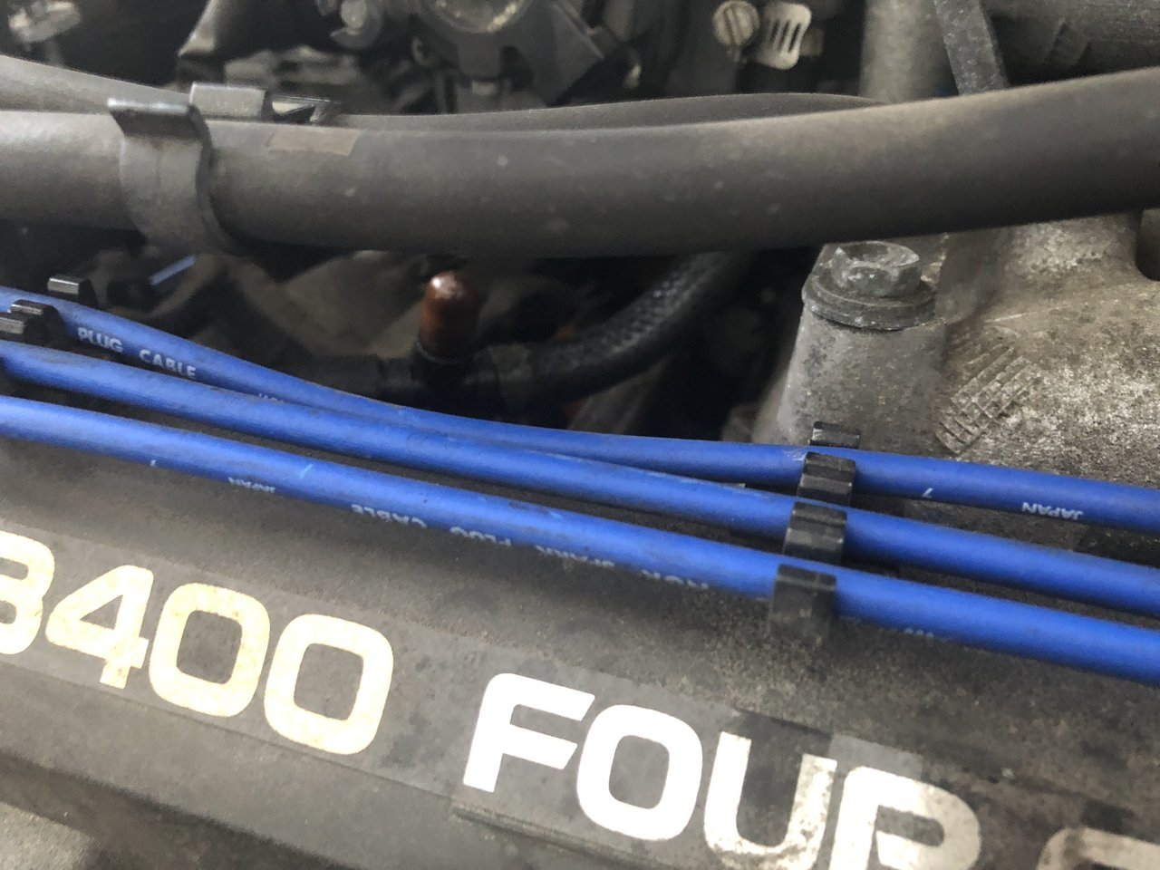

    afternoon folks. Wondering if you can tell me where her the pcv valve hose on your 3.4 has this fitting on it and if it’s important.
    I’m replacing the pcv tomorrow and can’t seem to find the part or the part number on any of the diagrams but the stealership sells the hose and the pcv/bushing.
    Let me know. Thanks.

    I just replaced mine a couple months back. It did not have that piece on it. I got mine from camelback Toyota.

    Mine don't have that either. Broke my old,one pulling it out. Damaged the gromet putting the new one in . I need a new grommit. The piece in the photo may just have been some one plugging off one side of a Tee to join 2 pieces of hose if a long enough piece was not available. I've done it before

    Thanks guys. Off the to the dealer.
