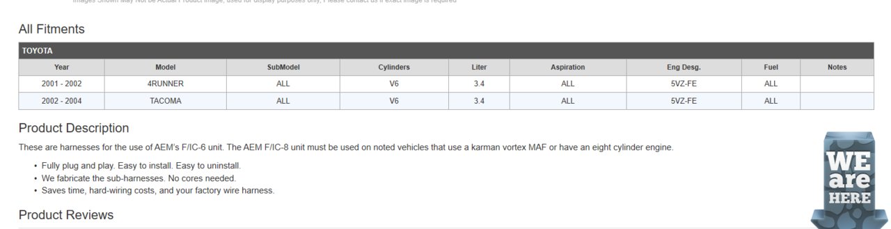

    Alright, I have been doing a lot of research and been finding good info on how to splice into the stock harness. Had some bad/good experience doing this on my e30 turbo so this time I decided to jest get a Boomslang prewired harness and avoid all the headaches.
    Yes there is a lot of info on this topic but what im coming up short with is the tuning.
    For those running the FIC6 did you do the tuning yourself or have a shop tune it?
    Anyone willing to share with the tuning info?
    Im getting my harness next week and need to tune my FIC6 for the larger injectors.
    With my e30 project I was able to find a tune set up really close to my car set up and no it wasn't perfect but it was pretty good. Looking to see if I can do the same on my truck.
    Or help tune mine.? here is my current set up:
    TRD supercharger 2.2 pulley
    Fuel Injector: OEM Denso 23250-46050 (310cc)
    Denso Iridium IK24 Spark Plug 5311 (Gapped at .043)
    Walbro 190 LPH pump kit from URD
    Boomslang AEM F/IC Harness BF12106
    F/IC 6 Piggyback PN#30-1910
    Innovate Motorsports 3892 PSB-1

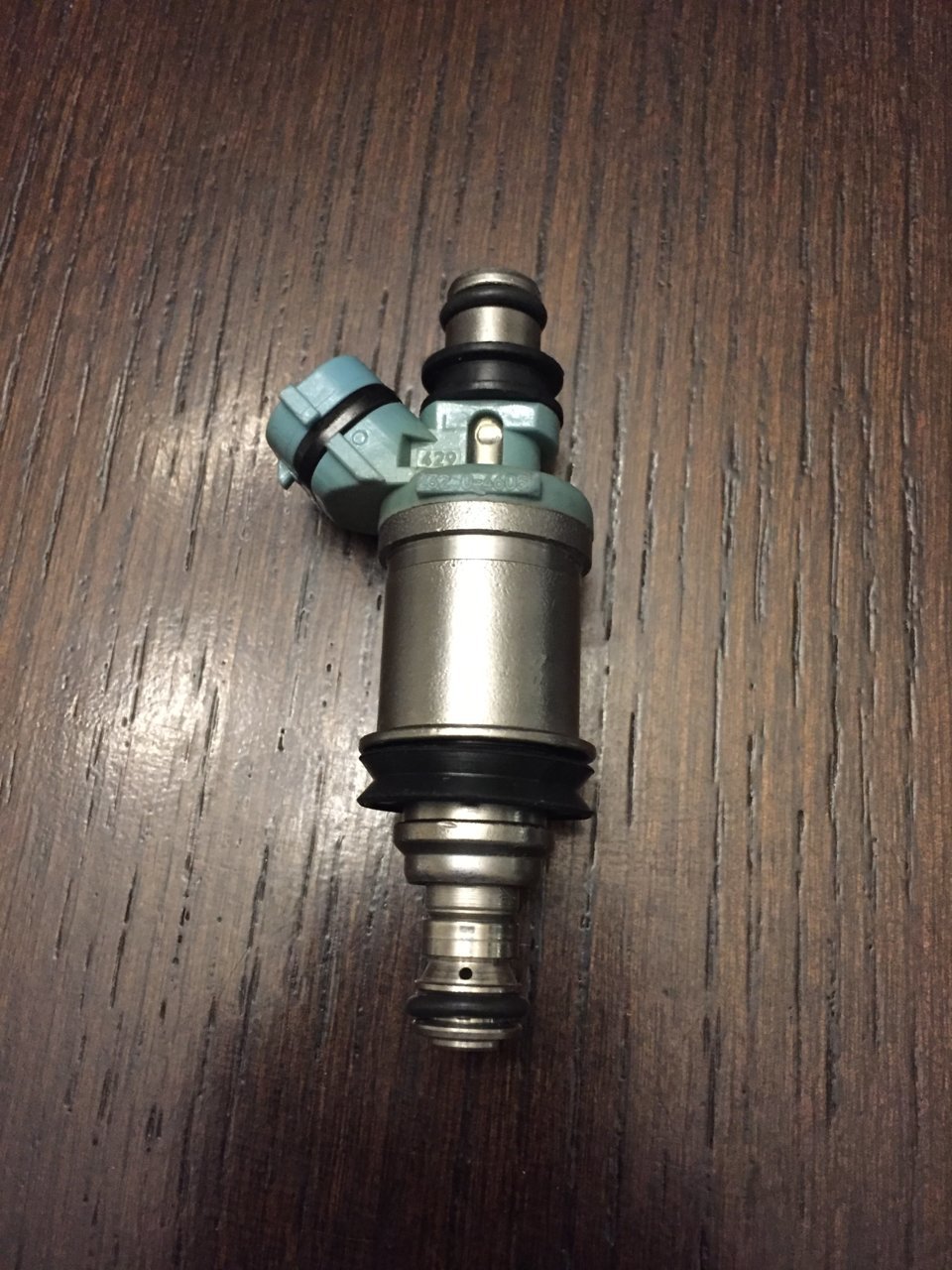

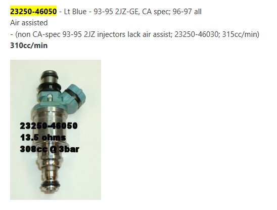

    These are a plug n play but they might not be the best option for the 5vz engine.
    The stock injectors are air assist. I think the better option for fuel injector would be Denso 23250-46050 (these are equipped with the air assist)
    They seem to run better. Ill be ordering them today to swap out mine.
