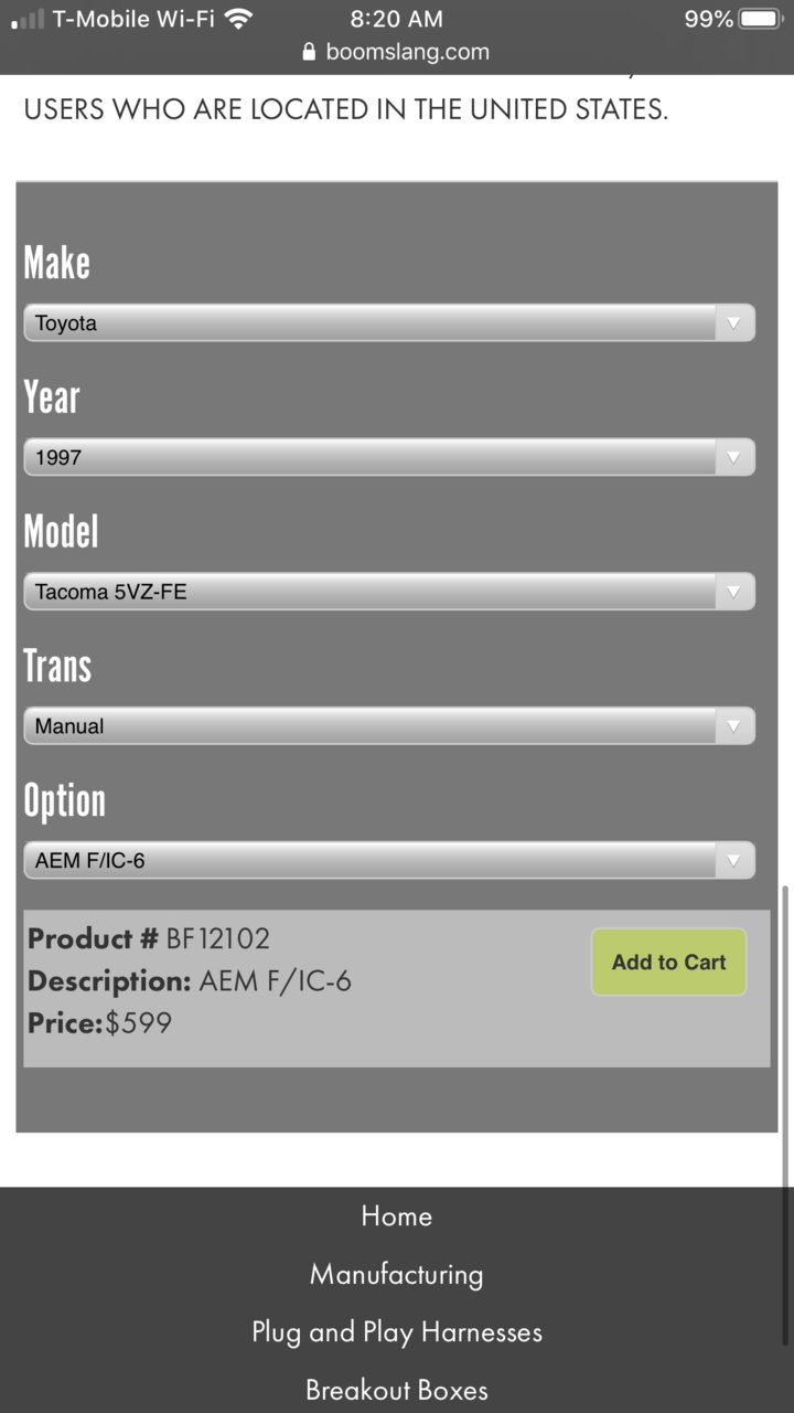

    Is the process the same for the 1997 ECU and a Boomslang will work for 1997 too?

    Plugged in the Boom Slang yesterday ran a vacuum line to the FIC
    Truck started and died
    Plugged in the bypass harness to the FIC , truck started and die.
    Plugged the ECU back to stock, truck runs as normal
    Am I missing something?

    You need a different harness. Also why are you running different injectors? The stock ones are fine especially if you are running the 7th inj Kit. I’m running almost 10psi with no problems.

    Boomslang ran a diagnostic and discovered one of the pins was pushing it out and not connecting to the ECU
    They corrected it and are sending it back to me
