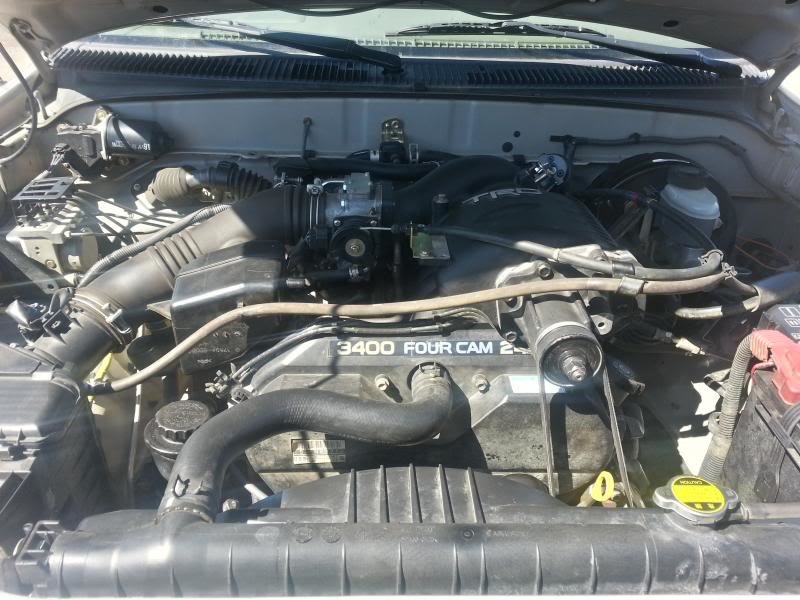

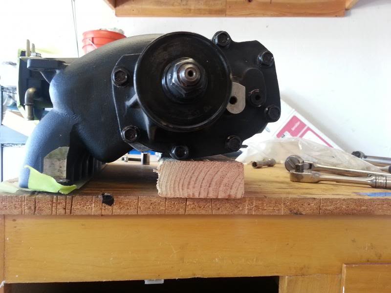

    Rebuilt my sc using ceramic bearings in the snout. Lets see how they hold up
    My truck had 123710 miles on it after rebuild
    I bought my sc used so i had no idea the actual miles on it. It made a kind of chirping noise at an idle. Ive owned another 3.4 sc before and I have a couple friends with them. None of them make this noise.. So i decided to rebuild so i would know its dependable
    first off I used this to rebuild.
    http://www.tacomaworld.com/forum/1st-gen-tacomas/267610-3-4l-trd-supercharger-rebuild.html
    Ceramic bearing kit from rolling performance CBBSNOUTKIT03
    I also did the rotor bearings #INRBRG. and new coupler
    rebuild is not really that difficult. Use a press if you can. Its just kind of nerve racking.

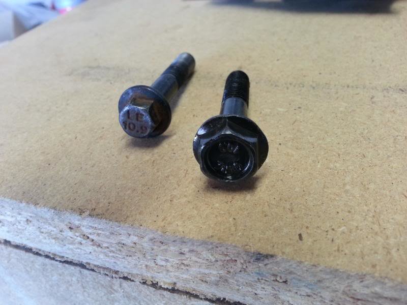

    I did bust a bolt when i was reinstalling the snout so i ordered new ones from Fastenal . I think they look good
    New bolts installed torqued to 20lbs
    installed
