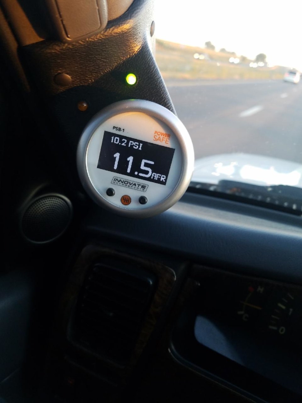

    I installed the supercharger new in 1998 a year after or less when I brought the truck, so the supercharger has 600,000 miles on it and I rebuild it every 100-150k miles.
    I have more miles than anyone here on my TRD supercharger.
    AND I have lots of little mods done to get the most out
    of the supercharger as its a daily driver with 10 pounds of boost.
    The supercharger will not hurt the engine in any way.The supercharger will get you 60 to 120 extra horses depending on what mods you do.
    You just have to make sure your fuel system is working correctly with the pulley
    and altitude that you are at. If you run a stock pulley you will probably be ok with
    the stock fuel system depending if your truck is ping happy or not. If it is ping happy
    or you run a smaller pulley and your at sea level you will need to up grade the fuel
    department with 7 th injector or methonal kit or etc.
    Thats another thread depending on what your goals are.
    You want to have a safe AFR at full boost around 11 - 12.
    11.would be the richer side, 12.would be the leaner side.
    11 is your goal, you want it richer rather than leaner. Leaner is when ping comes
    into play.
    Smaller pulley more boost added
