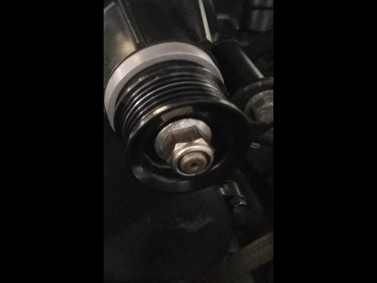

    1st of all NEVER use impact on the supercharger.
    Your seal is leaking and probably was not set correctly if you used an impact and possibly could have
    hurt the shaft.
    The seal is made of very hard rubber that if not set correctly will wear a grove in the shaft if it’s off center.
    You might have to remove the snout to see if the shaft is damaged with a groove now.
    Your oil level will be low too.

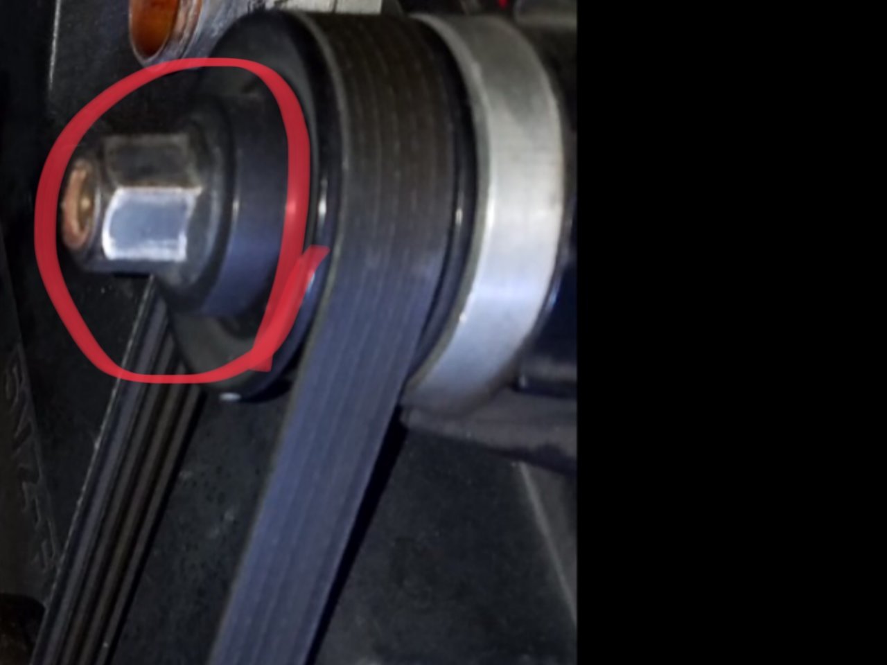

    @Ccrowe323
    There is a pretty good chance you put the pulley on backwards if
    the pulley was sucked up again the snout. There is a front and back
    to these pulleys. They go on one way and it’s not uncommon to install it
    backwards.
    The top photo is the pulley on backwards.
    The inner round block ring should be pushed up again the snout.
    The bottom photo you can’t see the inner round block section and that’s the correct direction.
    I actually had mine on incorrectly for a while with a spacer, lol
    WRONG DIRECTION ABOVE
    CORRECT DIRECTION ABOVE

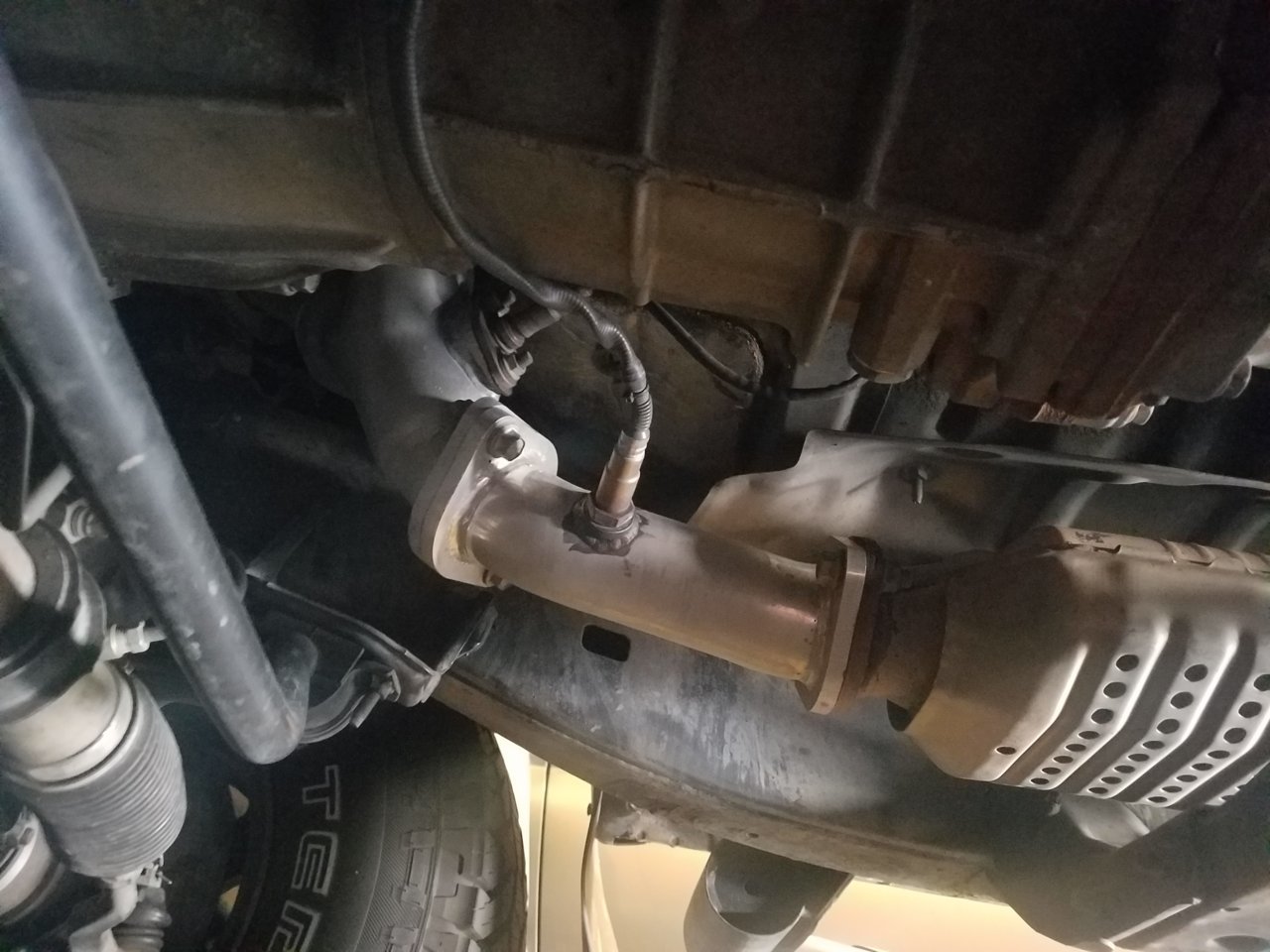

    Dammit fellas, I’ve spent the last three weeks reading this thread, I’m at the end now and looking at ordering what I need to supercharge! Hello credit card!! I am in the middle of a frame swap now,
    https://www.tacomaworld.com/threads/frame-swap-n-facelift-for-mable.660848/

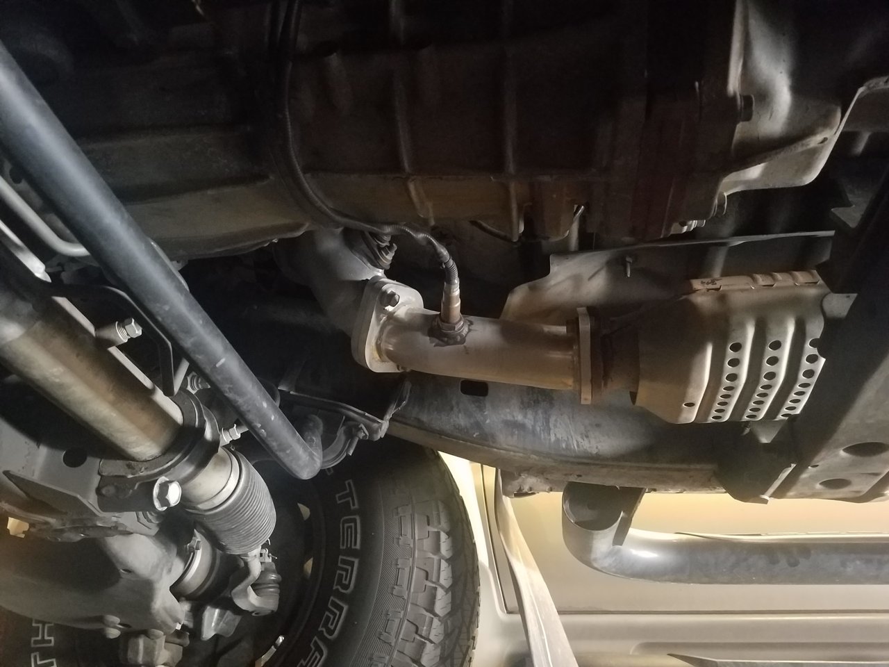

    I have easy access to weld in the bung for gauge onto the exhaust. You guys think I can stick that on for now without the gauge or supercharger, while I have access? Should be okay to run/drive with just the sensor in right? Second, can you point me in the direction of the bung/sensor? Or does it come with gauge? Thanks, and F y’all for making me sink another 5K in this project.

    The sensor and bung comes with the guage. I personally would wait so you know everything matches up and you get the correct position with everything back together with the truck in that area

    where does the bung go exactly? Easy section of exhaust to remove? Speaking of exhaust, need to grab a muffler to weld in to stock pipe. What are you running sir?

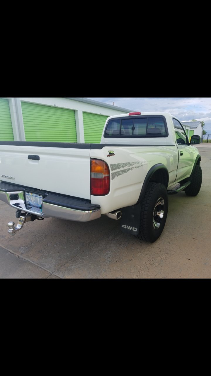

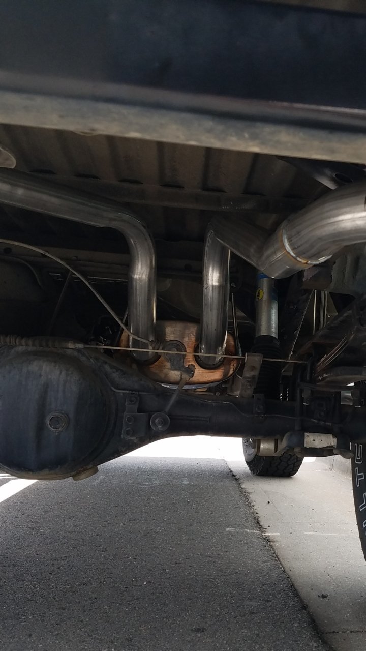

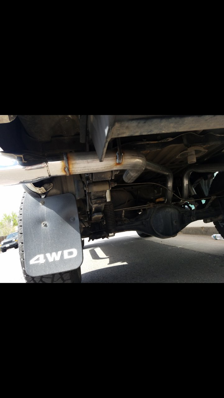

    1997 with single cat v6, doug thorley headers
    I’m running a magna flow exhaust right now that’s 15 years old.
    Next week having dual exhaust added just for the hell of it from cat back that will be a magna single in dual out coming off either sides of the side of the truck :)

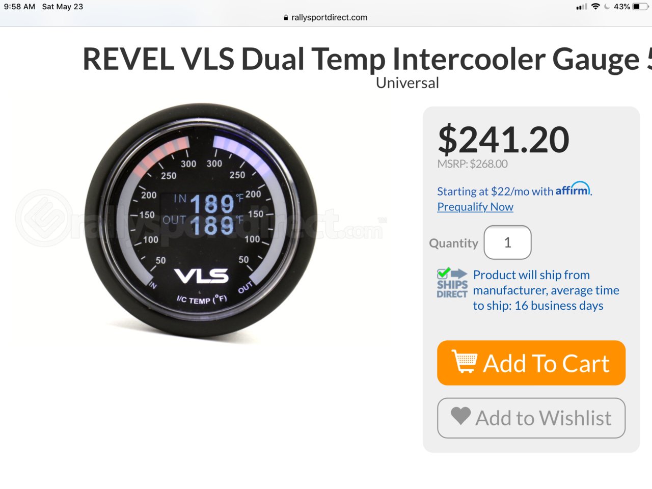

    My next mod in question when I get my supercharger rebuilt next in the fall and it will be off the truck will be a dual air temp guage if I can
    get one of the sensors tapped into the supercharger area going into the intake if possible, don’t know.
    Then I would have before temps at the throttle body and temperatures going into the top of the intake after the supercharger.
    Would be interesting to see how much temperatures difference their is with different methonal nozzles.
    Clock location will be the Gauge location.
    Have to do some research on this and find a guage I like too.
    Don’t know if anyone has done this mod?

    I've been researching uses the AUX in on the Fic6 for post supercharger air temp. Got it figured out. I'll be able to see temps with lap top or log temps. But never thought about using a double gauge.
