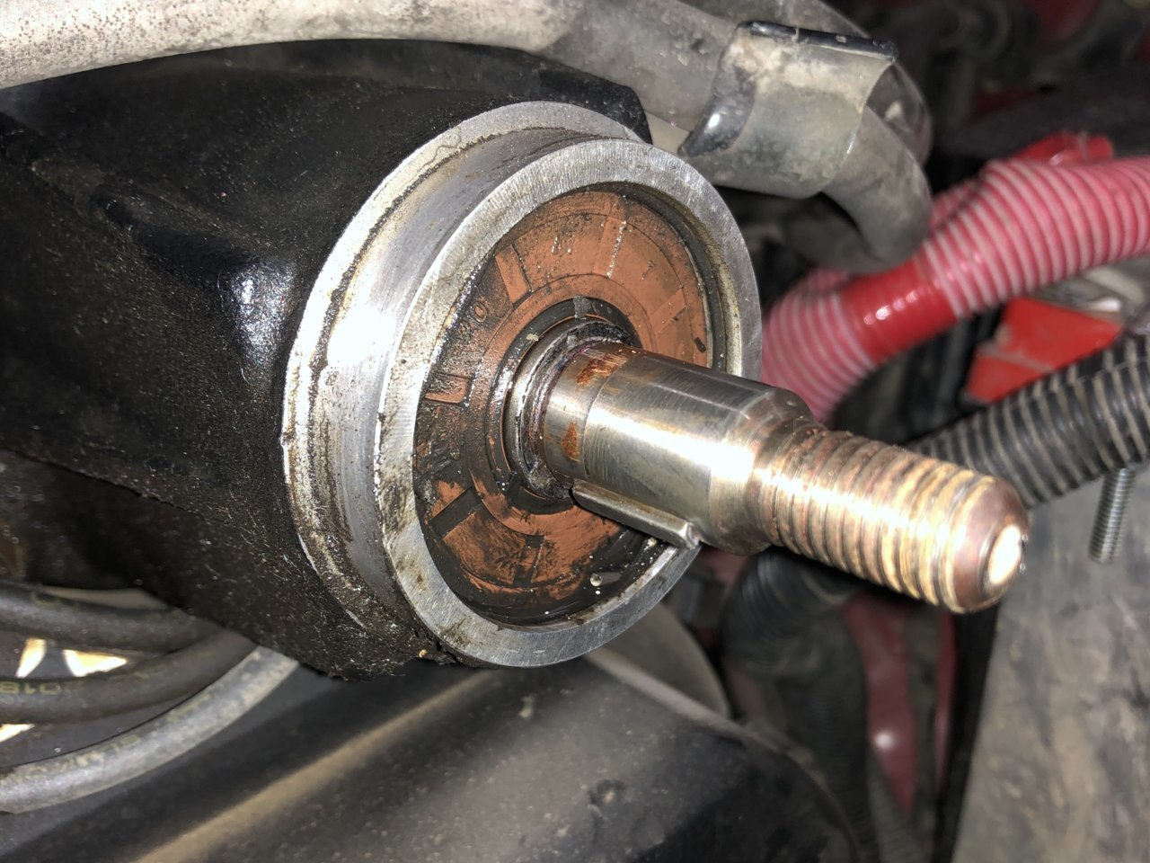

  16. Jun 1, 2020 at 12:27 AM
    #2056
    austinmtb
    austinmtb Well-Known Member
    Feb 26, 2017
    #211727
    1,054
    Austin
    Southern Oregon
    2004 Toyota Tacoma DC TRD 4x4
    ADS Coilovers & Shocks, All Pro Standard Leafs, TRD Supercharger, Haltech Standalone, URD 2.2'' pulley, Method NV wheels, Copper Discoverer STT Pro tires, ECGS 4:56 gears, custom steel tube bumper, custom steel skid plate,
    I did, but I didn't like how it was looking so I just threw my old URD pulley on for now until I can call pulley boys and figure out whats going on.
    It's not as obvious in the picture as it is in person, but with the pulley flipped around it's not in alignment with the engine pulleys. It looks like the belt could get ejected off. The original way I had it seems to match how the URD pulley is, but like I said it comes in contact with the nose of the supercharger. Also, when I put my old URD pulley on I didn't have any alignment or contact issues. Seems like a small spacer would do the trick.
    Pulley flipped around:
    You can kinda see how the belt is pulled at an angle and favoring one side of the dynamic tensioner idler.
  17. Jun 1, 2020 at 4:47 AM
    #2057
    Rldanie
    Rldanie Punisher78
    Jan 28, 2018
    #242763
    829
    Colorado
    2002 Supercharged, 2” pulley, FIC, Methanol, Transgo Shift Kit
    Engine Performance upgrades: Supercharged (Magnuson) FIC/6 Champion Radiator Toyota Corolla thermostat 168° JBA Headers JBA cat back exhaust Upgraded fuel pump Volant Cold Air Intake With custom plexiglass cover TransGo Transmission A340F Valve Body upgrade B&M Transmission cooler Methanol Injection 2 inch pulley Future Plans Supra Injectors Light weight crankshaft pulley Leather seats Off-road upgrades 3” rough country lift 33x12.5” Dick Cepeks Other upgrades: JL Audio 12W6 Sub in custom box JL Audio C5 Mids and tweets all the way around Sound dampened whole cab Transmission temp sensor Gen Tex rear view mirror (temp and compass) Blue instrument panel, a/c control panel lights, shifter, ashtray, glove box. Blacked out badges Blackout bumpers and grill MariMoto Projectors with demon eyes LED Taillights Second generation leather steering wheel with audio controls Custom leather wrapped automatic transmission shifter 3rd gen 4 Runner key ring light (blue) 3rd gen 4 Runner hood scoop
    They sell a spacer, you might need that for your application
    austinmtb[QUOTED] likes this.
