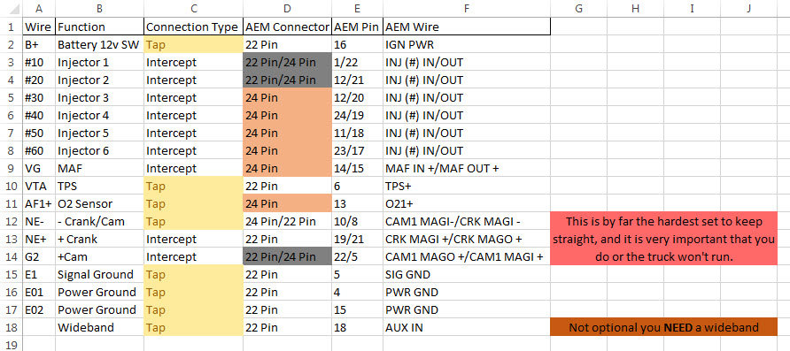

    I'm looking for the wiring diagrams for the ecu's of a 2000 and a 2002 taco. Can anyone help? Or if anyone has video/ diagram/ photos of a 2000 boomslang that works, would save me.

    Anyone you know have the 5vz in either year?

    I’m pretty sure I just saw a picture @mechanicjon posted of an FI6 piggyback

    I have some info on my pc. I'll post it in the morning.

    You'll have to compare the years.

    Literally exactly what I was looking for. Thank you. I believe I might be able to figure out what it was supposed to be from the harness and aem instructions

    image.jpg This is my best try to write up what the 2002 cali (if it is different) Harness for future reference for others
