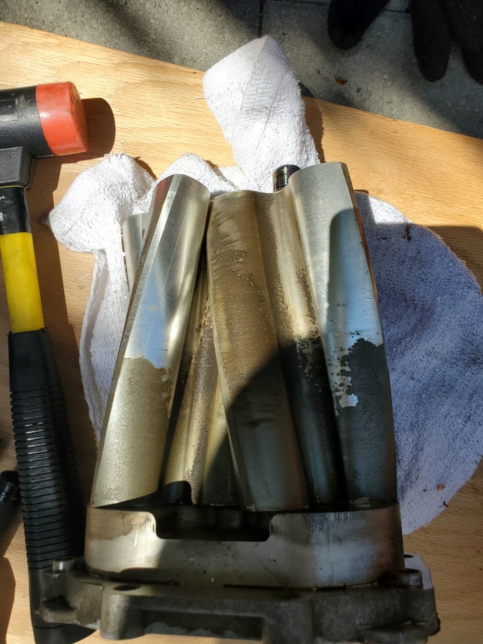

  18. Jul 16, 2020 at 2:18 PM
    #2158
    robblacktpre03
    robblacktpre03 03 Tacoma Restore time
    Jan 7, 2012
    #70181
    609
    Rob
    San Francisco, CA
    03 black pre runner
    k&n air filter, throttle body spacer, all pro UCA, 07 gun metal TRD FJ rims, blacked out interior trim
    I was in the middle of rebuilding my supercharger assembly. I realized the coating on the rotary assembly is looking rough. Is there a good company that I can get a replacement rotary assembly or send it in and get it back in a reasonable amount of time. I live in the bay area.
