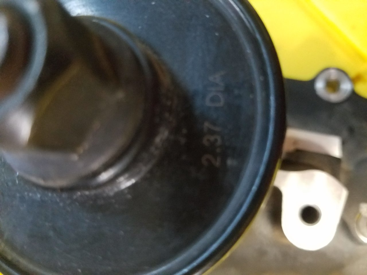

    Guess i should have checked my pulley size to confirm it. I thought it was a 2.2 untill tonight. It's a 2.4. Even more reason to step up to a 2.1.

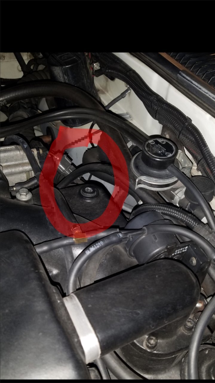

    @1997tacomav6 were did you decide to put post charge air temp sensor?

    One temp sensor will be in between the throttle body and MAF, actually next yo the MAF, the other temp sensor will be in one of the casting plugs that the grey supercharger has. There is a hex bolt that can be taken out on the hot side going into the intake and the sensor can be installed there,

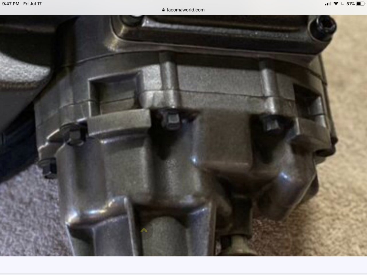

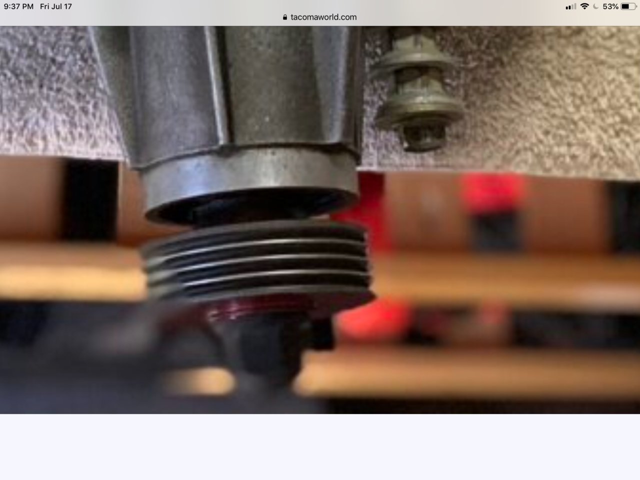

    Over the past week or so I’ve read through this whole thread, as well as the rebuild thread, and a few others; lots of great information and many thanks to all participants!
    I recently picked up a gen 1 supercharger that the seller said was rebuilt and only had about 25 miles on it. The story is long winded so I won’t trouble you all with that, and he seemed to be a straight shooter, I didn’t feel like he was dishonest or anything of the sort. With that said, I am of the mind to “trust, but verify”.
    While I have the unit on my bench what are some things I should look at? How can I verify this supercharger is ready to be installed and up for at least 100,000 mile service cycle?
    I am not opposed to sending it off for a rebuild, as I don’t have enough space or a press to do it on my own, but if it is as fresh as the seller said it is I’d be really happy. Just need to know how to verify things.
    I have ordered a bunch of stuff to try and get things done right on the first go:
    Hardware Kit
    Dynamic Tensioner
    Innovate PSB-1 Wideband AFR / Boost Gauge
    URD 7th Injector
    Snow Performance Stage 2 Methanol Injection Kit w/ VC-50 controller
    URD 2.2 Pulley
    URD Tensioner Pulley
    URD Crankshaft Pulley
    DT headers
    Gates Belt
    Here’s a picture of the unit. It looks to be in great shape to me, but I don’t really have experience to back that feeling up. Look forward to any and all thoughts from those of you with more experience!

    1) you can turn the supercharger over and open up the oil fill plug and look to see what color the oil is.
    If it’s black that means the supercharger has some miles on it, if the supercharger has 25 miles it should look like new oil, old supercharger oil will stink something bad.
    2) the pulley shown is either on backwards or it not tighten down, the gap look too large from the snout
    to the pulley lip.
    If so the belt will be out of alignment.
    3) the rotor pack plate looks to be the original plate, typical these plates get replaced when a rebuild is done but not always.
    A rebuild can mean a lot of different things.
    One person will say a rebuild is replacing a few bearings maybe just the snout bearing.
    A full rebuild is ALOT more than that,
    Did the owner say who did the rebuild and what was done?
    StevenP[QUOTED] likes this.

    Thanks for the response John.
    I was thinking the oil would be the first check as well, since it’s easy and straight forward. I’m curious if I should try and get further into the internals and have a look, or if that would just invite problems since I don’t really have the means to rebuild myself. Have you ever cracked yours open yourself, or have you always sent it off? I’m mechanically inclined and wouldn’t be scared of the job if I had a press and a decent work area, but I don’t.
    The pulley definitely looks out of sorts. All the examples I have seen here show it much more snugged up. I have the URD 2.2” pulley to replace it in any event, and will be taking care to make sure things line up well when install time arrives.
    Hard to tell with the rotor pack plate since its all been painted, I’ll take a closer look at it tomorrow and see if I can spot anything that might tell me one way or the other.
    I believe the guy had “the rebuild” done local to him. In a nutshell he had another supercharger he had sent out of state to have rebuilt with all the bells and whistles, he was having a hard time getting any updates from them, so after about 6 months of waiting he bought another supercharger (this unit) and took it to a local shop. The same day he installed this unit the one he had sent out showed up. So he swapped them since the other had more into it, and kept this around as a spare. He has some sick dogs and needed some quick money so up for sale it went and I snagged it.
    I’m thinking it was probably not a full rebuild at this point. But at the very least I’ll take a peak at the oil before I start jumping to any conclusions.
    1997tacomav6[QUOTED] likes this.

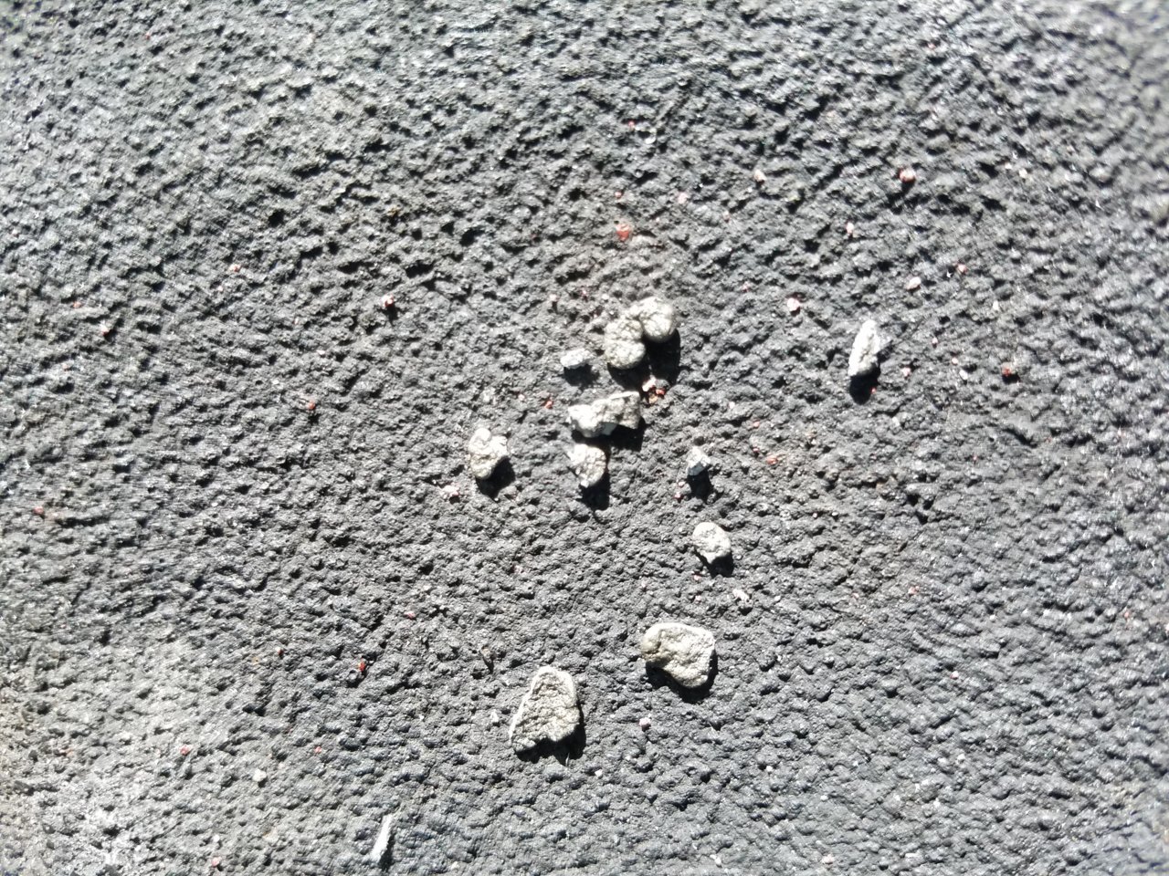

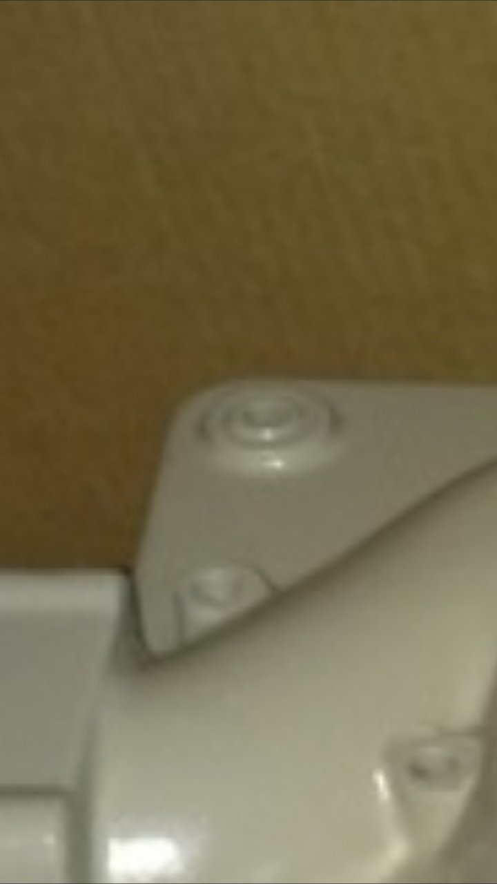

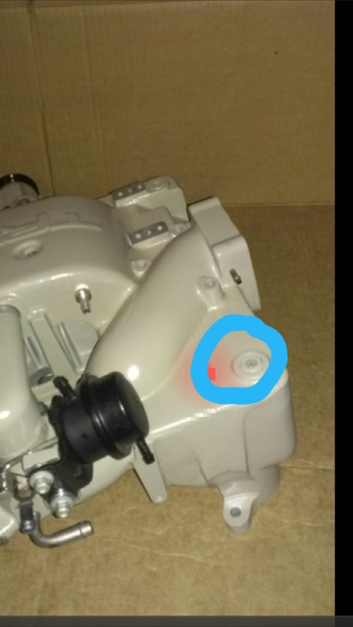

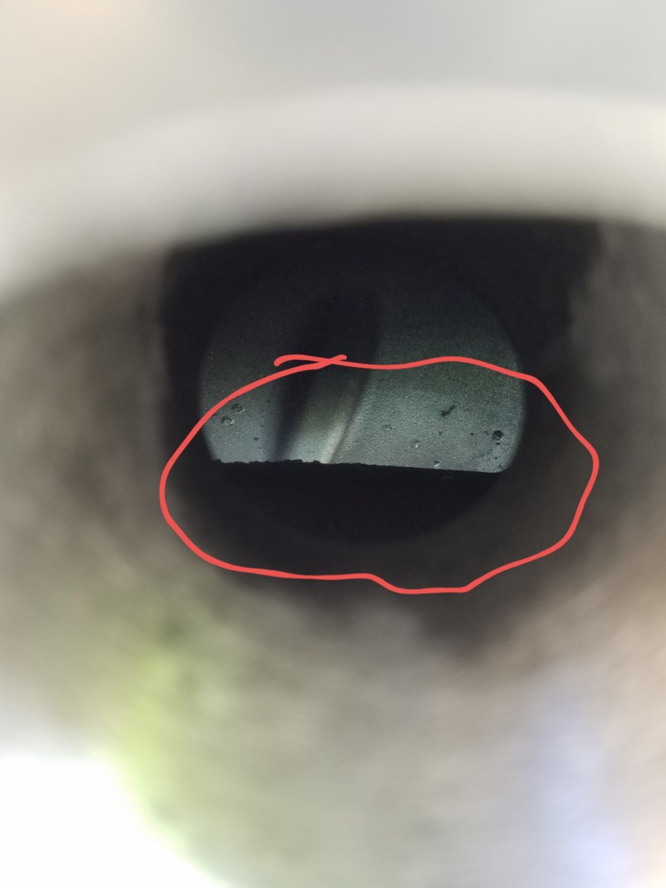

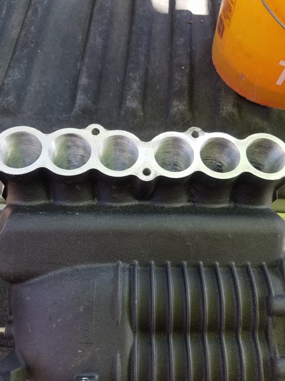

    Anyone with the black 2nd generation design supercharger may want to check this the next time you have it off.
    While cleaning up mine today and doing a little smoothing of the runner castings. I found this slag at a casting seam in the supercharger. You could see it while looking in #2 & #3 runners. It knocked off super easy with a screwdriver. Eventually it would have come loose and ate up a cylinder or two. It was easy to see with a flashlight. Easier to see with rotors out and light from the rotor pack area back lighting it If you do have it. Best to pull rotor pack to retrieve all the pieces you knock off. It wasn't in the runner itself but farther inside.
    1997tacomav6 likes this.
