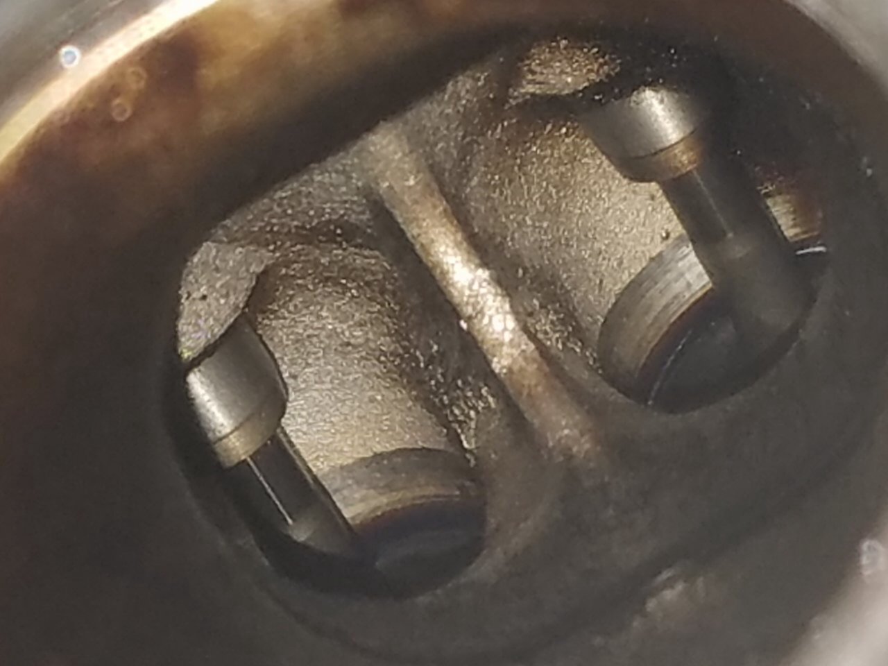

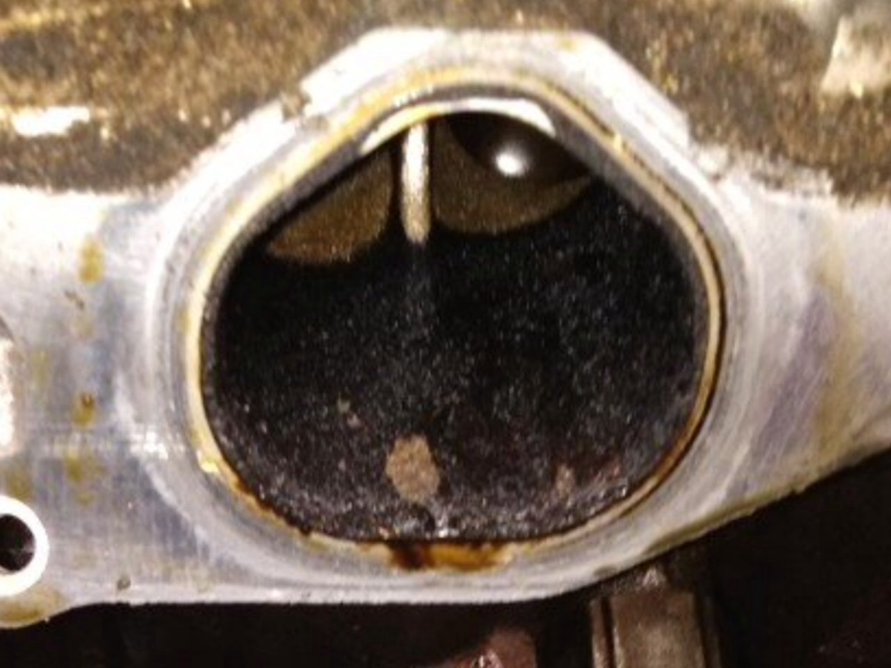

    Today is your supercharger install day?
    Make sure the mechanic takes a photo of your intake valves so you know what carbon build up you have.
    These are mine because of the methonal they are squeak clean and another 3.4 that has issues

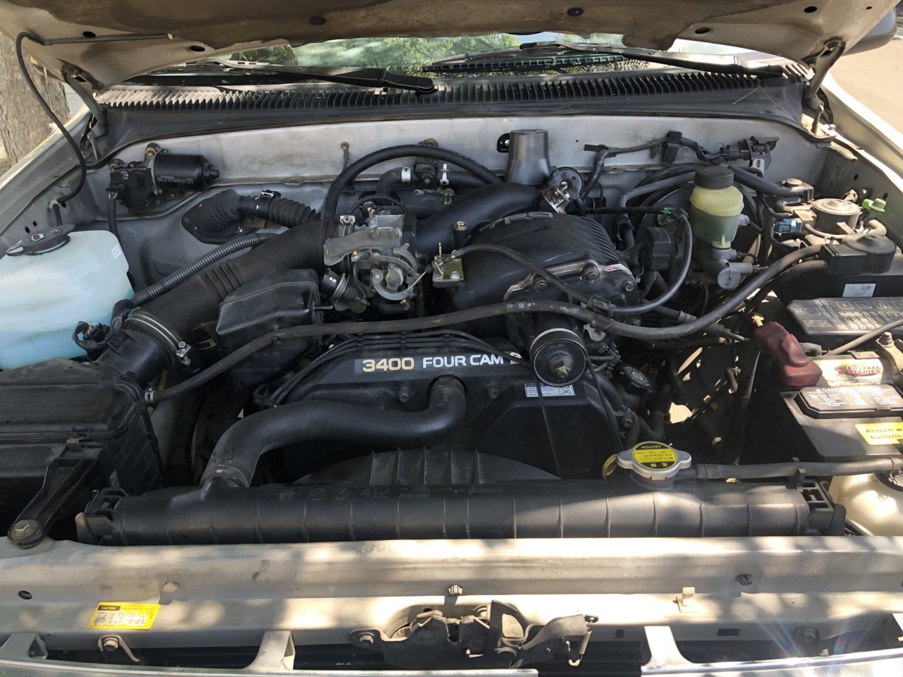

    The supercharger is on. No ping. And no ping. when the mechanic test drove it, no ping right off the bat So, it seems like everything is running as it should. Thank you everybody. Thank you John! The power is noticeably more. The sound is addictive. ​
