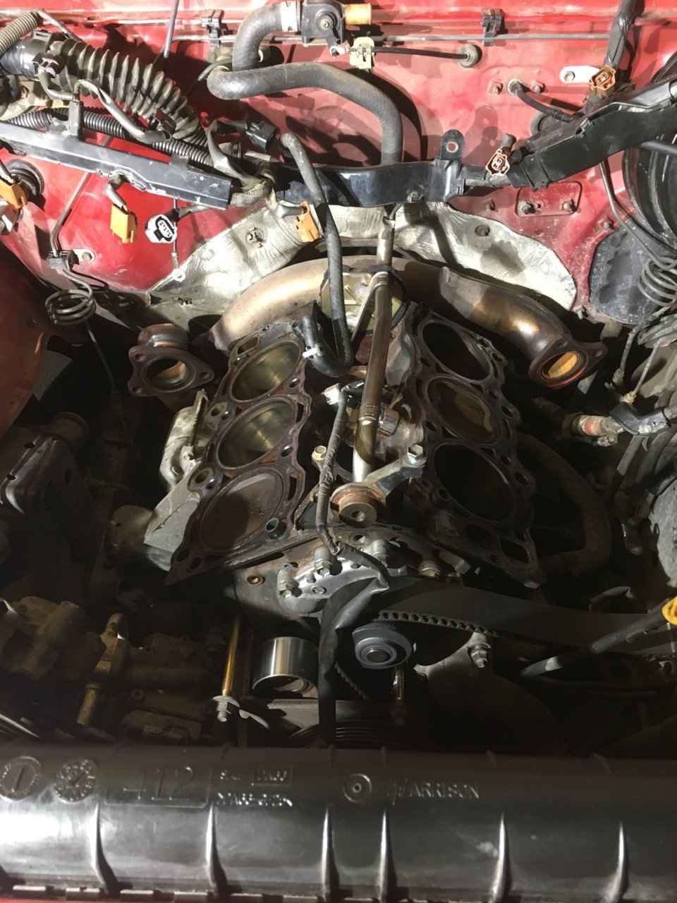

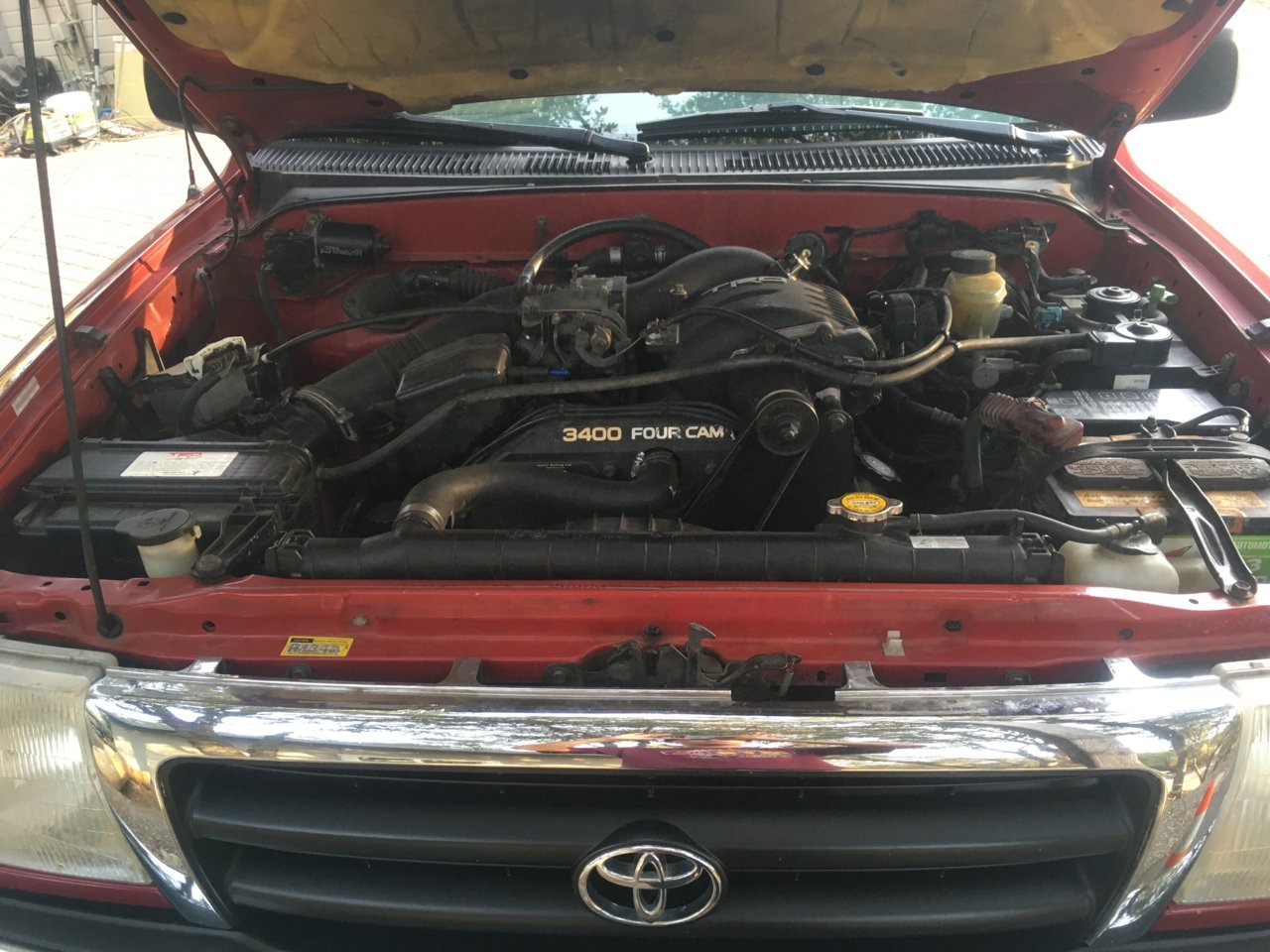

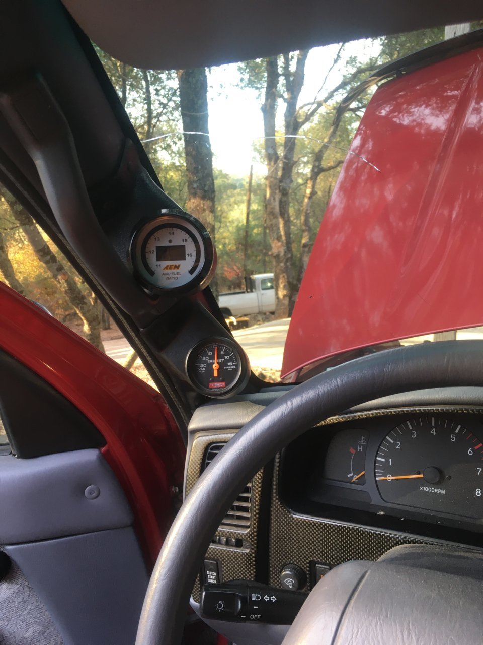

    So that was a fun ride, finally finished my head gasket. Got the heads machined and valves done. Put it all together and only forgot the coolant temp sensor for the gauge cluster. Afr gauge installed as well and afr's are ~12 at WOT (everywhere else is trying for 14.7). Couldn't be happier and she runs like a top. Round hole throttle body gasket added about 1 psi too. Only took about 2 months :D. Not pinging either, though elevation might be helping with that. Now onto the next part of the ever going project... aem fic6!
    AFR gauge installed with grab handle still usable.
    Bare block once I got the heads and everything else off.
    All finished, got a bath too!

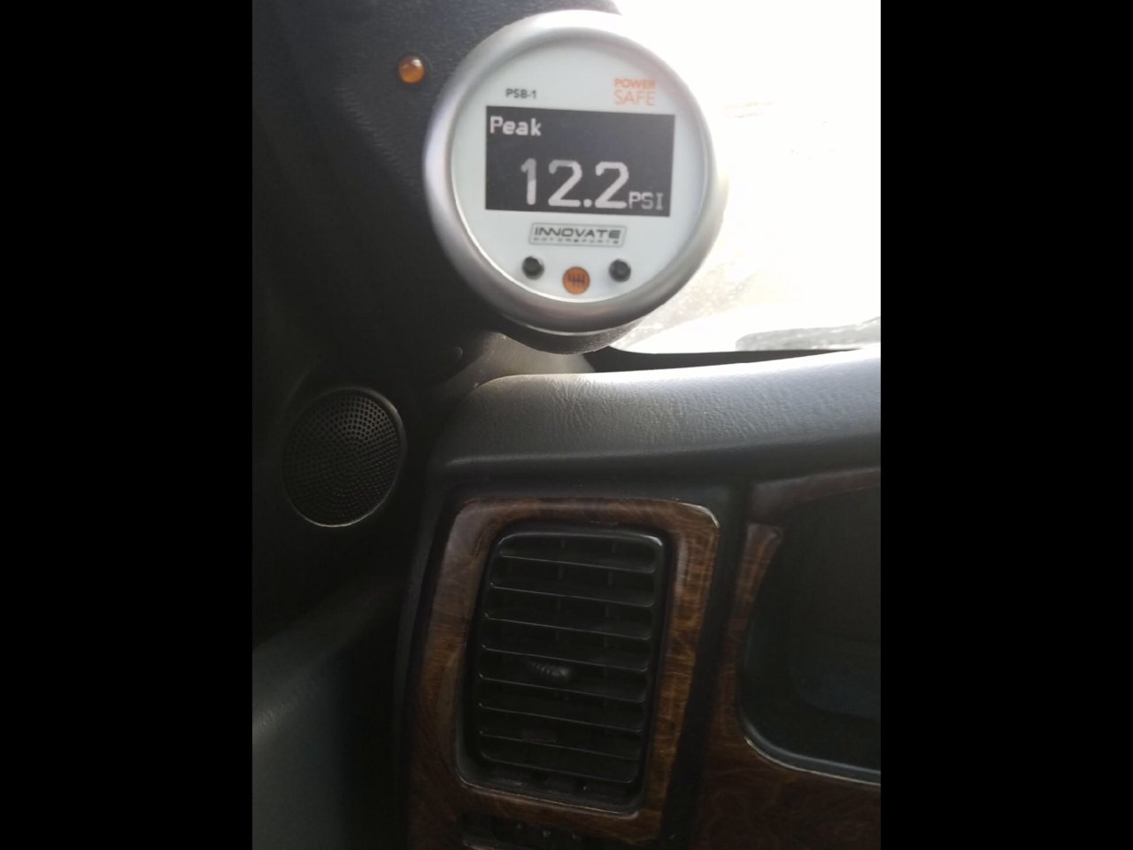

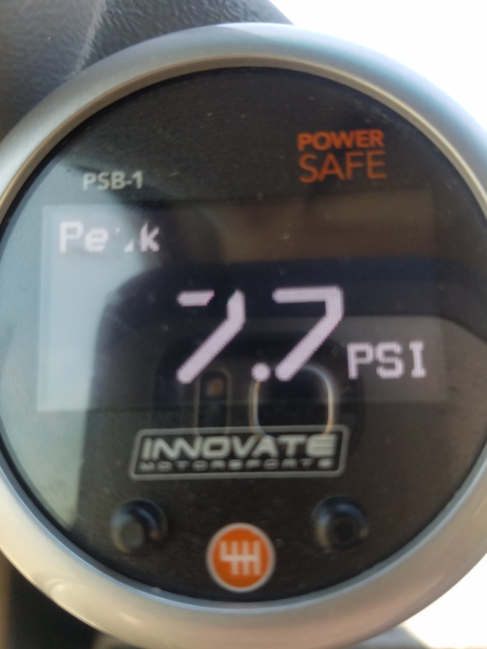

    Amazing what 171' above sea level will do.
    Normally I'm in the 5's. Seen 6.0lbs once.
    Today in Yuma Az 118 degrees 171' above sea level. Stock pulley.
