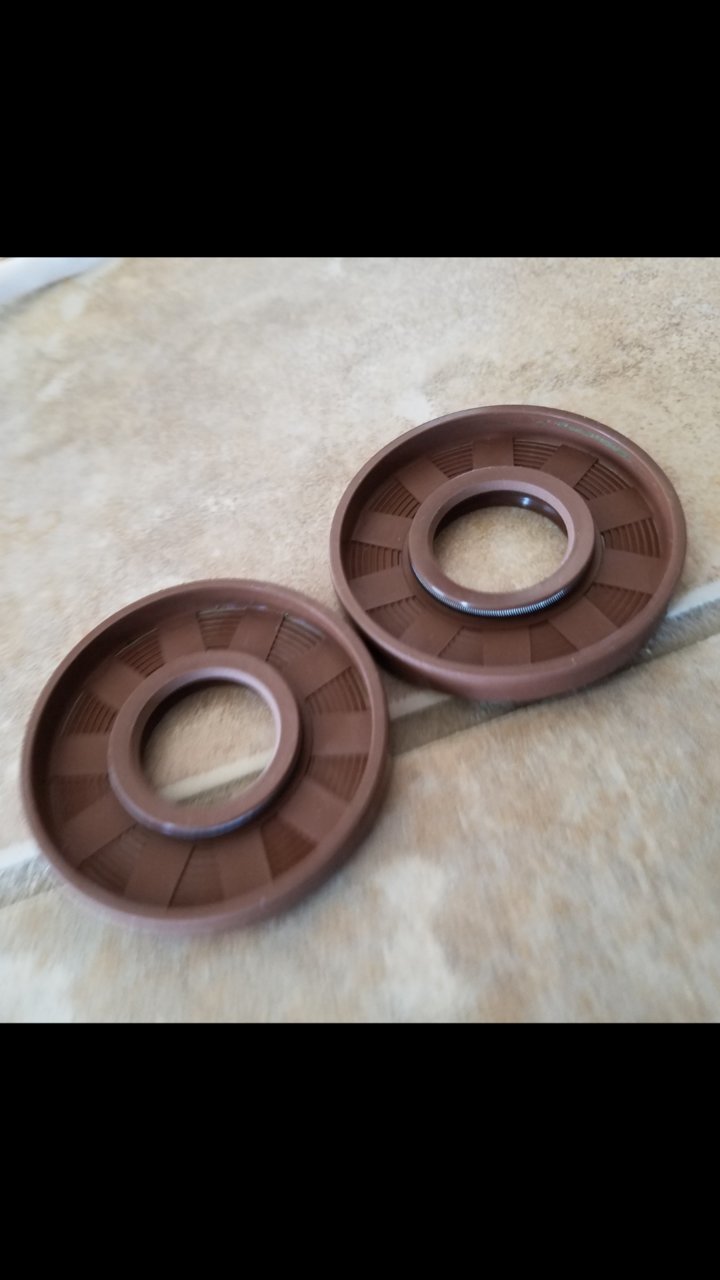

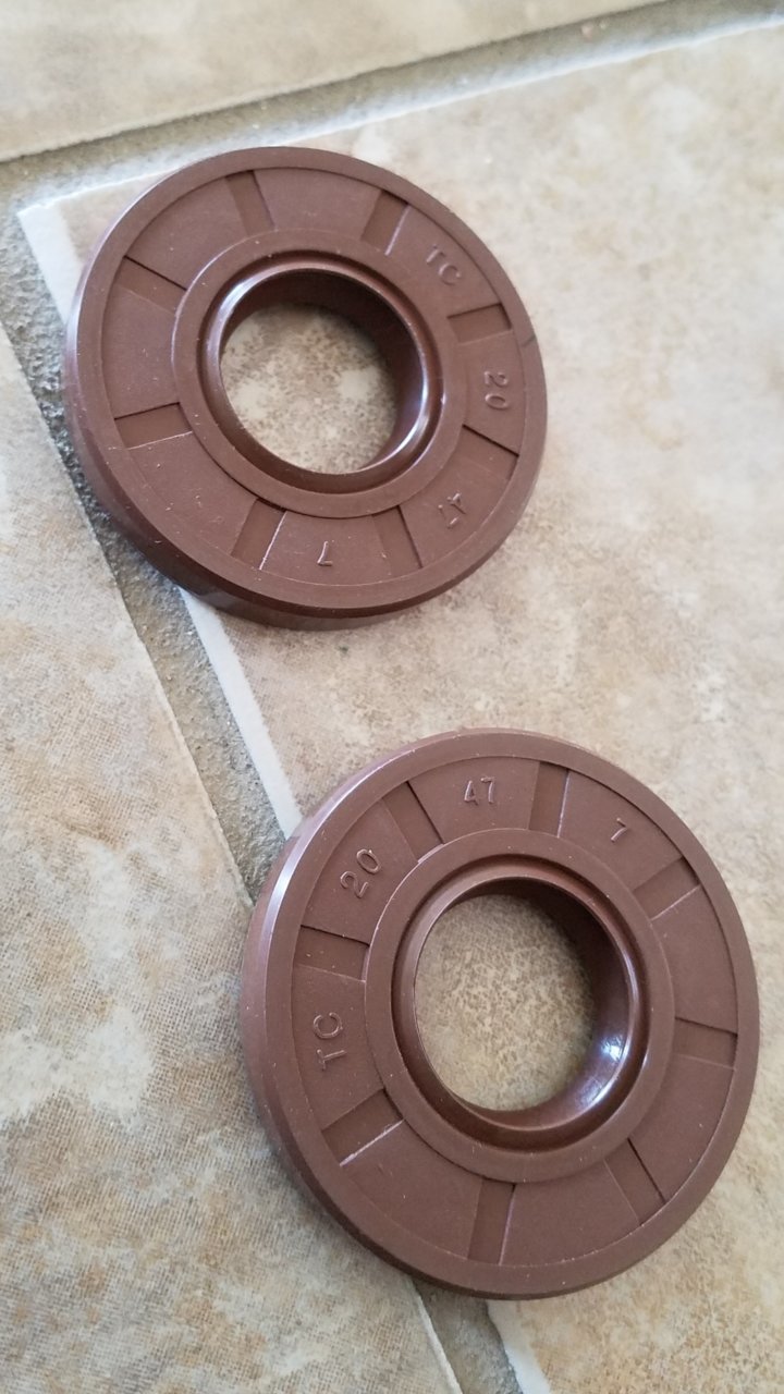

    I didn't replace those. Just the nose cone bearings and rear rotor support bearings.

    The rotor pack bearing are what fail on me 1st

    I have a 10th of the miles you do so if mine last another 100k I'm good with that! I think my snout shaft has some imperfections where the lip seal rides, I still get a tiny amount of oil coming from there.

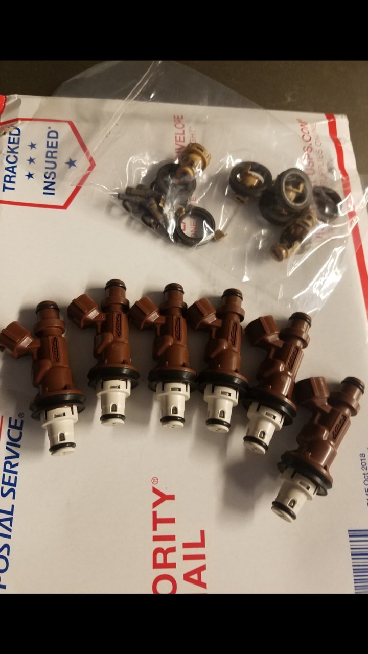

    Something I did and recommend STRONGLY is if you have 200k miles on your fuel injectors its time to get them cleaned and serviced even if everything is running fine.
    The fuel injectors actually have a filter in them that gets plugged over time and the spray pattern becomes defective,
    Motor west did mine for around 125.00 with 2 day turn around.
    The new power I have from 3500 rpms up is an amazing difference. If you have the supercharger off its an easy job.

    I have a 2.0 pulley and the Viton nose cone seal.

    YOU actually DONT need to even break the fuel line apart as most videos show.
    You can actually just disconnect the back fuel line rail bolt and and other rail bolts and lift the complete rail up and remove the injectors out from under the rail.
    This way you have a less chance of a fuel leak from the bango bolts and crush washers if you went that route

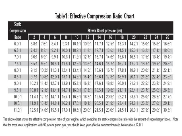

    Just a little info: Stock 3.4 is 9.6:1

    Octane booster should be used with anything over 4 lbs of boost unless you can find higher than 92 based on this.

    At given compression ratio of 9.6:1 which is stock 3.4 compression. By adding pressure/boost into the cylinder it in effect raises the compression ratio in the cylinders. So at lets say 10lbs of boost it raises compession ratio to ~16:1 compression ratio.
