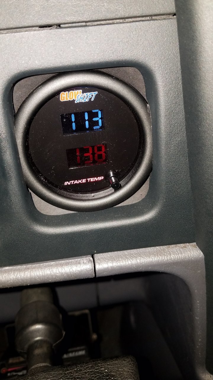

    HOT! I haven't checked them since I stepped up to the #3 nozzle. I have to program the temp sender values into the AEM program to read it. There's only one aux input for fic6. Right now I have it switched to wideband readings. Before when I was running a #1 nozzle I was around 180-220 running hard in boost @115 ambient air temp and 190 water temp.
    My dam IAT sensor in the MAF will hit 160 idling at a light.
    1997tacomav6 likes this.

    Holy crap 160 from the IAT sensor is nuts. Even with our 110+ degree days I haven't seen my IAT read over 125. I don't know if maybe my snorkel helps by pulling air from directly outside rather than the wheel well closer to the ground

    I'm thinking some of it might be from my inner fender skirts not being that good. Letting air from engine compartment escape into wheel well. I have the materials to cut new ones, just haven't done it.

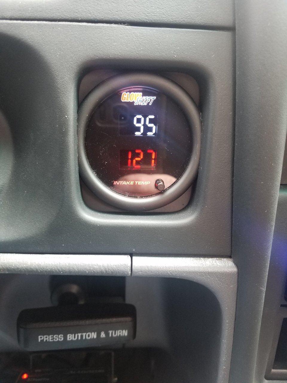

    I don’t have any skirts and I don’t get that high. But it’s also rarely over 98 here.

    V6 5sp,RegCab,TVS1320 Supercharger, 56mm pulley, methanol injected Haltech ECU, AC Tvs1320 supercharger,(MUST DO) every 125,000- 150,000 needs rebuild Projector headlights HID 5 speed manual Amsoil for all drive train Smaller 56mm custom pulley, (MUST DO) 2004 DESNO fuel injectors, zero ping ping, 2004 side door mirrors Dick Cepek Rims, Michelin tires LTX, ATM Pathfinders Dynopro ATM ( that last 100,000 miles) Now running Dynopro ATM mud and snow tires KN cold air intake Cat back dual exhaust with ss exhaust tip, Raised exhaust tail pipe to 2" below body line Optima*dry cell battery,red top Alpine sirius radio, 200 watt amp, focal is165 split door pod speakers Focal door speakers Subwoffer behind seat Viper alarm, Electric Locks Dark tinted windows, bucket seats corbeau lg1 Tacoma Rubber floor mats TRD fender extenders, Bilstien shocks, King shocks JBA UCA trailer iv hitch, electric brake control, Drilled slotted brakes, High carbon steel (MUST DO) EBS green stuff 7000 series pads(MUST DO) TRD engine oil cap TRD stick shift, Marlin crawl shift kit. Rear sliding window 2002 4Runner functional hood scoop cut into Tacoma hood, 4Runner dual overhead map light Gentex Auto dim + Compass + Temp, garage,rearview mirror Snow Methonal kit stage 2 Custom 3 core aluminum radiator Linex bed liner Haltech stand alone ECU, Intake supercharger gauge. Stainless steel brake lines, Custom leather wrapped steering wheel, Haltech stand-alone ECU,
    yep that’s hot,
    That’s at 5-6 pounds of boost too?
    10 pounds of boost would be ALOT hotter.
    Just curious why you don’t have a dedicated guage for your supercharger temperatures that you can see all the time?

    That's in the works. I wanted to be able to log my temps. That's why it's tied into my fic/6.
    6psi boost
    What's your highest temp?

    So far 185 degrees with 11 pounds of boost on the hot side going into rhe engine with outside temperatures around 100 degrees at WOT.
    With temperatures this hot outside not really pushing it to much tho.
