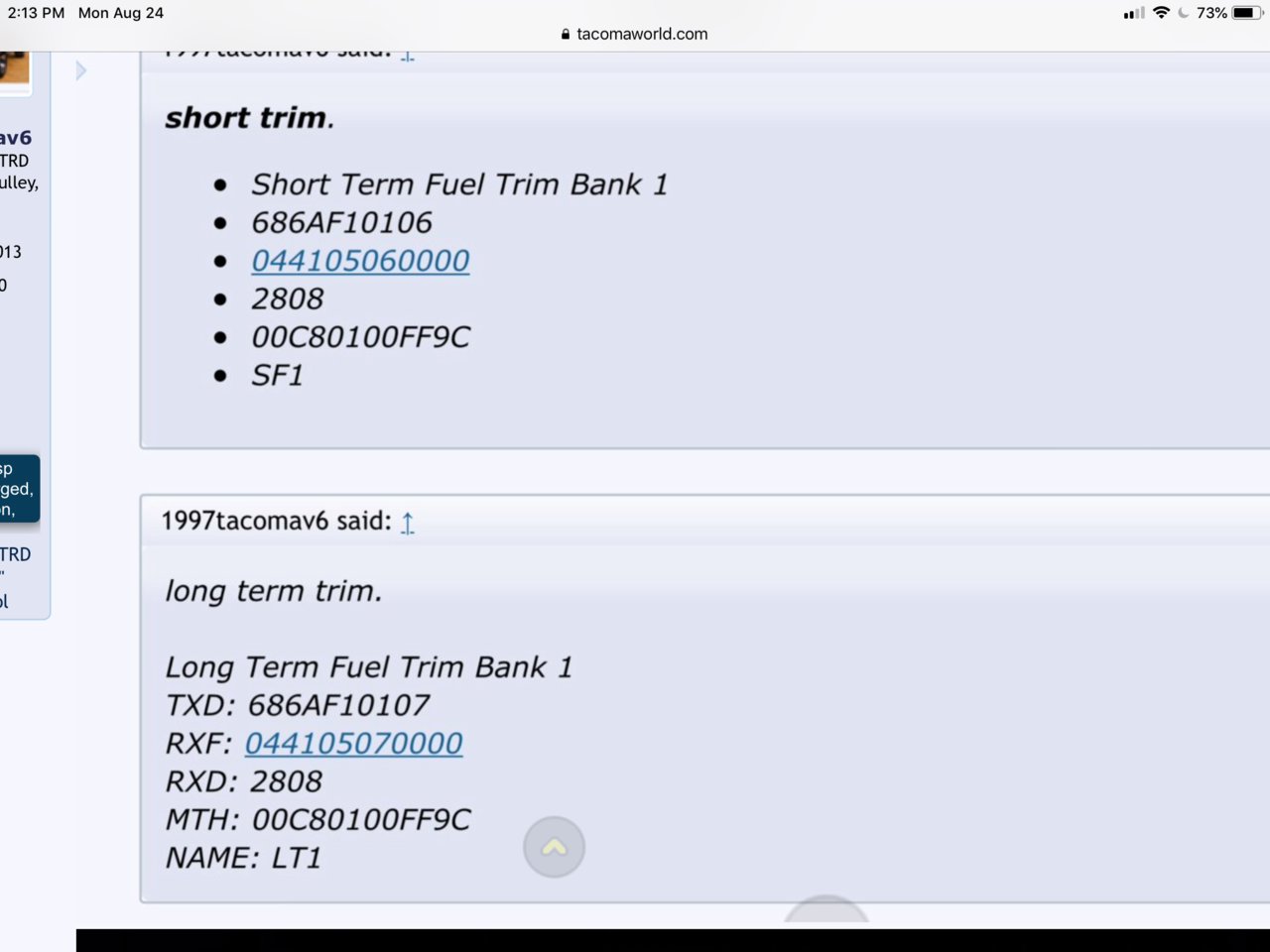

    V6 5sp,RegCab,TVS1320 Supercharger, 56mm pulley, methanol injected Haltech ECU, AC Tvs1320 supercharger,(MUST DO) every 125,000- 150,000 needs rebuild Projector headlights HID 5 speed manual Amsoil for all drive train Smaller 56mm custom pulley, (MUST DO) 2004 DESNO fuel injectors, zero ping ping, 2004 side door mirrors Dick Cepek Rims, Michelin tires LTX, ATM Pathfinders Dynopro ATM ( that last 100,000 miles) Now running Dynopro ATM mud and snow tires KN cold air intake Cat back dual exhaust with ss exhaust tip, Raised exhaust tail pipe to 2" below body line Optima*dry cell battery,red top Alpine sirius radio, 200 watt amp, focal is165 split door pod speakers Focal door speakers Subwoffer behind seat Viper alarm, Electric Locks Dark tinted windows, bucket seats corbeau lg1 Tacoma Rubber floor mats TRD fender extenders, Bilstien shocks, King shocks JBA UCA trailer iv hitch, electric brake control, Drilled slotted brakes, High carbon steel (MUST DO) EBS green stuff 7000 series pads(MUST DO) TRD engine oil cap TRD stick shift, Marlin crawl shift kit. Rear sliding window 2002 4Runner functional hood scoop cut into Tacoma hood, 4Runner dual overhead map light Gentex Auto dim + Compass + Temp, garage,rearview mirror Snow Methonal kit stage 2 Custom 3 core aluminum radiator Linex bed liner Haltech stand alone ECU, Intake supercharger gauge. Stainless steel brake lines, Custom leather wrapped steering wheel, Haltech stand-alone ECU,

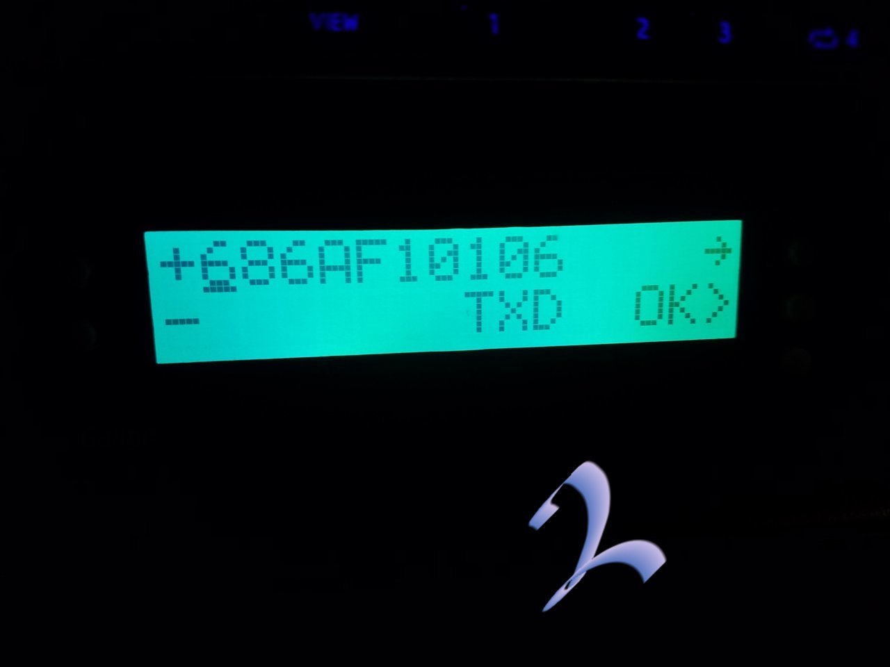

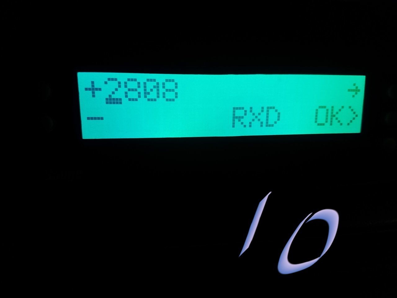

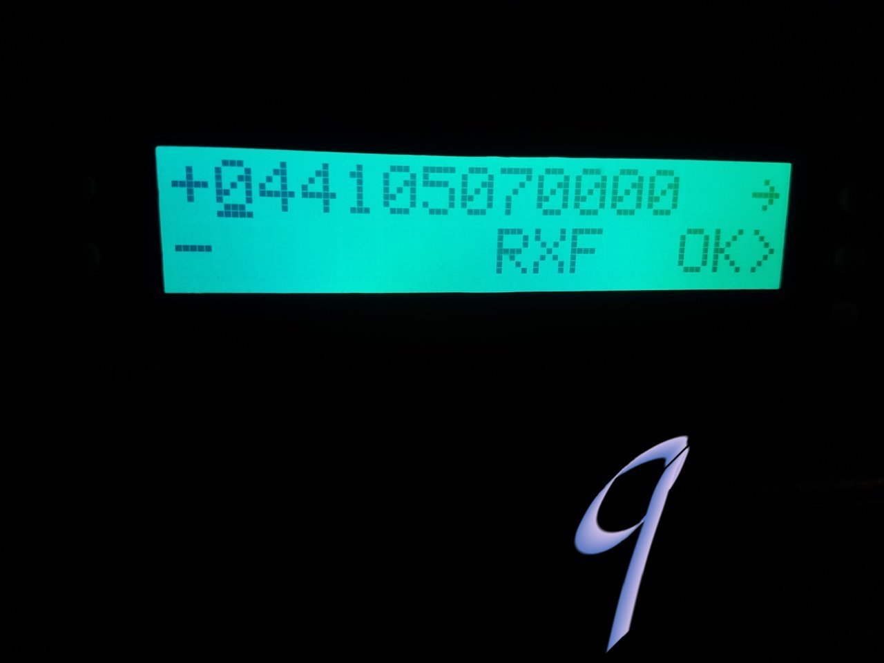

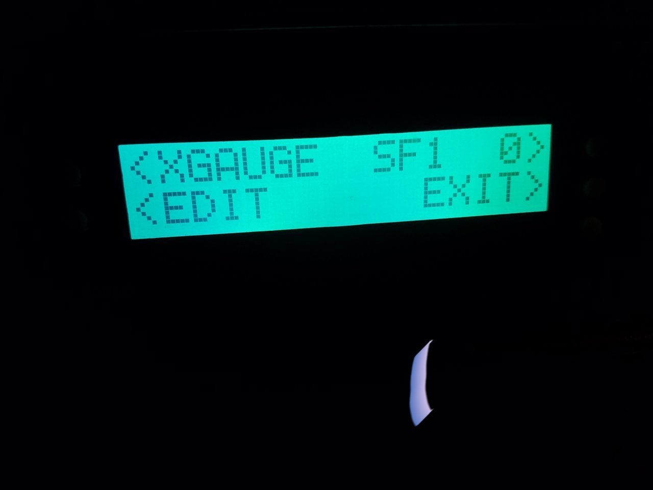

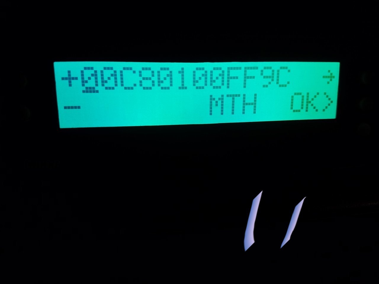

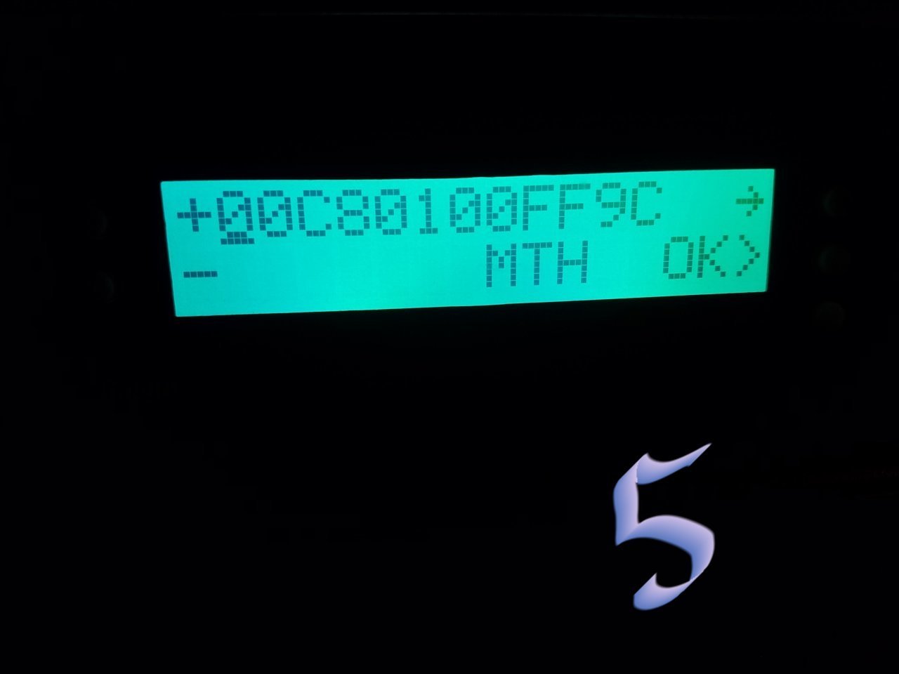

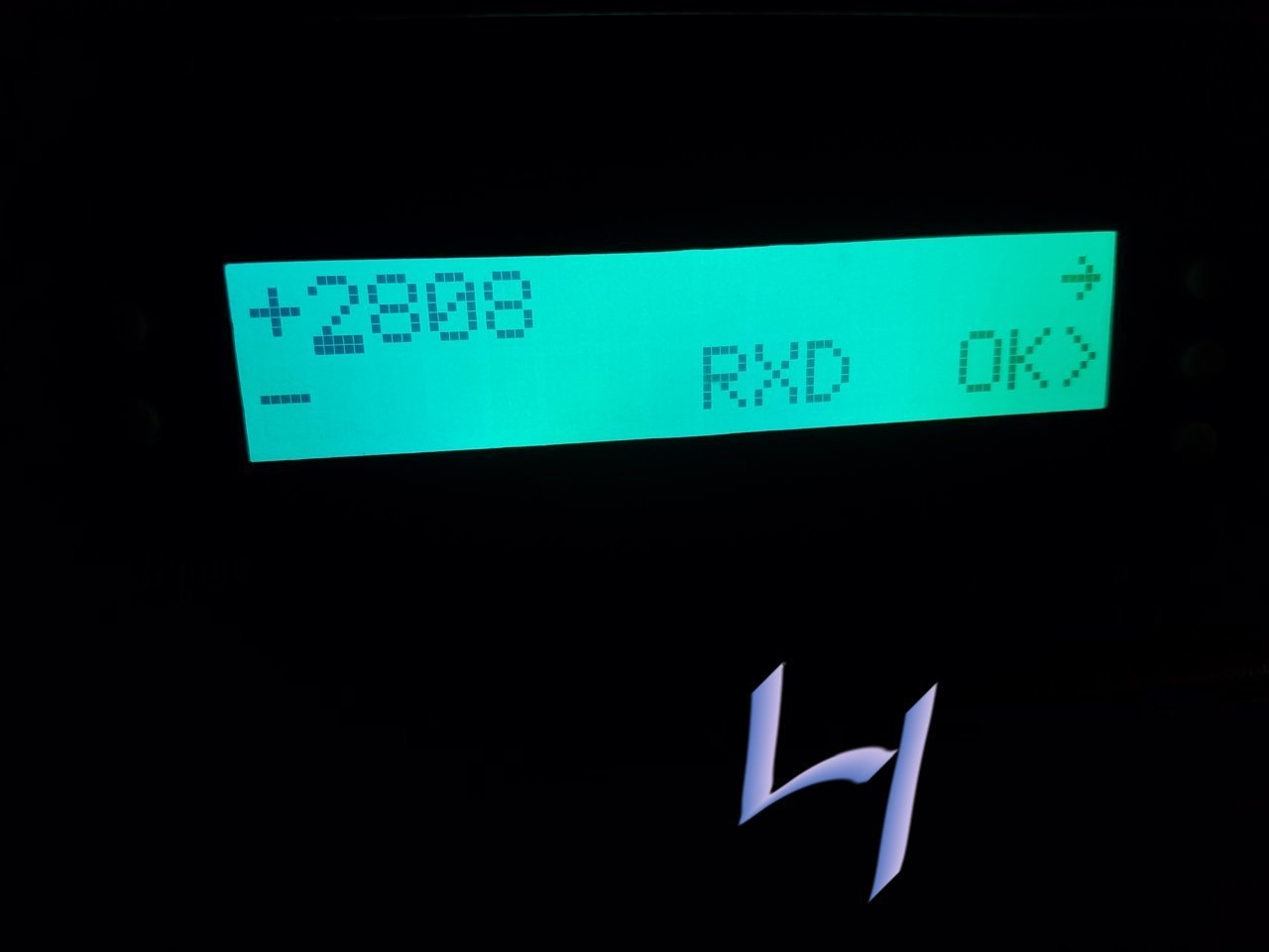

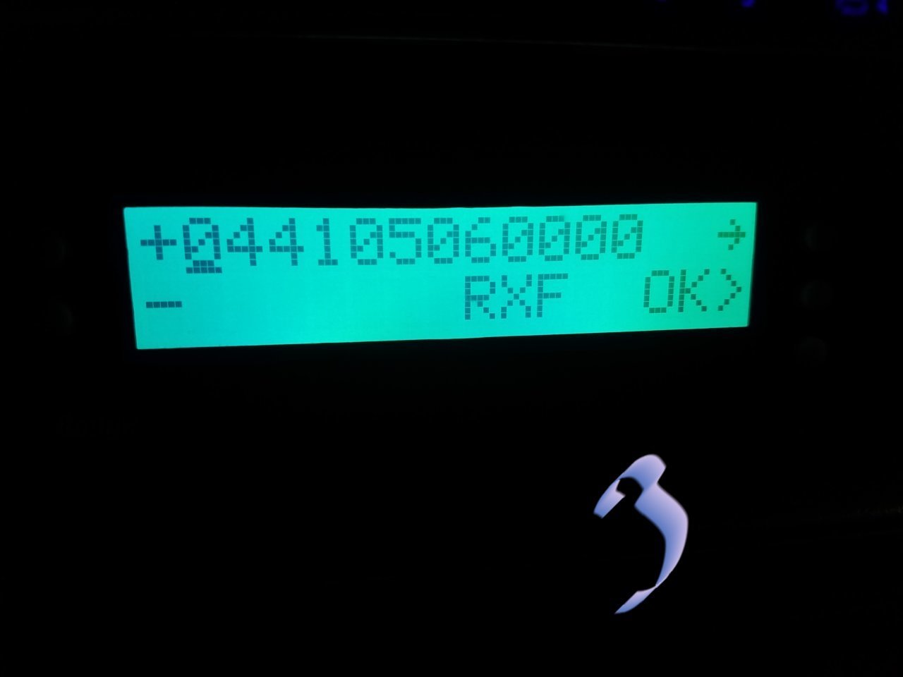

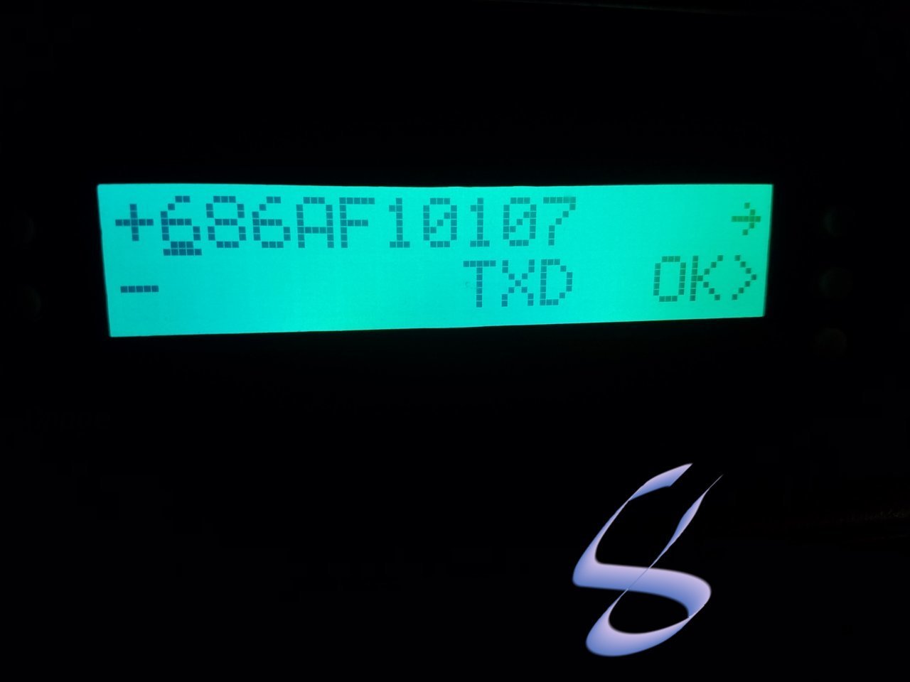

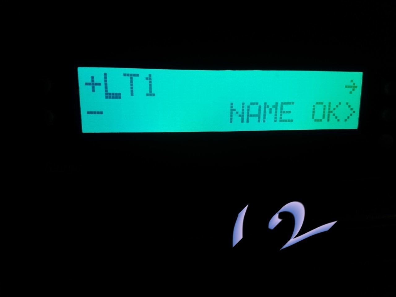

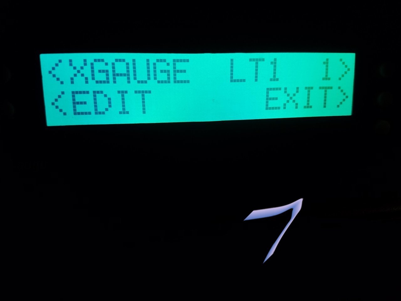

    This is the xgauge coding you need for the scanguage to get long and short trim value
    mechanicjon and eon_blue[QUOTED] like this.

    Makes me miss just using the Torque App on my phone with the OBDII connector...all that info just popped up on the app without having to plug in a bunch of crap lol.
    But the Scangauge is nice because it's always on and don't have to rely on my phone and draining the battery.

    I agree, it actually should already be programmed in there but I guess there are so many different settings,
    Yup the info is there all the time if you want and can be cycled out for timing or something else.
    But once it’s program in it stays there even if the battery is disconnected

    Thanks! Ill try after "work" today. However, I'm not sure it will work with my '02. It uses ISO protocol and it wont even spit out MAP readings. It only spits out MAF.

    The scanguage doesn’t show MAP or MAF info that I’m aware of,
    The program numbers shown before has to be programmed into the scanguage, xgauge, to work to shown the long and short term trims for the 3.4 motor

    It supposedly shows MAF.
    I got this from Mfr this morning:
    We do have one XGauge code for Toyotas that use the ISO mode. Please try
    the following code and let me know if it reports.
    Mass Air Flow
    TXD: 686AF10110
    RXF: 044145100000
    RXD: 2810
    MTH: 000100010000
    NAM: MAF

    Stoopid question:
    Is Short trim and Long trim the same as Narrow band and Wide band? Are they ratios?

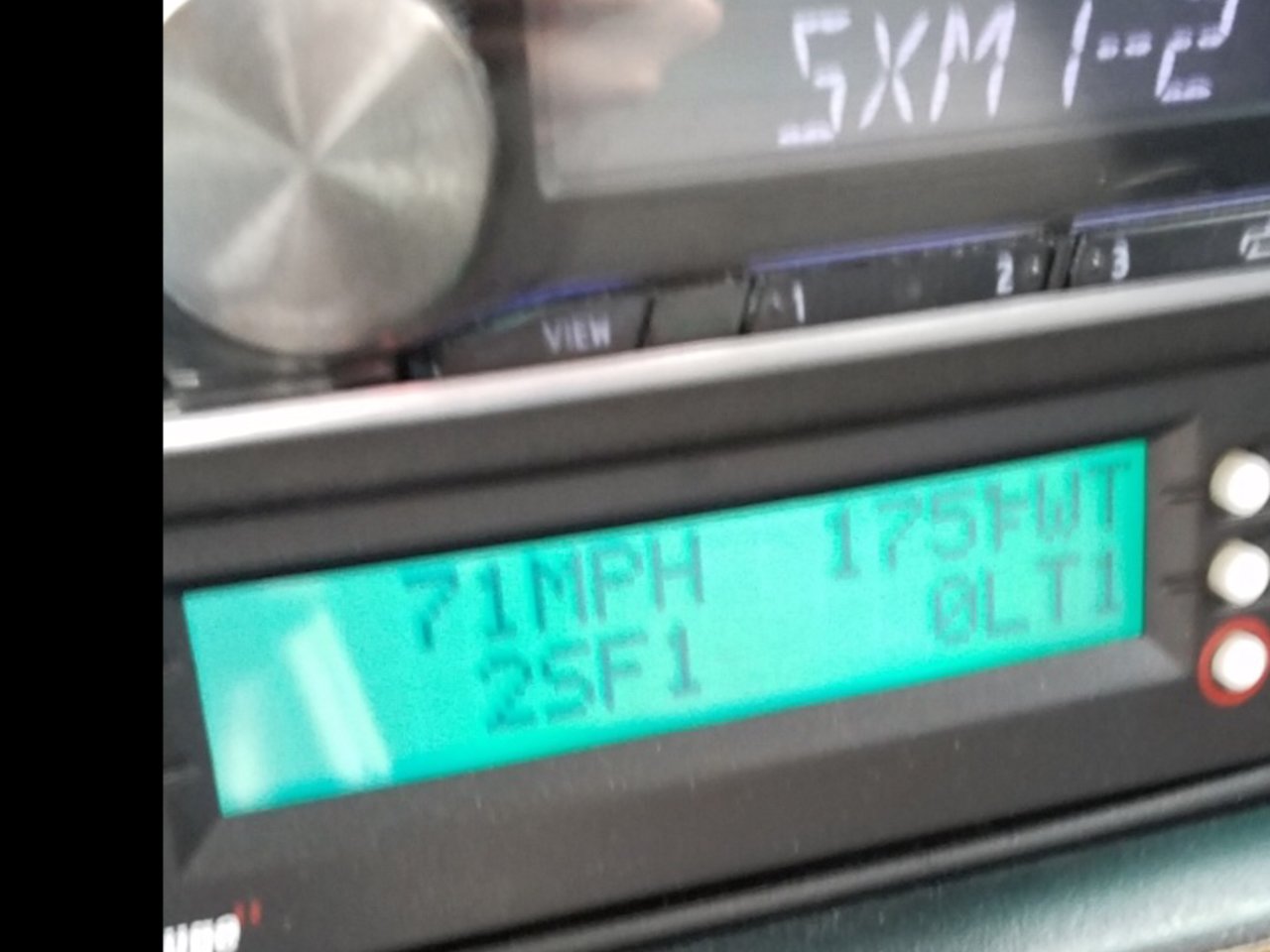

    Fuel trim numbers are actually great to have because they will show you a problem before it actually becomes a bigger problem later.
    You can monitor the health of your engine this way

    So..
    My Short trim is 0 +/- at all RPMs
    My Long trim is +16 +/- at all RPMs
  18. Aug 24, 2020 at 5:44 PM

    I guess I gotta go chase a vacuum leak. It's not an unreasonable assumption. Even though everything is hooked up correctly, this rig has 200k miles and doing the SC install moves a lot of old, dry hoses around.

    It might be easier to just replace all the vacuum hoses, check pcv valve too and hose to the driver valve cover,
    Again ANY vacuum leak is going to be a problem for a superchargers performance
