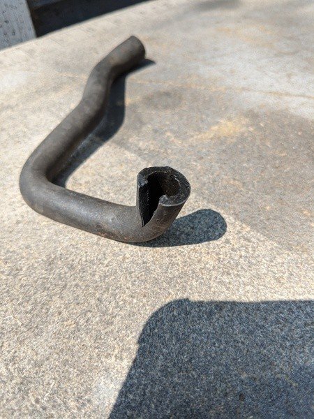

    Searched for vacuum leaks and found none. Now I have a CEL with a P0107 code. Crap. Why did it work perfectly for 1000 miles then start acting up?

    P0171 Or P0107?
  14. Aug 26, 2020 at 6:45 AM
    #2334
    Shape-Shifter
    Shape-Shifter Well-Known Member
    Jul 28, 2019
    #300502
    100
    Todd
    Elizabeth, CO
    Right its a P0171. Not 107
  15. Aug 26, 2020 at 7:04 AM
    #2335
    1997tacomav6
    1997tacomav6 V6 5sp,RegCab,TVS1320 Supercharger,Haltech, 800k
    Oct 5, 2013
    #113940
    10,379
    John
    Denver
    97 reg cab, v6 5sp 300hp supercharged, Methonal Injection, 800,001 plus miles, Original Owner
    V6 5sp,RegCab,TVS1320 Supercharger, 56mm pulley, methanol injected Haltech ECU, AC Tvs1320 supercharger,(MUST DO) every 125,000- 150,000 needs rebuild Projector headlights HID 5 speed manual Amsoil for all drive train Smaller 56mm custom pulley, (MUST DO) 2004 DESNO fuel injectors, zero ping ping, 2004 side door mirrors Dick Cepek Rims, Michelin tires LTX, ATM Pathfinders Dynopro ATM ( that last 100,000 miles) Now running Dynopro ATM mud and snow tires KN cold air intake Cat back dual exhaust with ss exhaust tip, Raised exhaust tail pipe to 2" below body line Optima*dry cell battery,red top Alpine sirius radio, 200 watt amp, focal is165 split door pod speakers Focal door speakers Subwoffer behind seat Viper alarm, Electric Locks Dark tinted windows, bucket seats corbeau lg1 Tacoma Rubber floor mats TRD fender extenders, Bilstien shocks, King shocks JBA UCA trailer iv hitch, electric brake control, Drilled slotted brakes, High carbon steel (MUST DO) EBS green stuff 7000 series pads(MUST DO) TRD engine oil cap TRD stick shift, Marlin crawl shift kit. Rear sliding window 2002 4Runner functional hood scoop cut into Tacoma hood, 4Runner dual overhead map light Gentex Auto dim + Compass + Temp, garage,rearview mirror Snow Methonal kit stage 2 Custom 3 core aluminum radiator Linex bed liner Haltech stand alone ECU, Intake supercharger gauge. Stainless steel brake lines, Custom leather wrapped steering wheel, Haltech stand-alone ECU,
    Can be a bunch of things,
    Exhaust leak before 02 sensor,
    Bad 02 sensor,
    vacuum leak, maybe do a smoke test, brake booster leaks sometime,
    fuel injectors,
    Fuel pump,
    MAF sensor, dirty or defective,
    Fuel filter,
    Bad PCV valve,
    and so forth,
    If you have a scanguage you can get more information to help find your problem Looking at fuel trims
  16. Aug 26, 2020 at 7:09 AM
    #2336
    Shape-Shifter
    Jul 28, 2019
    #300502
    100
    Todd
    Elizabeth, CO
    Well this one was easy. The PCV hose is split at the SC end. I guess when I was searching for vac leaks I wiggled that hose to make sure it had a good connection and that must have been enough to split the old, dry hose. Already have new one ordered.
    However, Im not convinced that is the ping cause. I suspect fuel pump and/or injectors.
    1997tacomav6 likes this.

    It’s a PITA, but to do it right anyone putting on a new supercharger with an engine over 150k should
    have fuel injectors cleaned and serviced, new fuel pump, new fuel filter and then go forward before considering 7th injector, methonal, piggyback etc.
    Your fuel system has to be working 100 percent to know if you need to go to the next step.
    AGAIN, ANY vacuum leak will cause supercharger problems,
    If you have old hoses just replace them all, go to the pasts store and buy
    the hoses by the foot and cut them in

    This PCV hose seems to have been my problem. It must have been starting to split when I did the SC install. It ran perfect for 800 miles or so then started pining. The split must have been growing. I searched for vac leaks with carb cleaner and wiggled connections. That wiggle must have opend the split on the hose and I got the CEL.
    I need to drive some more but I replaced the hose with new and the pinging is all but gone.... (knock on wood). CEL cleared right away. John is right about ANY vacuum leak causing problems.
