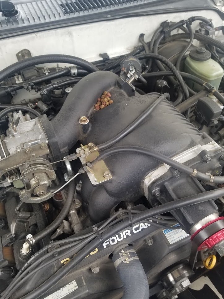

    gotta deal with this Sh*t now, found some dog food on my SC.

    Do you have a dog?

    #279080
    1,182
    yea my dog has been up at 4am trying to get the rat, just checked my cams and the rat just started hoarding food 2 nights ago
    I dont see any chewed up wires, so i hope it didnt start.
