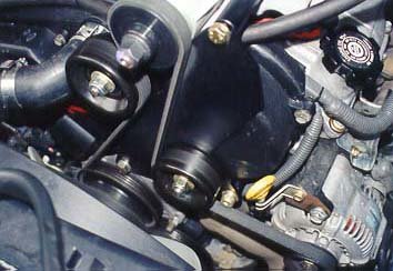

    Anyone have their old static tensioner pulley (just the pulley, I've already got the original bracket and my original pulley) lying around? I'm hoping to add it into the supercharger belt system to lessen belt slippage. Or one from cutting off the side that supports?

    Belt slippage? Do you have the newer spring loaded type tensioner. Steel or aluminum pulley on supercharger?

    Static tensioner, trying to fix the problem oem steel pulley, would rather spend less money because of my budget. People still have problems with slippage on the dynamic so I'm trying to add in the pulley between the SC and the fan pulley to increase the arc length that the belt touches for friction. I'd rather spend the money (dynamic tensioner cost) on the tool to set the belt tension correctly because you need it for the dynamic tensioner as well.
    If none of that works, I may try to convert to a 6 rib pulley at some point.

    What makes you think it's slipping. Not doubting you. Just curious what symptoms your having. People are running +10lbs with no slipping issues. How's the grooves on the pulley look? You can get by without the belt tension gauge with the dynamic tensioner.

    I'm hitting 6-7lbs of boost and running a 130 amp GM alternator off the 4 rib belt.

    I'm getting belt dust and its slightly glazed, also was getting boost drop but tightened it and it went away but would rather not tighten it any more for fear of wearing the bearings faster, therefore if I can increase the contact patch of the belt, it does not have to be so tight and I can be 100% sure it is not slipping. Pulley is possibly worn? not sure, it is the original steel one so 200k miles on the pulley.
    To get the correct tension from the start, you still need the gauge to set the dynamic tensioner, then its good for the lifetime of that spring in the tensioner. But most can get by without the initial measuring.

    Tension on a new belt is 120lbs and 90lbs on a used belt. So it's tight!

    But our superchargers have only 4 ribs, have a very small radius pulley, and only have ~180 degrees of belt contact make it prone to slippage if not perfect or if you are going for high boost.

    hold up. There’s a belt tension spec for the dynamic tensioner? The instructions clearly say to set the alternator on the center and that’s it. How could you have both?

    Like this?

    That's what listed for the static tensioner. I don't know if the dynamic tensioner has a tension listed.

    Yes, that is the same alternator position for the dynamic tensioner also.

    yes, technically there is. Gadget at t4r had to tension it anyway. to quote: "In theory the new tensioner handles this problem for you. However, the installation guide still says that a belt tension gauge should be used to set the initial tension of the belt. The alternator can be moved in and out to adjust the belt tension on a stock engine and if it is to far in or out it will prevent the new tensioner from holding the proper tension so it must still be initially set using the gauge and from then on it should be fine. I found that with both of retrofit dynamic tensioners that I installed on my 4Runners I did have to use the belt tension gauge to properly set the tension to 80 Lbs-Ft of tension. This was even with the tension properly set with the pulley plate." Gadget owns URD btw (I believe) http://www.gadgetonline.com/Tensioner.htm
    yes, exactly like that. and if I can get a tall eared pulley it should stay on the sc well. There should be no problem with just having another idler pulley in the system. (I may have to buy a size longer gates belt but it would be worth it.)

    MAN this is getting complicated,
    There should be NO belt slipping at all with the stock pulley, Gates belt and the updated tensioner.
    I’m running a 1.9 pulley, updated tensioner and hit 12 pounds of boost and have zero slipping of the belt! You adjust the belt by moving the alternator if needed, tensioner does the rest.

    Without the belt tension gauge, I'd rather get belt slip than have to send in my snout sooner than needed. Dynamic tensioner uses a spring so; as the tensioner is moved the force pushing back by the spring changes and so you should use the gauge to initially set the tension. Its like the other belts, by the books you need to but in real life you don't really need it.
    belt jumping the pulley was only with the two idlers when they originally did the sc. I believe that it can be run with the two, (for more contact) especially with the tall eared pulley. It takes a lot of hp to spin the supercharger and an extra idler is the correct way to stop belt slip if not increasing tension for me.
