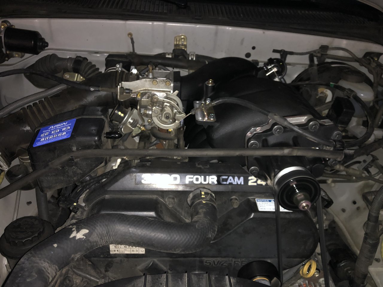

    02FE7361-BDC3-437D-95D9-34F59F8B86E7.jpg Here’s a photo taken now.

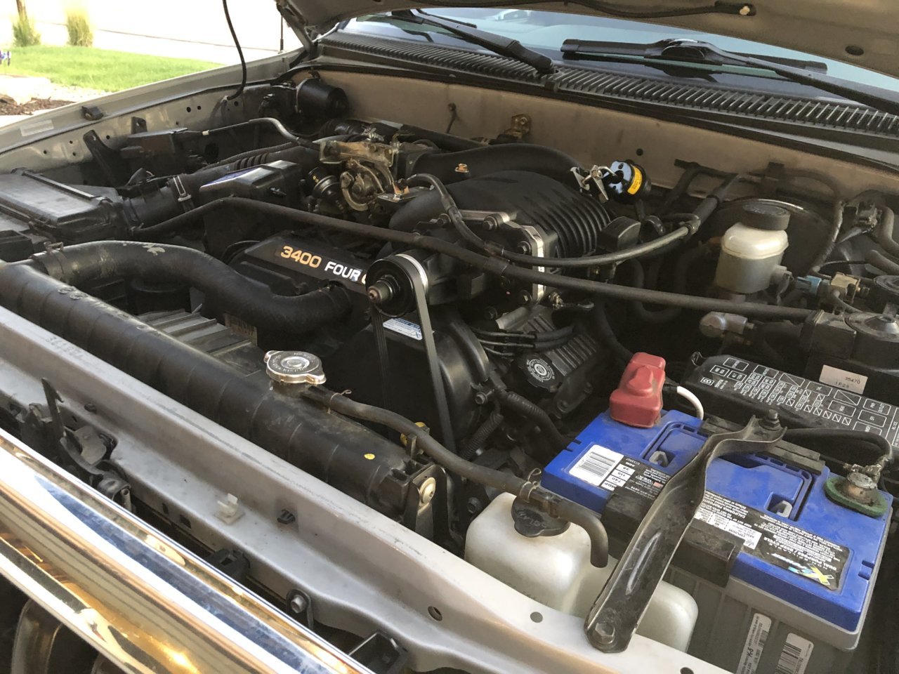

    1B7B6A60-3552-4EF2-A829-A5A748BC8230.jpg Another photo this morning.
