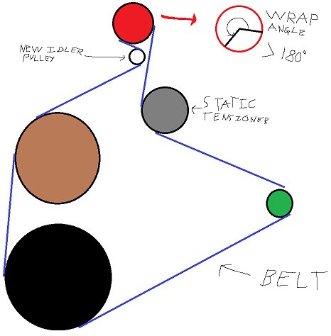

    Would it not promote longer belt life at least? less tension on the belt would be less hurtful to the belt, or would it not matter seeing as it is doing the same amount of work?
    What do you mean you can't go over 180*??? you can easily get over 210* around the pulley ex:
    the belt is wrapped around the pulley for greater than 180* of the pulley.

    Sorry the normal force maxes out there at 180* so you can't go beyond that for normal force.

    Ok, normal force is at the most we can get, but would it decrease the pull downward pull on the snout and become more efficient?

    Giving it some thought, the most friction you will be able to achieve is at 180* since the normal force won't increase and therefore friction won't increase after 180*. I think after 180* you'd be working against yourself.

    I think you would be working against yourself, just not in the way that is bad for force. I think it would counter some of the force that is making a torque downward, just countering as many degrees over 180 as you have? So all of the torque exerted(not to rotate the pulley, but to pull it down) that has belt exactly opposite would be counteracted?
    At this point, I'm going to do this for looks and to be able to change the spring rate for my pulley. Also all I've found online is that more pulley wrap is a cure for belt slippage. Who knows if that is 100% true.

    In order to make a belt “stick” to the pulley more than 180* around it I think you’d have to do something impossible.

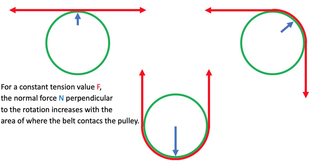

    It's possible because the pulley has a diameter, else yes if the pulley was a point in space, the belt would interfere with itself. 360* is impossible and 270* is likely near the absolute end of what is possible with pulleys that aren't .5" in diameter.

    At 270* the belt would be exiting at the angle perpendicular to where it’s entering.

    Yes, you would need a pulley a little bit smaller than the radius of the supercharger pulley to pull it off, it would be spinning exceedingly fast, around 30k rpm.
    Diagram I made to show that >180* is possible:
