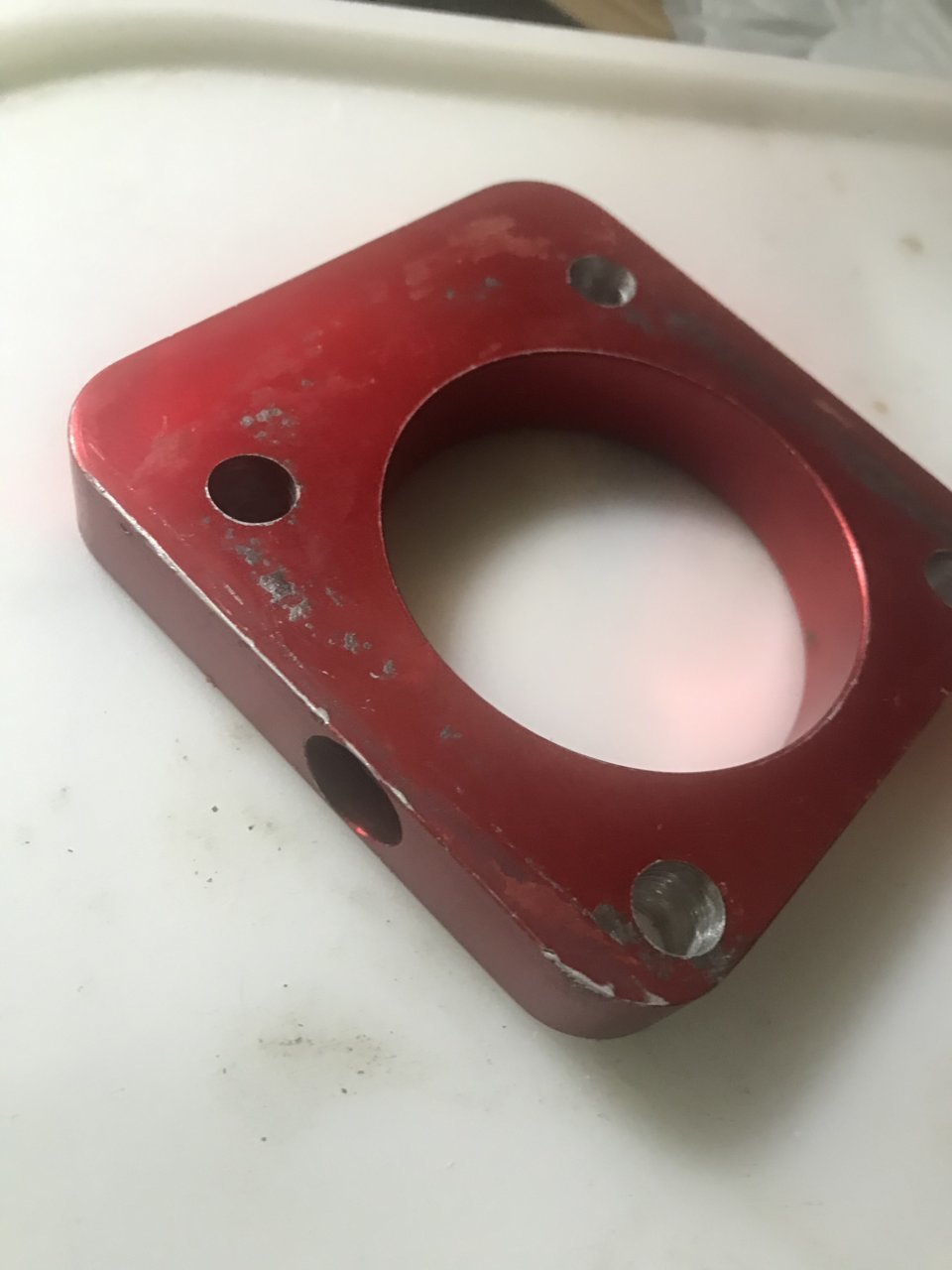

    The used supercharger I bought came with one of these. It’s not exactly like the one shown in your post but it’s similar.

    That’s either the URD one or a custom made one. The one above is for a different application.

    What other application would something be injected via a hole in a spacer?

    Maybe I wasn’t clear. I was referring to that water/methanol injection plate being made for a LS or something else.

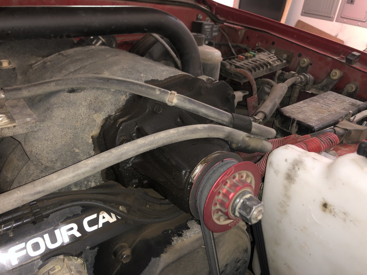

    Hey guys, looking for a little help here.
    I'm having an issue keeping oil in my supercharger. I've gone in and re-sealed the nose cone two different times, and replaced the front seal once, but I'm still constantly leaking oil. My mating surfaces were cleaned and scratch free both times I sealed it up, and a good amount of sealant was used.
    Any idea why I'm having issues with this or anything I might be overlooking?

    Ah, makes sense!

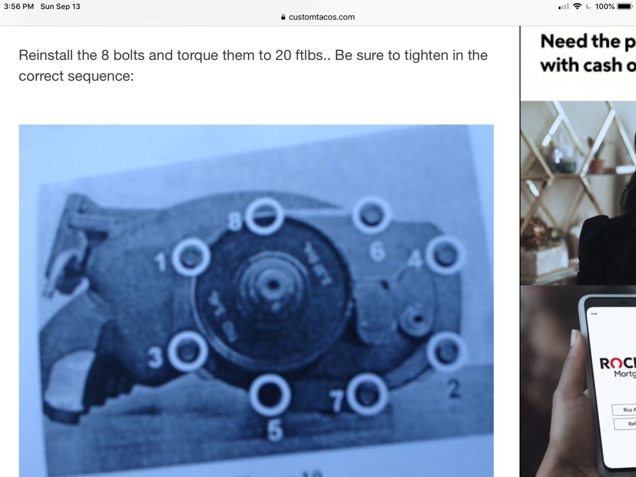

    Is it leaking from the front nose seal too?
    Use carb cleaner to remove ALL oil on seams,
    You can use ultra grey gasket maker
    HAS TO DRY 24 hours!
    Torque to 20 pounds in this order.

    I appreciate the info.
    I believe it's just leaking from the two flanges that mate up. My nose cone seal is brand new so it shouldn't be leaking.
    I'll go ahead and give ultra grey a try and torque in the order shown.
    Should I use ultra grey on the rotor casing mating surface to rotor assembly surface, as well as the nose cone mating surface to rotor assembly surface? I know the rotor casing to rotor assembly surface is only seeing air, but sealing it should prevent boost leaks.

    Ultra grey is the best stuff to use and most forgiving,
    Yes,
    Use super fine sandpaper to clean the seams and a razor for any old parts of gasket.
    Or I always use my dremel with a wire wheel

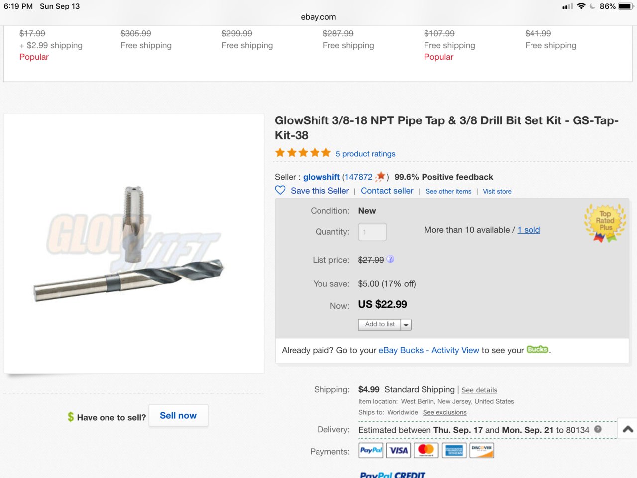

    The sensors are pretty dam big that they use, maybe a different size ,ok,
    You can cross reference the bit and tap size above and thread pitch
