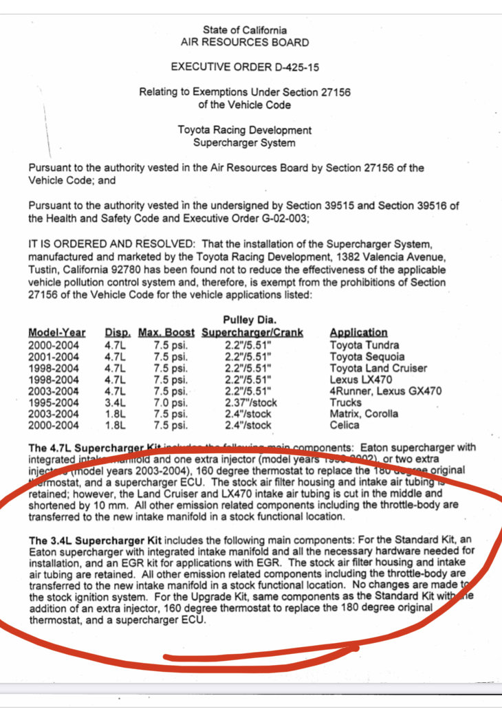

    I searched the carb executive order D-425-15 and it looks good.
    Also, there's a line in the executive order that sounds a lot like the 7th injector kit.

    Yeah that's probably to include the TRD 7th injector kit (not to be confused with URD).. TRD offered a 7th injector kit for a little while way back when. They are rare to see nowadays
    The URD 7th kit isn't CARB approved though...but I've had mine on for 2 smog tests now and they didn't say anything about it.

    There are multiple of these that are applicable to our trucks. I wrote all of them down and what is different for each. 2.215" pulley can be legal for our trucks and a different fuel regulator as well.
